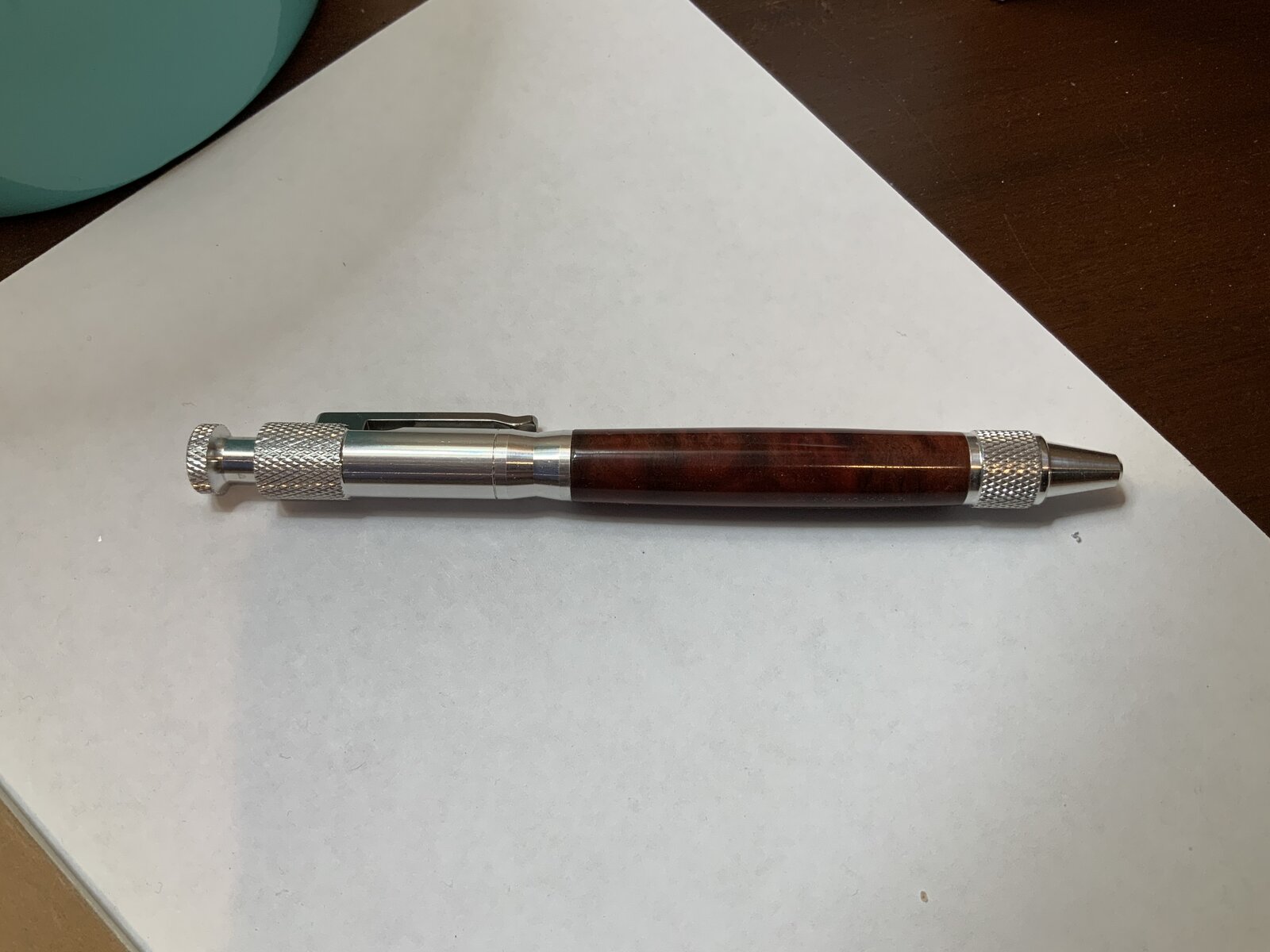

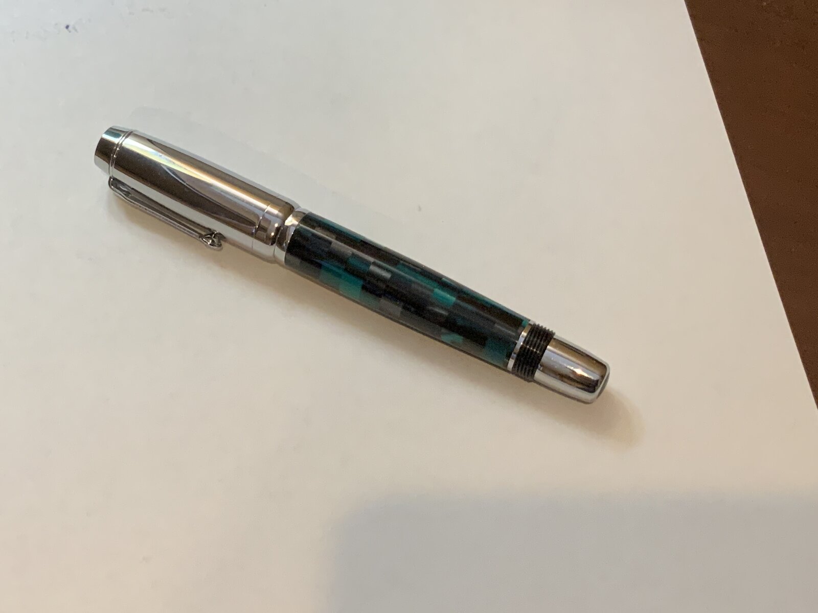

Hello to all. I work at a woodworking store in the Portland Oregon area. Lots of my coworkers are woodturners, and I finally caught the bug. I got a Rikon midi lathe and started out making small projects. My first pens were a bit lacking, with gaps in the joints between the blanks and the fittings. After more than a year hiatus I started making pens again and this time I have figured out how to keep everything trued up. I have also been experimenting with different finishes and materials, and trying to master the various lathe tools. My goals are to make the pens ergonomic but still pleasing to the eye. I have always been interested in fountain pens and would probably be a collector if I had deeper pockets. Bespoke fountain pen turning sounds like a natural direction for me, but requires an additional investment in equipment and some of the taps and dies seem to be hard to source. I also have to decide what to do with all the pens I might turn out. You can only use or give away so many, eventually I would need to sell them. Craft fairs are appealing, but they are shut down for now. I have heard bad things about ETSY, but how do you get traffic at you website if you decide to go it alone? I think these are questions all penmakers have and I am hoping to find some ideas in the forums. I also have some ideas to share about blank preparation. I have come up with some procedures that are a bit different from the usual methods that might be helpful to other novice turners. Looking forward to jumping in here!

Thanks for showing the above pens .... they look GREAT !!! . BTW, what kit is the first pen ?
The first pen is an Arete fountain pen. I got the kit at Woodcraft, and selected it because it seemed to be of better quality than the other fountain pen kits. The metal fittings have some real weight to them and fit and finish is good. I don't know the maker of the nib, it is shrouded and the catalog description doesn't say anything. It is of decent quality, and I would say the width of the nib is fine.
