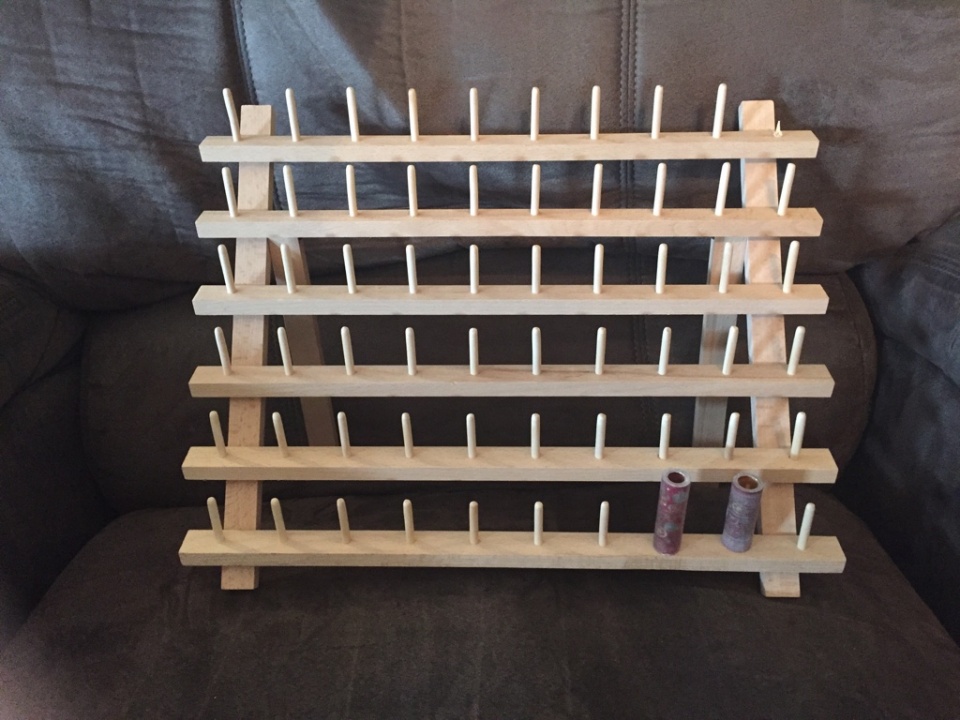

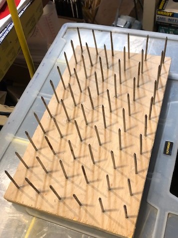

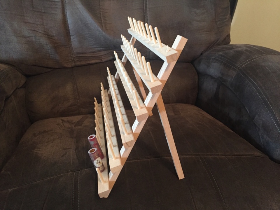

I use this for an organizer when I'm making longer production runs. It is a 6" X 10" board with 2 1/2" finishing nails going through the wood on one inch squares. I have two of this size that hold 60 pen sections each and two that are 8" X 12" that hold 96 pens sections each.
