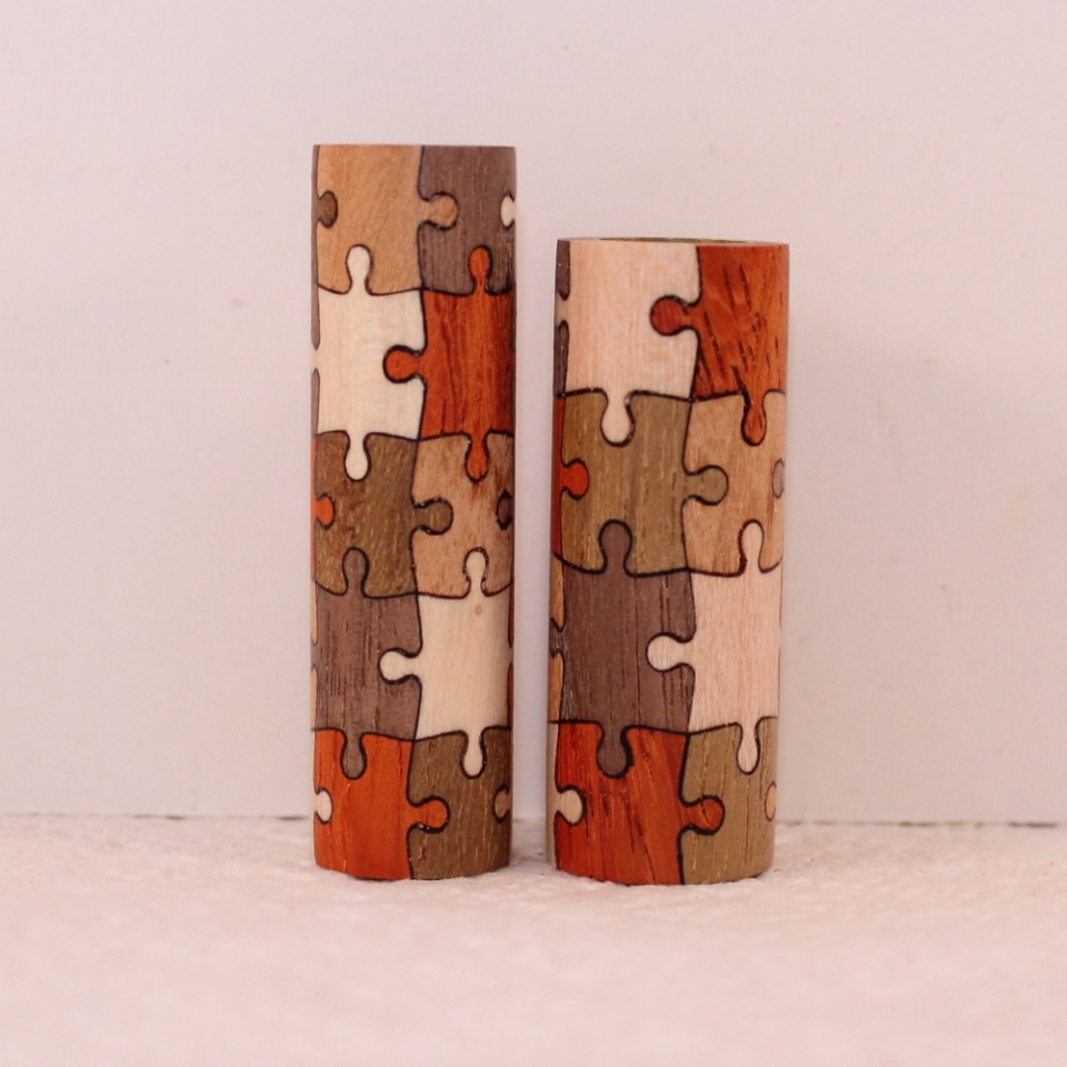

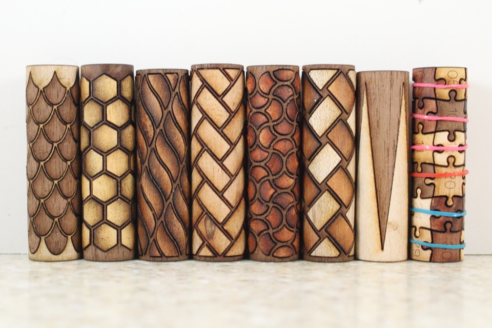

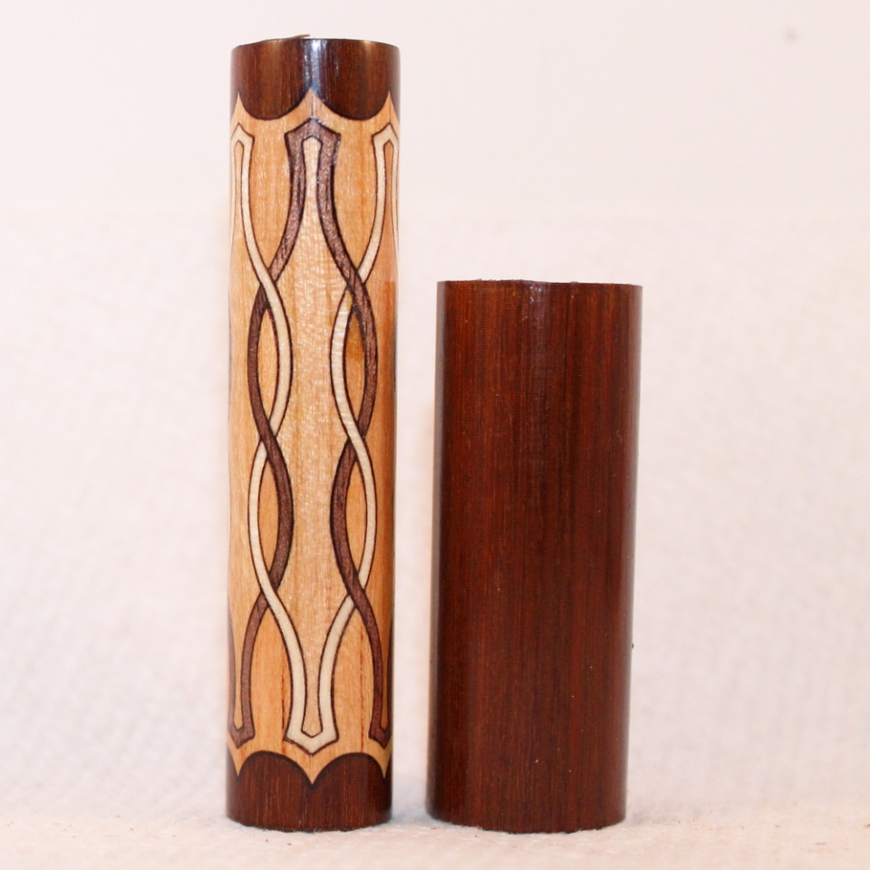

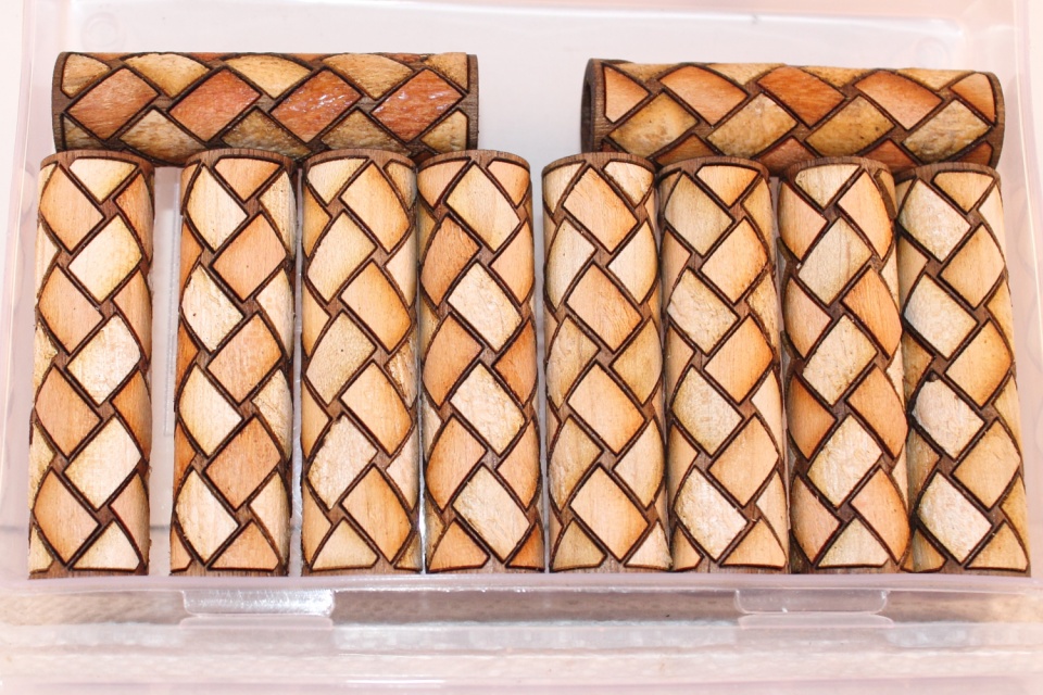

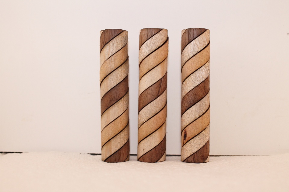

I see blank inlays for sell everywhere but I can't find anything about making them. I assume it requires a laser engraver.
Do the $100 - $200 chinese laser engravers have the power to cut the wood blanks or do they only have the power to engrave?
If the Chinese engravers are not powerful enough, what is the entry level for cutting own inlay blanks?
I have looked online and these things go into the stratosphere on cost. Is it realistic to make own pen blank inlays?
I apologize if this has been answered. I have searched and not really found anything about creating own pen blank inlays. I keep finding pen blank inlays for sell.
Jason, you're probably not going to find a lot of information online on this topic. I know this because I have tried. I'm one of the proverbial "new kids on the block" in laser inlay and segmenting. I'm a Guest Artist that makes laser processed blanks for Signature Pen Supply. This past weekend I did a tutorial on Laser Inlay at the Mid Ohio Valley Pen Turners Gathering in Belpre, Ohio. My intent was to demystify the process for those who were interested. The topics I covered were Blank Preparation, Seamless Patterns, Laser Kerf Compensation, Helical Segmentation (spirals), Ring Segmentation, Puzzle Pens and whatever else I could fit into the 45 minutes that they allocated for me. Steve Kondo, a friend mine from Florida, along with others will be hosting the Southeast Pen Gathering in Augusta, GA in May 2018. He asked me to do the same demo for that gathering. First let me say, I'm not expert on this topic nor do I think that anyone else is. Here is the equipment I use to make the blanks pictured above. 1. 60 watt Epilog Helix 2. A mandrel based rotary for the Helix that I built specifically for pen work. 3. A 1940 something SouthBend Metal Lathe to make my consistently sized pen blanks. Let's talk about the blanks first. I turn all the blanks between centers on the metal lathe so that the wall thickness is approximately 1/8". I use drill sized bushings that I make to do the turning. If you viewed Chris's video you will see that is one of the first steps in the process. Now, lets talk about the laser. Do you really need 60 watts to cut 1/8" thick wood? No. I usually cut most blanks at 30% power (18 watts on a 60 watt machine) and vary the cutting speed between 15% and 30%. This will work for most of the dosmestic wood that I use. When you get into exotics you have to zone it on what power and speed you need to reliably cut the wood in a single pass. The denser and harder the wood the more power and less speed. Next to the rotary. Epilog doesn't make a chuck style rotary for the Helix/Mini/Legend series. They do make one for the Fusion series at the tune of $2800 for the rotary and the Fusion would cost probably another $30,000. The surface driven rotary that they supply should work ok for engraving glasses and Yettis. Surface driven meaning that the object be engraved sets on 2 wheels that are equally spaced off the centerline of the laser and the object rides on them in the gap between them. As the wheels turn it drives{rotates) the surface of the engraved object. This type of rotary is utterly useless, IMO, for doing precise indexing. I searched the internet far and wide to try to get the numbers of how many inches where represented by one rotation of the stepper motor on the stock rotary. I bought a used surface driven rotary from my Epilog Distributor and took the time to figure it out. Knowing that "magical number" I can now manipulate timing pulley ratios between the motor and spindle and get about any circumference that I want. (I cut my own timing pulleys out of acrylic with the laser). Right now I have the circumferences set at 2", which seems to work well for most pens. If I scale artwork (either lines to cut or a photo to engrave) to 2" I get a seamless 360 degree wraparound every time. So ... the third requirement to do this type of work would be an accurate rotary device that you can set an exact circumference. I hope this answers at least some of your question. If you will check out my Facebook page (Kenneth Wines) I have posted some videos there of laser cutting pen blanks.
