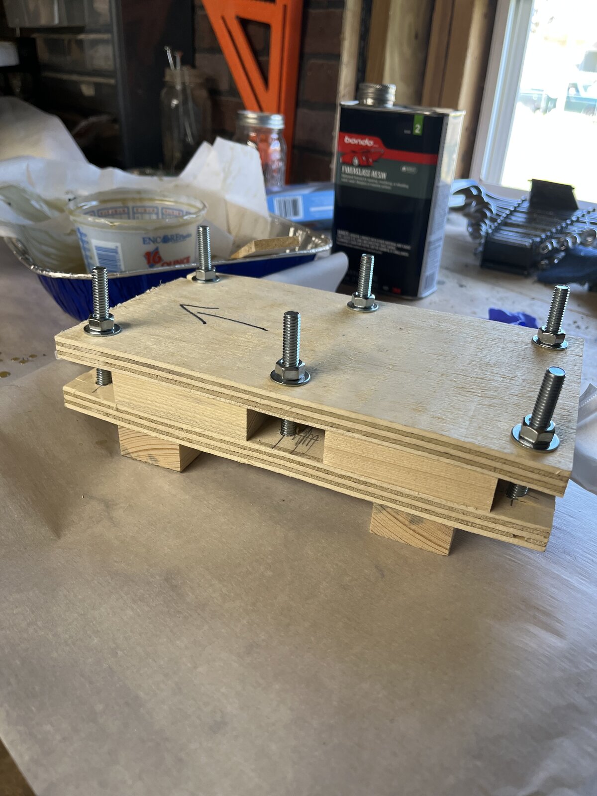

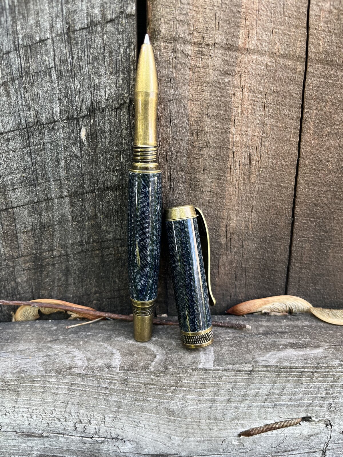

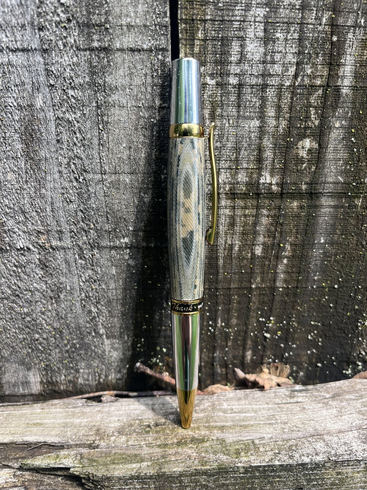

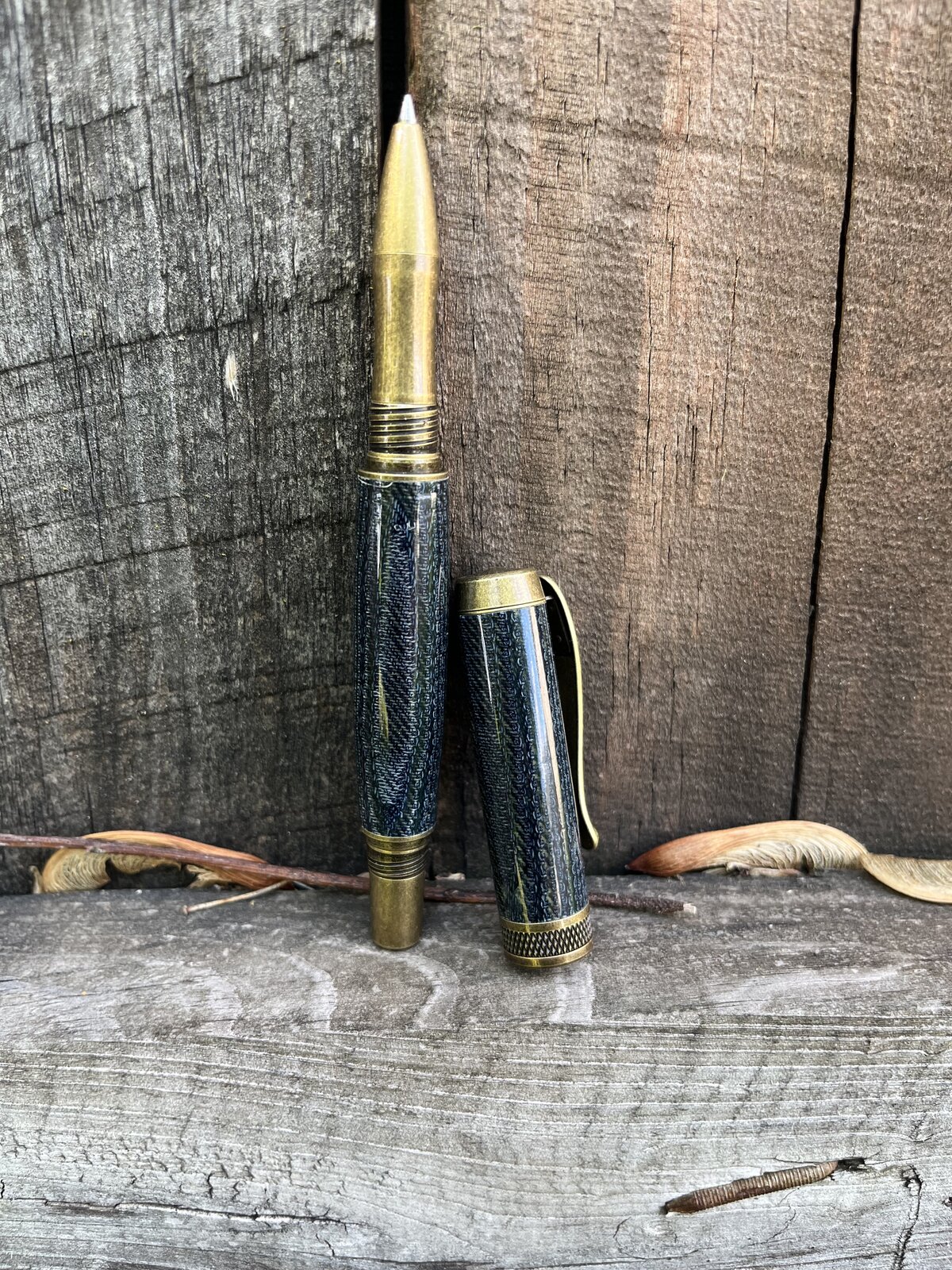

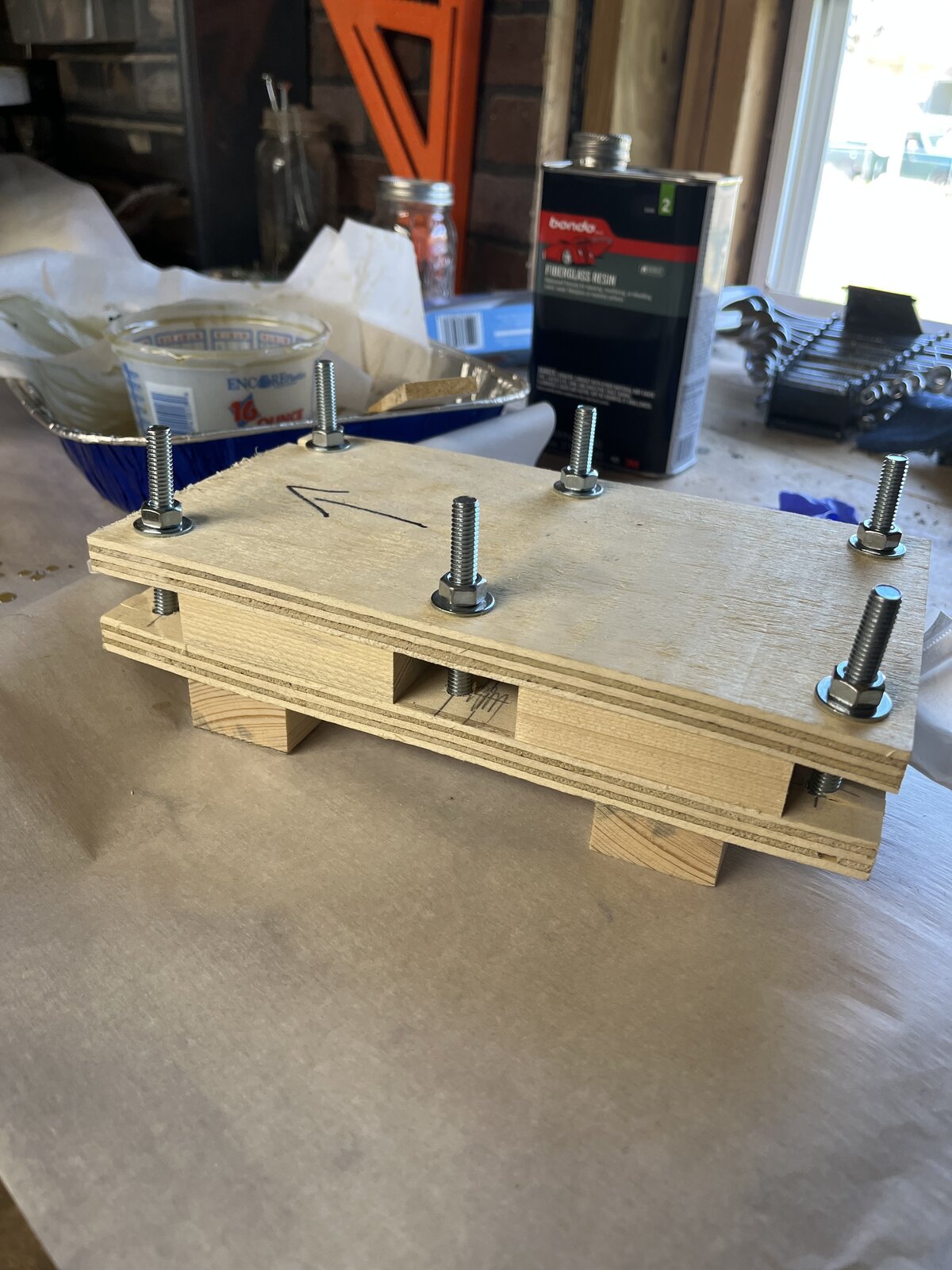

I use Bondo fiberglass resin with very good results. It's a messy process but well worth it. Open time is around 15 minutes. I cut 2"x6" strips of material. After soaking them in resin they go into a press that I made. The press is slightly bigger than the 2x6 strips and has 3/4 spacers to get an even thickness when the bolts are tightened down

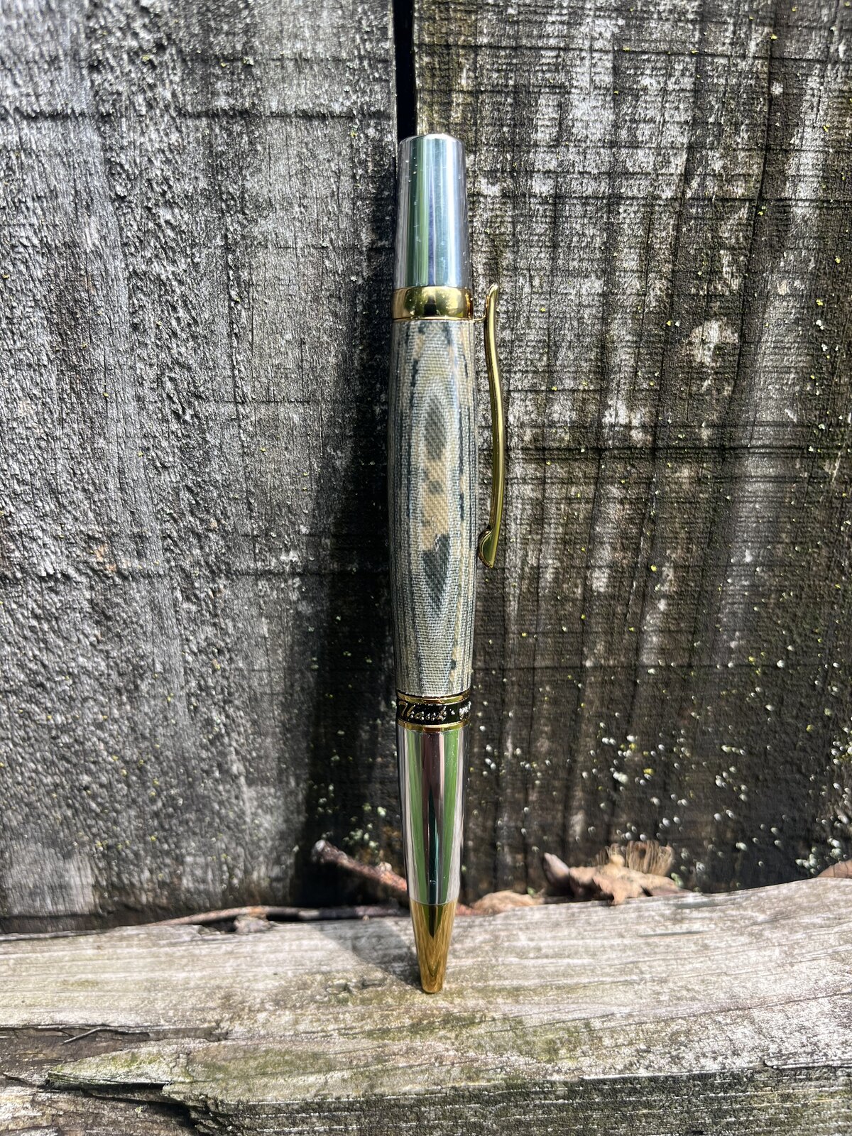

Here's a couple blanks I made, denim and Air Force camo
Yep exactly like i said. Plus that is what they make that fiberglass stuff for kind of. It is slightly yellow but you really can't tell.

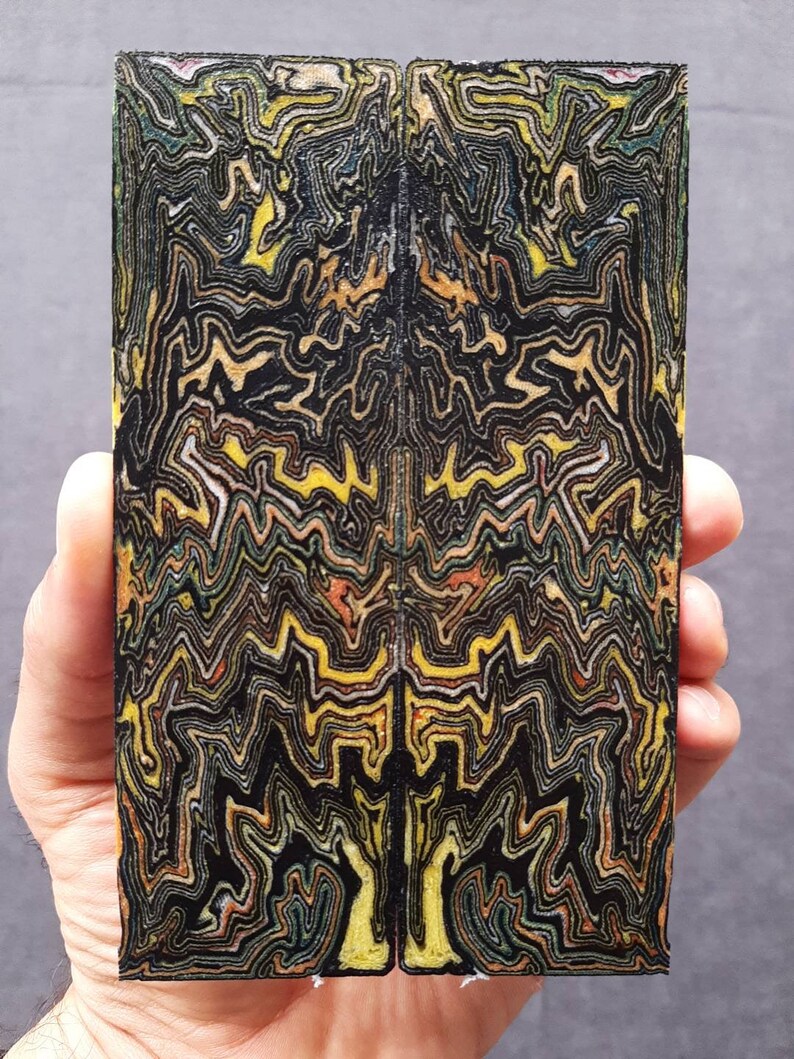

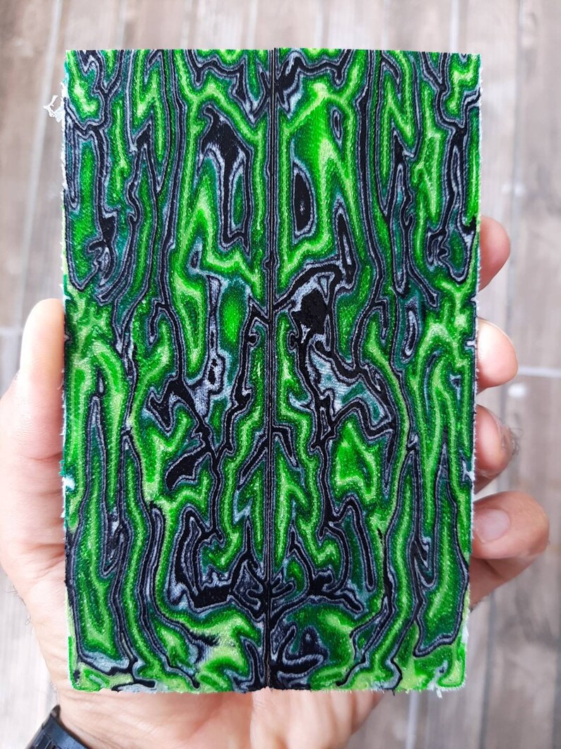

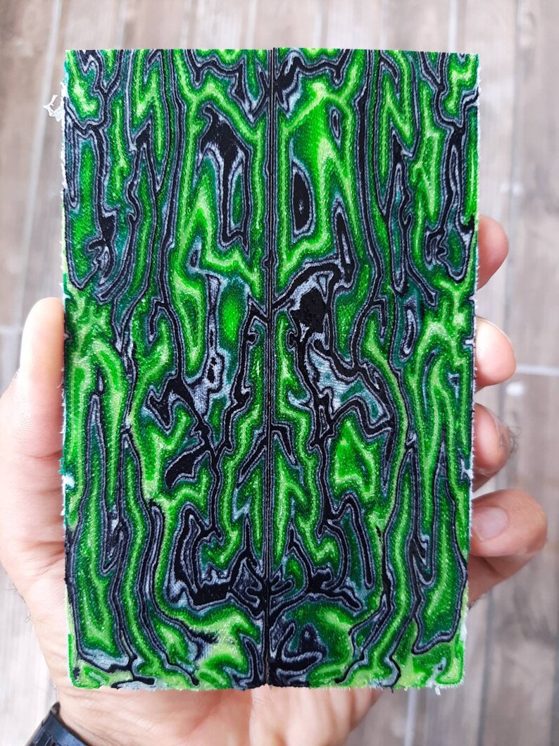

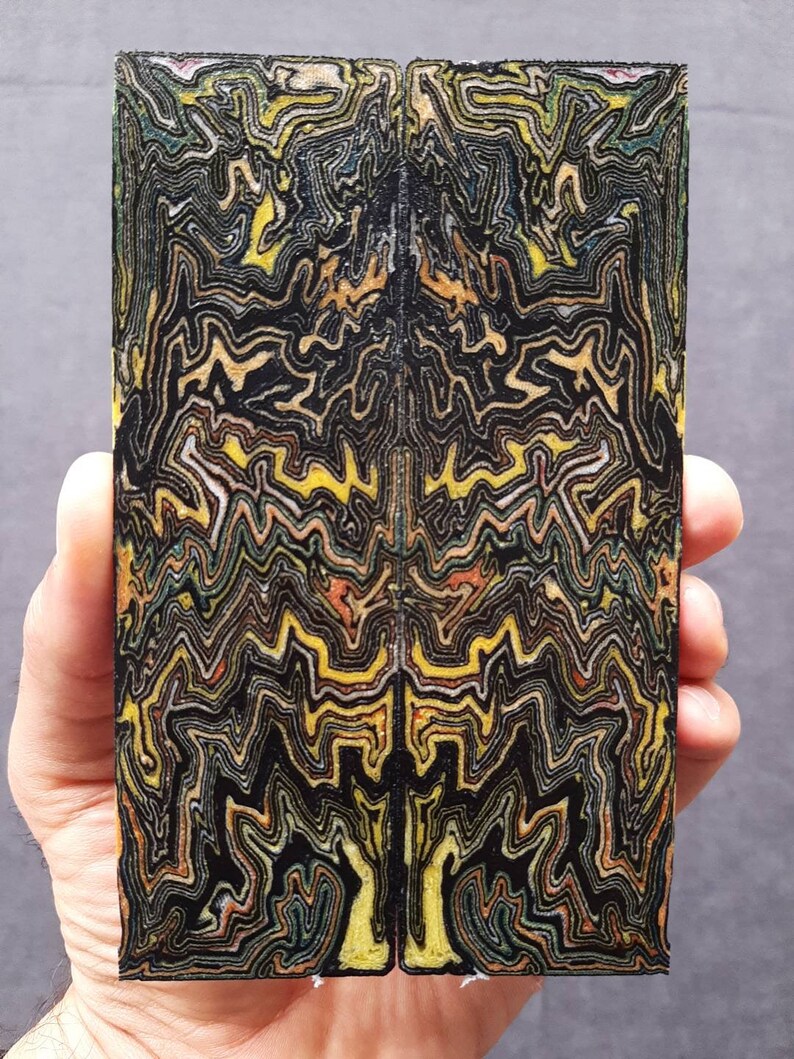

But this is where I am looking to go with Micarta. This guy is in Turkey so shipping costs push it over a reasonable price for me. Yes, I am going to be making Knife Scales.
