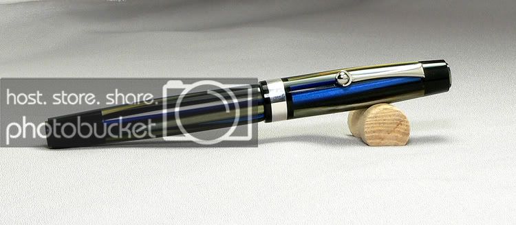

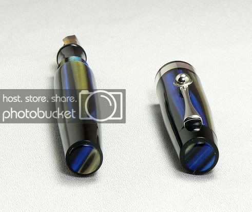

I'm going to post a couple of pics to make the following directions clearer, sorry that I don't have step by step photos.

Now you have all the components on the same "blank". Flip this again in the chuck, so that the finial is facing out. Mount a small center drill in the Jacobs chuck in the tailstock, and drill a shallow 60 degree cone indentation for the live center. Now drill or turn a recess about 1/16" deep into the top of the finial. This will be filled with a "jewel" to cover it up later. Size the recess so that when finished, you will have about 1/16" of finial showing around the jewel.
Now take the cap/finial/band our of the collet chuck, and mount it between centers. I don't recall whether I made a center drilled threaded plug to screw into the cap threads, or just mounted the open end of the cap on the dead center. I know I made a plug for the barrel, as it was thinner where the section threads on. Anyway, I just turn to final dimensions between centers, with band and finial already mounted, so I can do it all in one go, and don't have to try to line things up in a collet in stages. Last steps are to turn a jewel to cover up the hole in the finial, and cut the slot for the clip to stick out of. I've done the slot with a file, or a Dremel cut off tool, but that's a little dicey, one slip and have to make a new cap. :eek:
I hope that all makes sense. It's a little more rigamarole to go through, but the advantage is being able to turn between centers, and not having to worry about alignment in a collet or mandrel. I do the barrels the same way, except the barrel finial is just glued in, not tapped.
