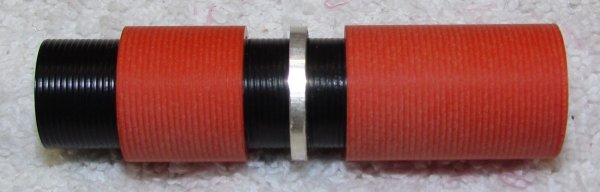

It is rare for many pen makers let alone pen company to share their secrets but I got a hint from one company and it was one word..... "Sleeves", so off I went.
This photo show my earliest attempt at sleeving and the idea is simple, you make an inner (black) and outer (orange) sleeve and bond them together sandwiching the metal ring in-between. The trick is to make the inner sleeve wider than the threads you are going to cut into the cap. I quickly realized that I didn't need to make the entire cap sleeved, just a portion where the bands were going to be so this phase never left the mockup stage.

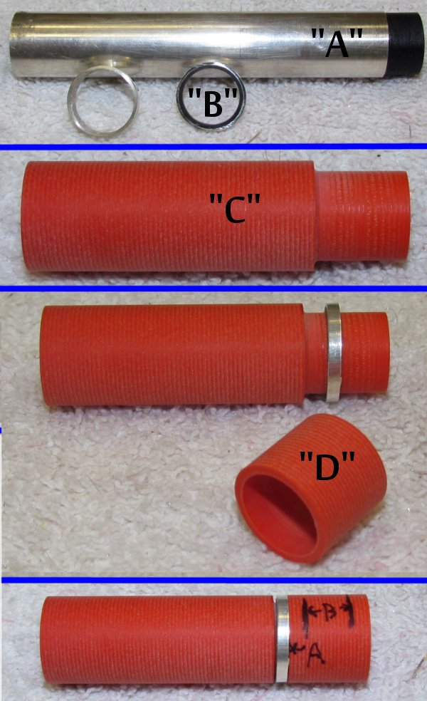

Now fast forward through several trials to my current method. It all starts with the silver tube ("A" in the photo), available at many jewelry supply houses. I use .625" diameter tube but with a wall thickness of only .020" I needed it to be thicker so I turned an alumilite rod to fit inside the silver tube and epoxied it in place. Then I drilled out the center and sliced the tube into thin slices ("B" in the photo) to become accent bands.
I cut the cap ("C" in the photo) to length and diameter then turn a tenon at the lower end for the bands to slide onto. Remember, this diameter must allow room inside the cap for the main body threads.
Notice the silver ring sliding over the tenon, make sure it's a snug fit so the ring has just enough room for a good glue bond and I do not recommend using CA for this else you will wind up with a lot of glue bonding before you're ready!
From an end cutoff, I turn the piece ("D" in the photo) the same outer diameter and inner diameter as the silver band. Looking at the photo you can see that by cutting the orange piece into thin bands you can create a spacer to go between two silver bands as well as an end piece. Once all the pieces have been cut, sanded and dry fitted, I use epoxy to glue everything together and clamp the assembly tight while curing. Set the assembly aside for 24 hours and don't get in a hurry to turn the cap smooth or you'll realize that turning silver generates heat quickly and heat makes uncured epoxy slip and things spin, not that I would know first hand of course! :biggrin:

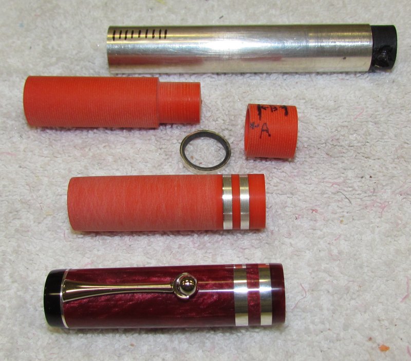

This photo shows all the pieces in order of how they all come together with a finished cap at the bottom. I use a cheap Harbor Freight mini-saw to cut the tubing and the body spacers are parted off on the lathe. On some pens I add a silver washer at the top between the finial and the cap because I think it adds a little to the look. Let your imagination be your guide, use one, two or more bands, and vary their widths if you like.

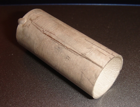

I gave up on them long ago and started turning them in wax and having them cast in silver. Opens up the the range of diameters and thicknesses. This one is .60 diameter and .020 thickness. A little rough right out of the caster but with a little sanding polishes right up. A reasonably easy process and maybe even less expensive.

You don't need any silver working tools. All you will be doing is making a wax tube and sending it out for casting. You get back something that looks like the picture I posted.
I get my tubes cast in sterling, not fine silver unless I want to use transparent enamel, but that's another topic. You could send in your sterling scrap and they can combine that with casing grain up to about 50% usually. You will only get charged for what they use of their supply.
