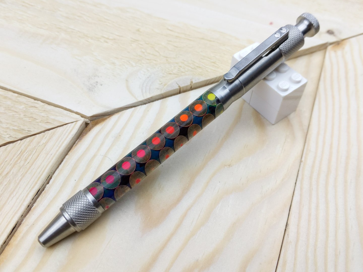

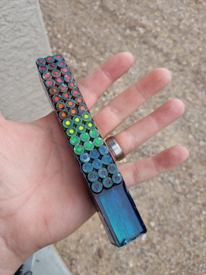

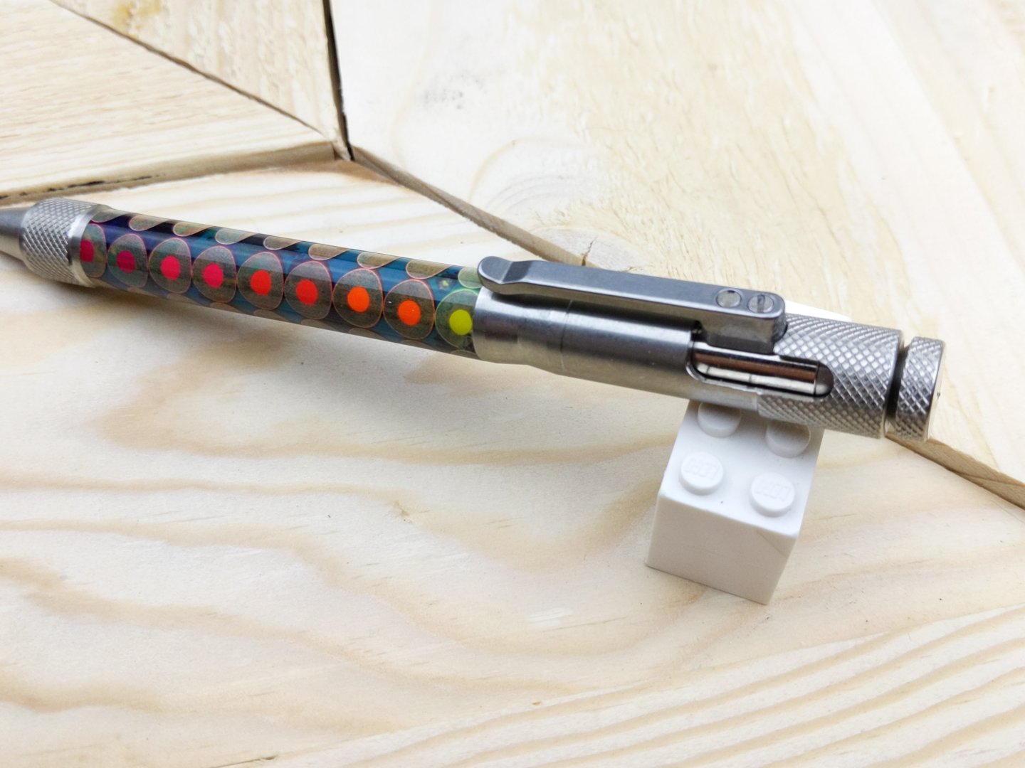

Bought the pencils at the dollar store and poured some alumilite with a little bit of blue dye to make the blank.

You just need some alumilite, dye, pressure pot, and some pencils. It was honestly very easy to make.
Did you cut the strips into staves and glue and then pour the resin. You had to do something different than what others do because the sides are usually oval and not round all the way around.
Just cut sections, braced the mold so they stayed lined up. Then poured the resin. Didn't do anything special.

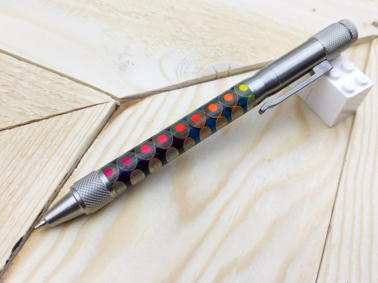

Another angle.

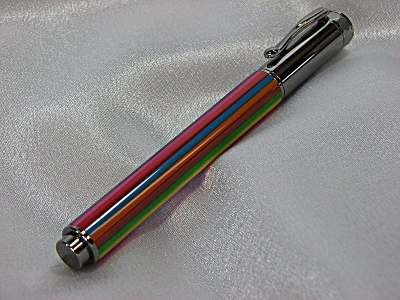

So then you say you drilled down the center of the center row of pencils and inserted tube and that is it. Either that tube is just the right size to not distort those side pencils or something else is going on. I say that because here is an example of someones pencil pen and this is what you see most of the time. Maybe the trick is 3 rows of pencils as opposed to 2.

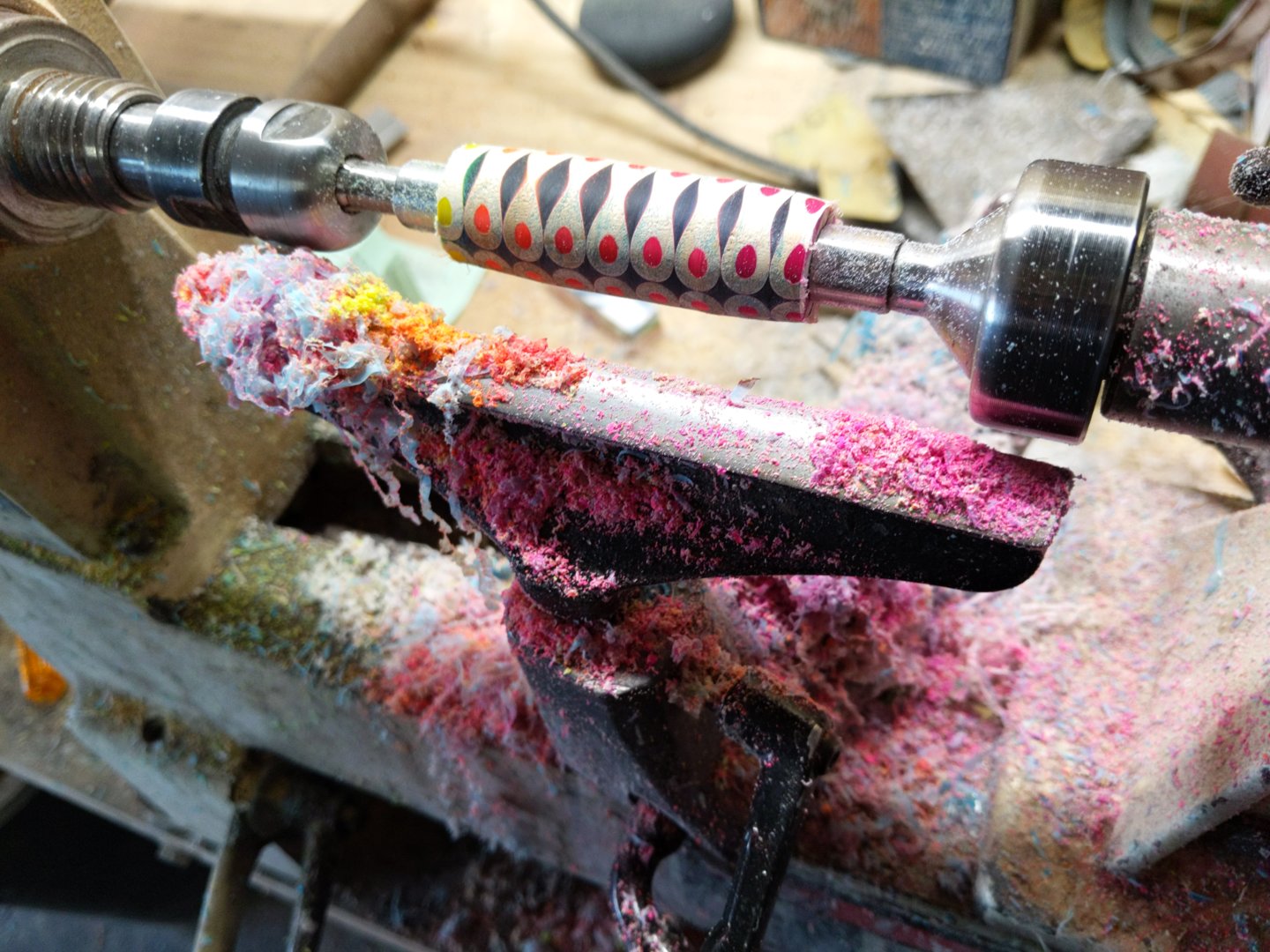

OK I have looked at this pen a few times now. Are you constantly showing us the "A" side of the pen. Being I never used this kit I am not sure how it operates. It looks like it is a slide system . The reason I am saying this I am trying to reference the clip to the row of pencils you are showing. There is no way that you get perfect rows of pencils on 4 sides. Not the way you have them layed out in the mold or at least my mind can wrap around this. I can see the top and bottom being the good sides but unless you turned the pencils on their sides that would be the only way that I see you would have a fighting chance to being close to perfect all around. But from your photo of the mold you did not do that. Could you show us the 4 sides to the pen so I can sleep at nights. Thanks. 😴😴
You are not doing anything different than anyone else then from your photo on the lathe. It is not that is a mind bender at all. I kept seeing the same photo with the clip moved and thought you figured out a way to make that one true row of pencils to be the same all the way around the tube. Do that and then you have something. That is the only reason I was asking. I like to see new things.

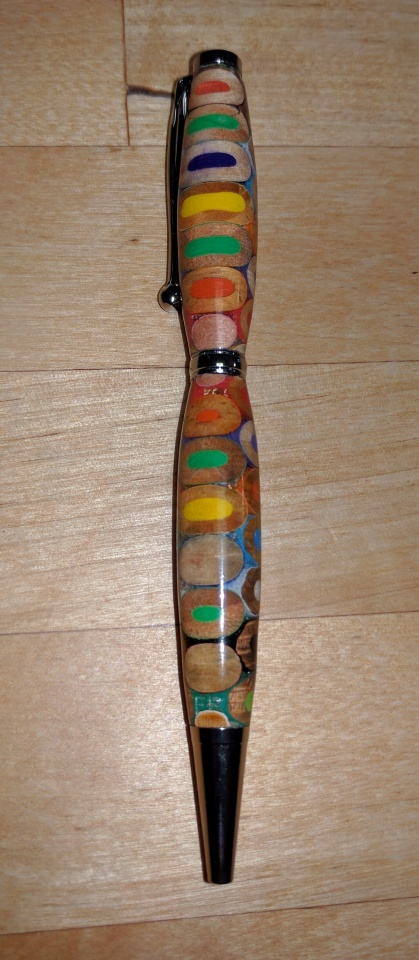

I avoided the look with the wood and here was my version of the colored pencil pen.:)

Excellent Pencil Pen Kyle.
You had a number of us scratching our Head's having seen the Photograph, you posted with the Perfectly Round Pencils, neatly Lined Up like a Platoon of Soldiers, But it all came clear with the Photograph on the Lathe, where we could see the Elongated Cut Pencils on the sides of the Blank,
Great Work,
Brian.
Me too. I kept looking at the photo and wondering whether it looked the same all the way 'round. I am glad to learn that I am not the only one. Thanks for the clarification!
