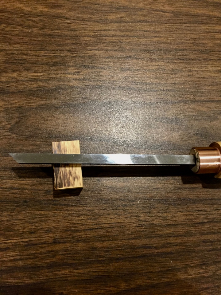

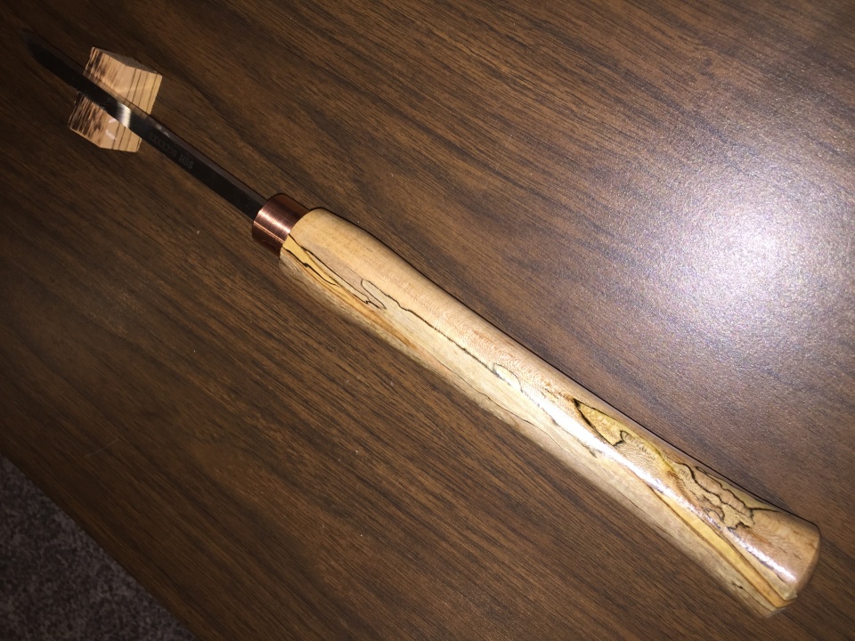

My friend David and I decided we would like to try our hand at making a Bedan tool, complete with a handle. I am pleased with the outcome.
Dave ordered three pieces of HSS; 5/16" square by 10 or 11 inches long. We turned the handles out of spaulted oak (at least that was what it was called), and made the ferrules out of 3/4" copper pipe.
I decided I would try a Bedan with a single grind at something near 45 degrees; Dave is going to experiment on some different grinds. Properly used, it cuts Walnut like butter!!
Your comments and/or suggestions are always most welcome. Total cost: Steel $5.00 each; handle $3.50; copper ferrule $.98 Total: less than $10.00.

Oops!
There were pictures when I started. I guess too much time elapsed between when I started and when I finished the post.
Sorry. I hope this works.

Very nice if it works as good as it looks then you should really enjoy it, the wood looks more like maple to me instead of oak. You can save a lot of money making your own tools and the joy of it being your creation is part of the fun also.
Sorry, Keith. It is Maple, just as you suggested. I don't know why I wrote down oak. You are exactly right. Thanks for the correction.

I have a Ricon Slow Speed Grinder with CBN wheels; I did the first cut on the 80 grit and finished it with the 360 grit. It went well.

Normally not big fan of making my own turning tools but Warren's 5/16" Bedan as good as anything you can buy today. My My 3/8" Bedan is made by Sorby and bought in late 1990's and didn't pay what they are asking for one now.
