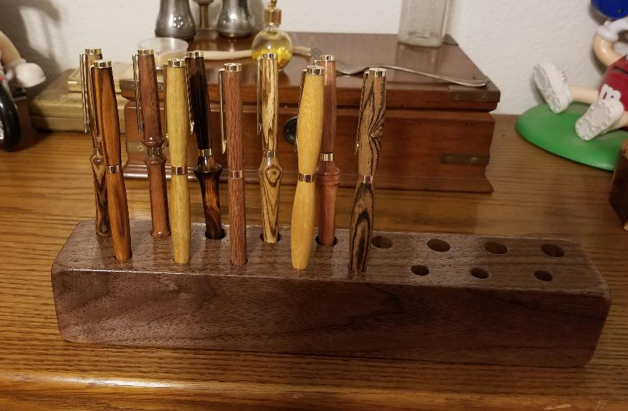

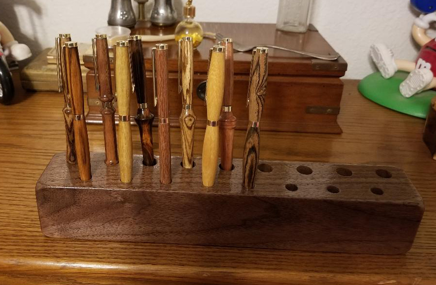

I just converted a small block of maple into a pen stand over the wknd. I used my forstner bits, 3/8" & 1/2" and seem to work fine.
