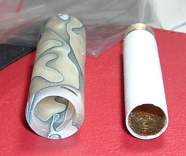

I hate trying to paint the tube and/or the inside of a plastic blank that shows through. I usually end up scraping off the paint getting the tube glued in.
So, I tried something different.
I have some leftover plastic brickmold from a project a few years ago.
I cut and rounded a short piece for this brass tube and drilled it the size of the tube. epoxied it in and I then turned it down so it is .021" thick on the outside of the brass.
The tube was .483" and is now .525" OD. The pen parts are .583" so I'll have about a .03" plus a bit more if I make the blank just a bit larger than the hardware. That's not much and I'm not sure if I'll loose all of the pattern in the blank.
Do you folks think it would be a good idea to also try to paint the inside of the blank? I'm thinking I should because there may be voids in the glue that will show. I'll post the results, good or bad.

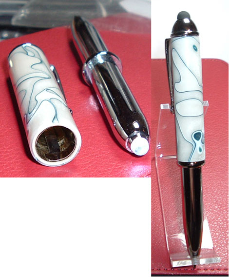

Chris, I looked it over with the brass tube in there but did not like the look.
This is what it looks like. I did like John said and sanded the inside of the blank but I did not paint the inside. I mixed some white latex paint with the 5-min epoxy and let it cure all day. I got it down to the .583 OD without loosing the detail in the blank. It has a lot of phosphorescence in the plastic and really looks better than this photo. It is thin but seems like it will hold up well. I also do not see any voids in the glue. I think I'll carry this one with me, just in case I need a small flashlight!:biggrin:
