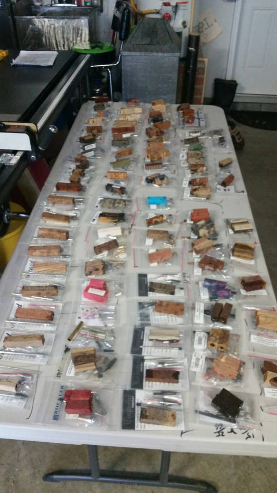

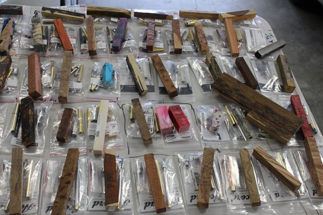

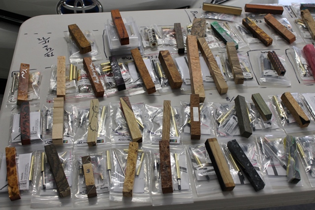

Time to get ready for some upcoming shows and top up my pen inventory.
Here are 90 pens I have spent the day organizing and getting ready to start cutting. I have also included the excel spreadsheet I built for planning out and keeping track.
Wish me luck!

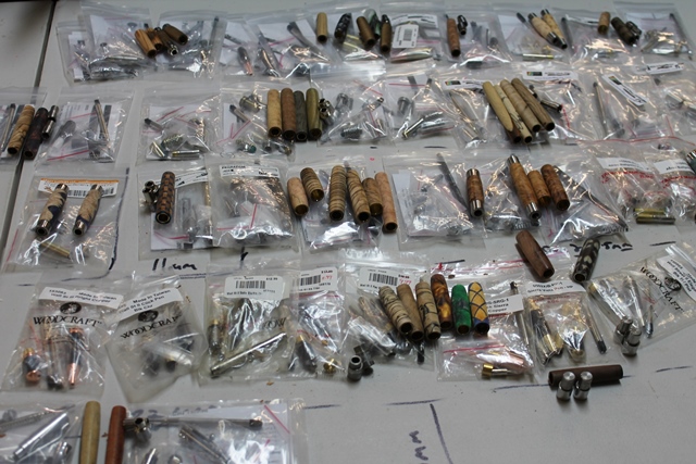

You seem to be incredibly well organized !!! Good for you !

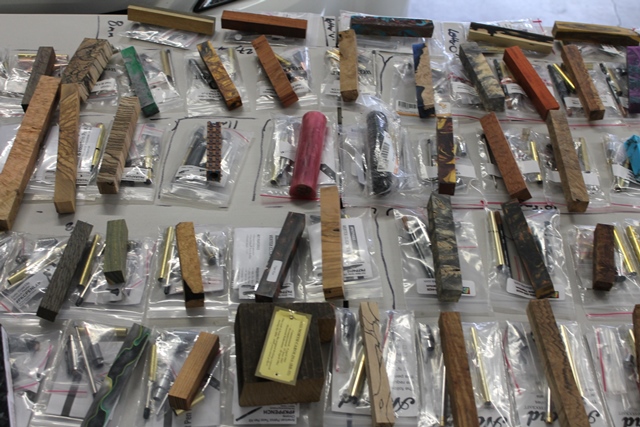

Third pic, bottom row ... all the pen kits seem to be in the same packaging. I can't read the name on the packaging partly because it is upside down and partly because it is obscured by blanks and other stuff. Looks like "Accord". Can you please tell me what it is , please .
Charlie_W
Nov 16, 2011
5,918
Sterling, VA USA
Accord pen kit is available from Woodcraft!
They are Accord from Woodcraft. $20 a kit but fantastic qualify.

My process is that I cut them all-takes a day.
Tube them all and then shave them all close to the tube-takes a day.
Mill the edges with a pen mill and then drip a little thin CA onto the tips, around the tubes, and wipe off any excess.
After all that, they're ready to turn.
I'll pick about 10 to 15 each weekend and turn them all on one day and then CA them the same day. Leave them overnight to cure and then sand the tips to get off the CA overlap and square the blanks one last time (I use a Jet 9" cabinet sander for that) I then dip the tips in thin CA to seal them before I polish them and then assemble them.
That's my system. A little nutty in places, but it works for me and I don't have any problems with blistering, cloudiness, spotting or cracking of the finish.

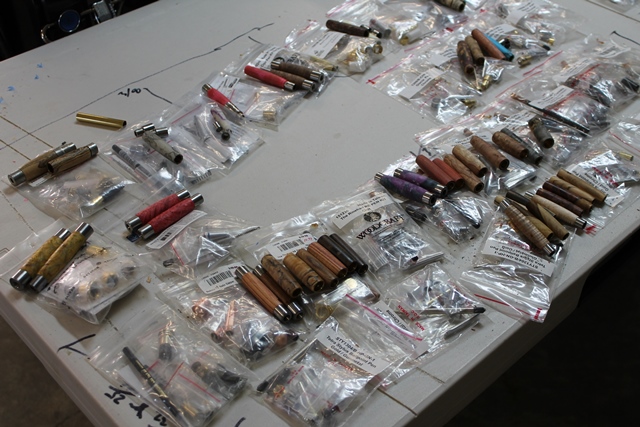

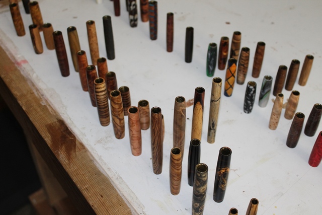

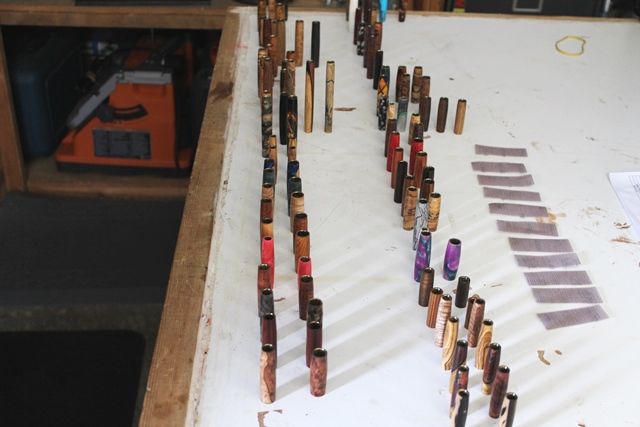

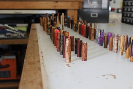

Here they are: Marked out, Cut, Drilled, Tubed, pen milled, reemed and tips dipped in thin CA. By the time I was finished, it took me an hour to get them all back on the right kits.
Now, my plan is to take 15 at a time, each weekend, to the lathe and turn, sand, CA and assemble.
I should be done late April. Then I'll be all ready for the shows and on to another project; probably a coffee table! :eek:

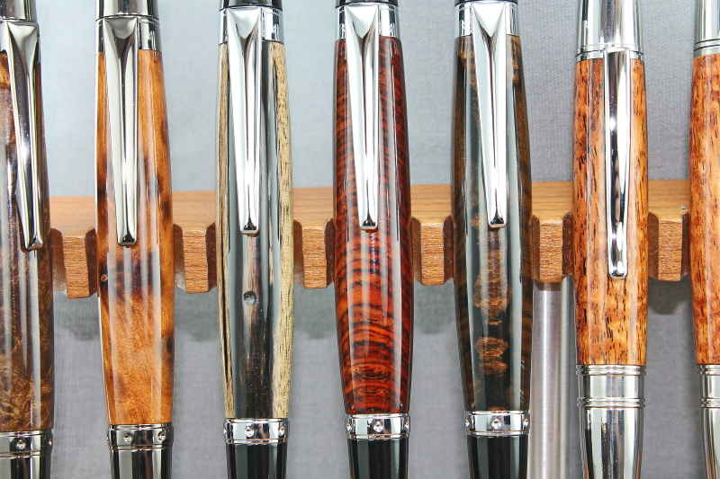

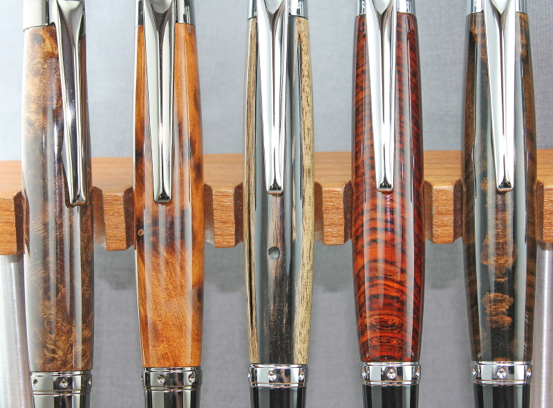

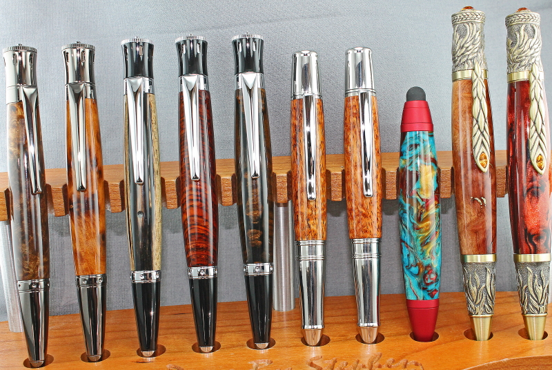

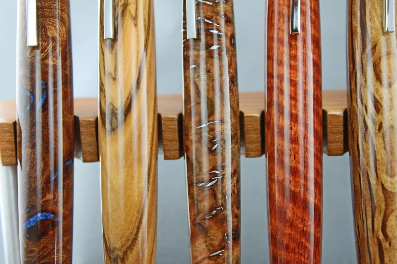

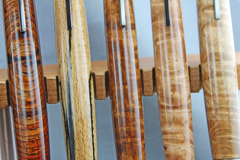

First 20 pens
Firrst 10 of the 20...Left to right: English Wych Elm burl with Blue Lapis stone inlay, Jerusalem Olive Wood, Chechen burl with steel powder inlay throughout, English Holly Oak, Crosscut Cocobolo, black line spalted English beech, Curly Afromosia, American Big Leaf Maple burl and curly two-tone Maple.
All are on Accord pen kit with CA finish.

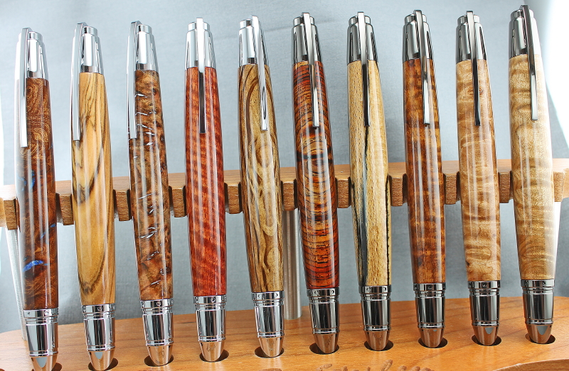

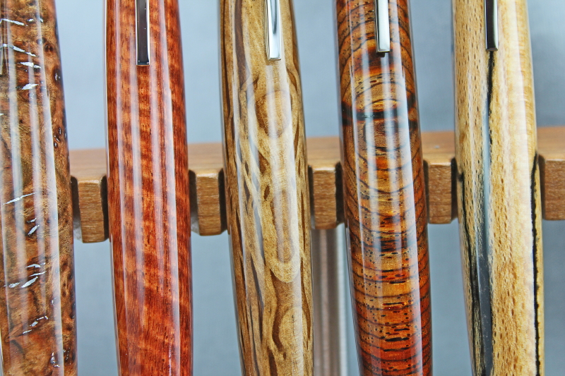

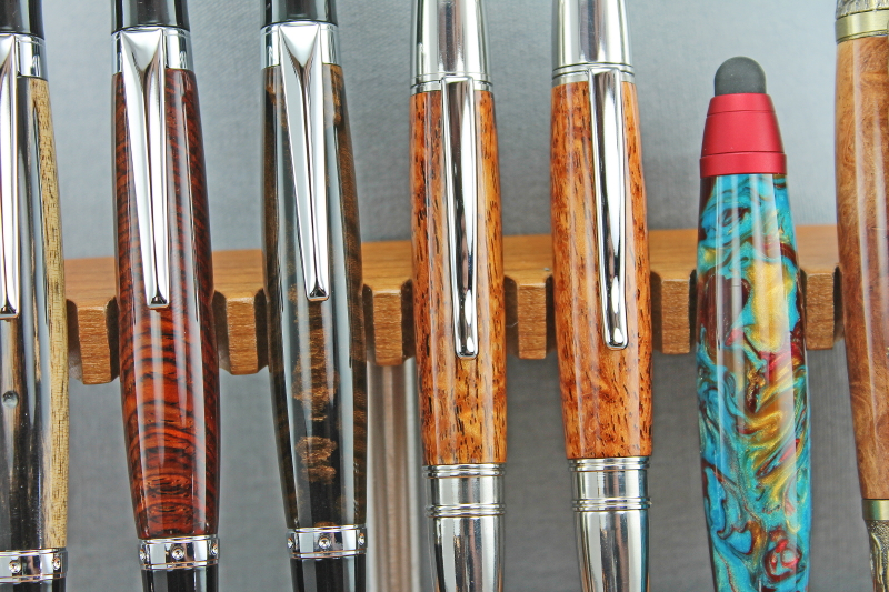

Here are other 10
Second 10 of the 20...From left to right: Curacao burl, Thuya burl, Black & White Ebony (I was toying with whether or not to fill the hole in the middle but decided to leave it alone and place on the center of the pen), Crosscut Cocobolo, Cloud Figured Ziricote, Afzelia Xylay pair from the same block, Shakespeare acrylic, two-tone Red Mallee burl with brass inlay and After the Fire acrylic.
First five are Emperor kits from Woodcraft, middle two are Liberty kits, then a Inertia kit and the last two are Phoenix rising.
All are CA finish, except acrylics of course.

Those look beautiful !! Thank you so much, Stephen, for posting pictures and for the kit and blank details !!

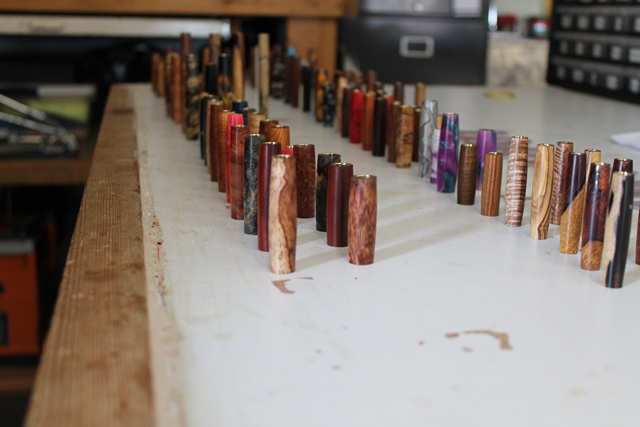

Whats the big hunk of wood in the 3rd pic?
CA Finish on all of em?
Big hunk of wood is USS North Carolina Teak.
Yes, all of them will have CA finish. That's what takes a long time.
Did you order the teak from the museum? I'm was looking at ordering one of the pieces they sell for $35 and make some blanks out of it. I was just worried that the wood would not be good. If you did get it from the museum, was the quality decent?
Thanks!
Brian
Yes, Brian. I buy the $35 blocks. The wood is perfect but I always crosscut it. It makes it quite a challenge to drill and turn, but it gives you that nice shimmer and crosscut pattern. I save the sawdust to repair it if I need to or sometimes I fill with aluminum or brass powder. Good luck.

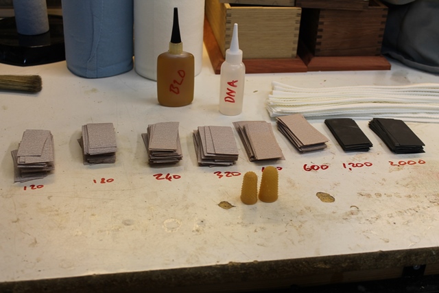

All sanded and BLO applied. Now, getting set up for the long process of Ca finish on each one.

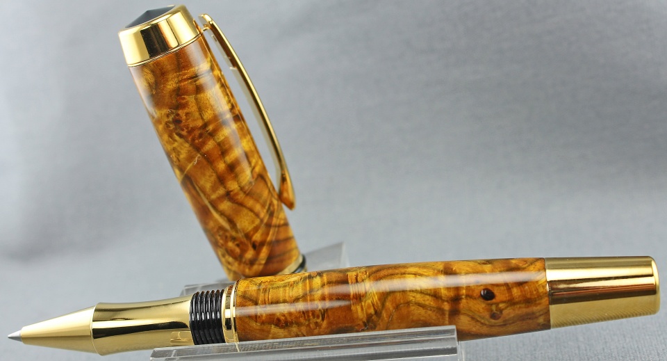

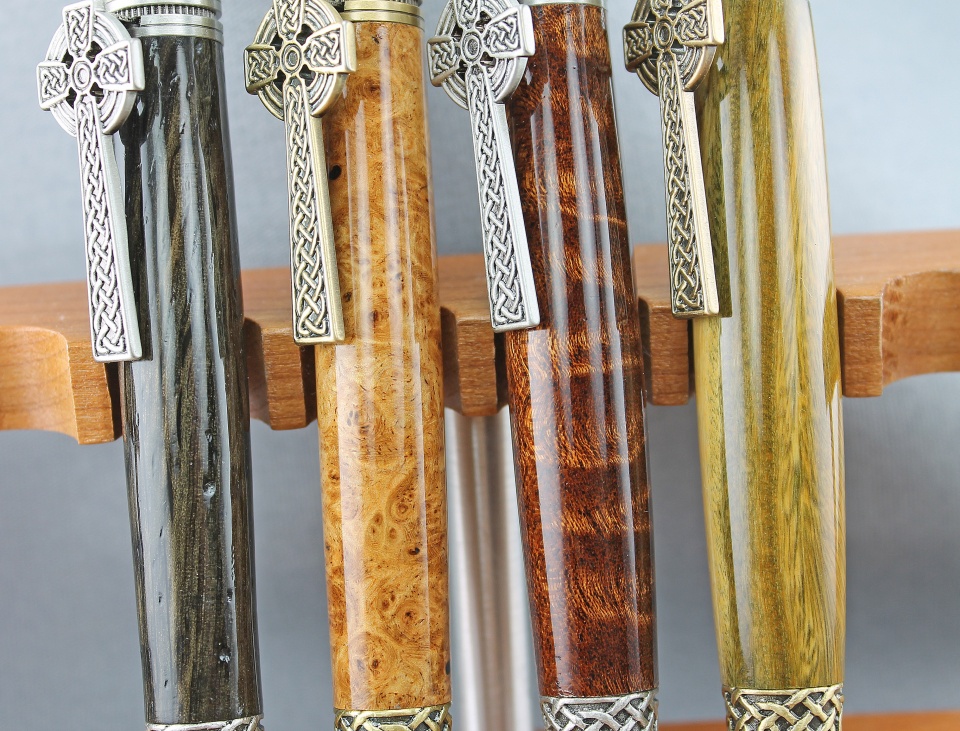

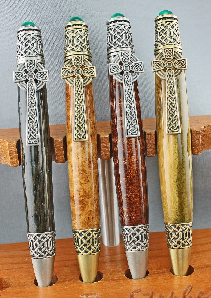

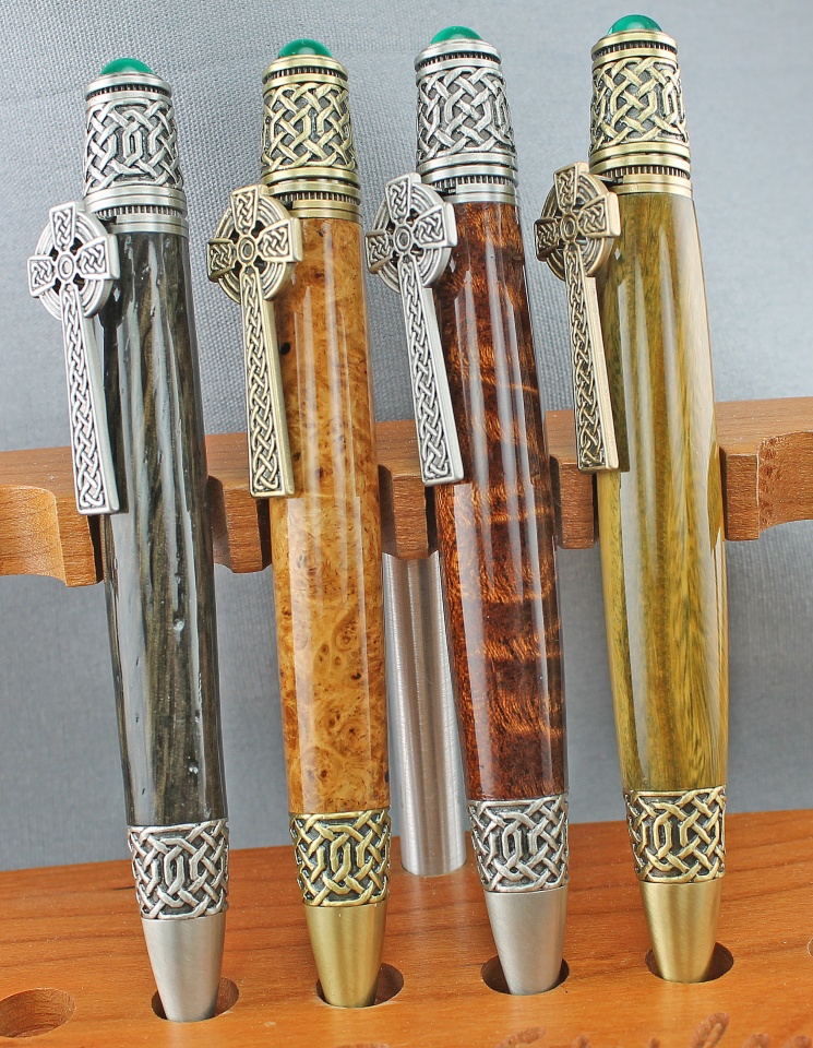

The remaining 72 pens have all been CA'd, shaved and the tips CA'd for sealing and are ready for the final fun part-polishing and assembly.
Here are the first 4. All Celtic Cross pens with the addition of the Celtic clip. From left to right:
Ancient Irish bog Oak
Gold Amboyna burl
Quilted Sapelle
Two tone Verawood
All are CA finish of course.

Those are SOOOOOO nice !!! Any problems with the Celtic transmission ? I understand it can give trouble but maybe PSI has had that fixed.
yorkie
Mar 2, 2009
1,116
Charlotte, North Carolina
I did have some trouble with them. too tight when the cap is pressed on and squeaky. A little fussy to get the refill into, so finesse is advised. I added a couple of drops of fine light oil and it is now quite smooth.

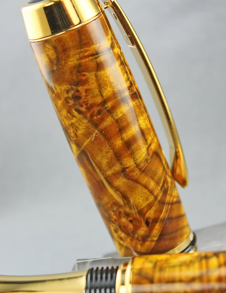

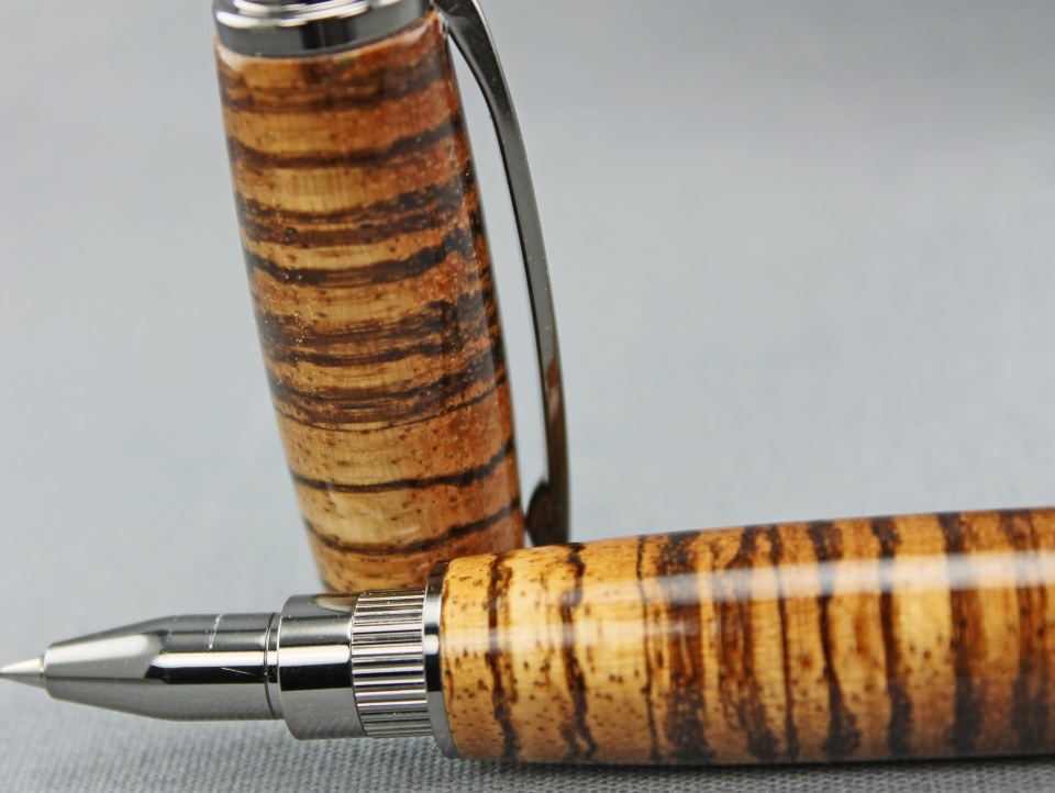

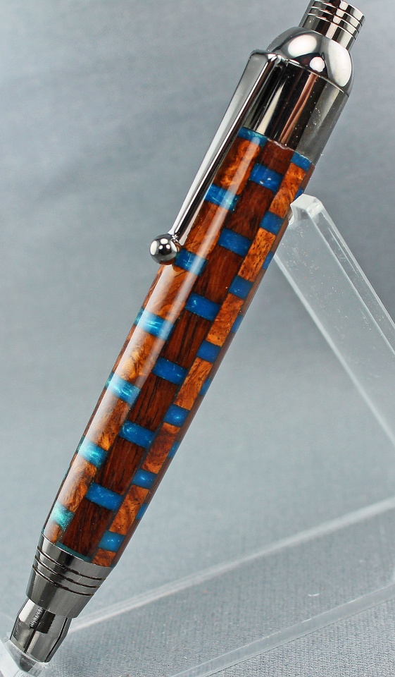

Here are tonights finished pens:
Quilted Smoke Tree burl (rarer than Hen's teeth) on full sized Statesman. The photos do not do it justice; possibly the most exceptional piece of wood I've ever seen and a challenge to pull a blank out of the block.

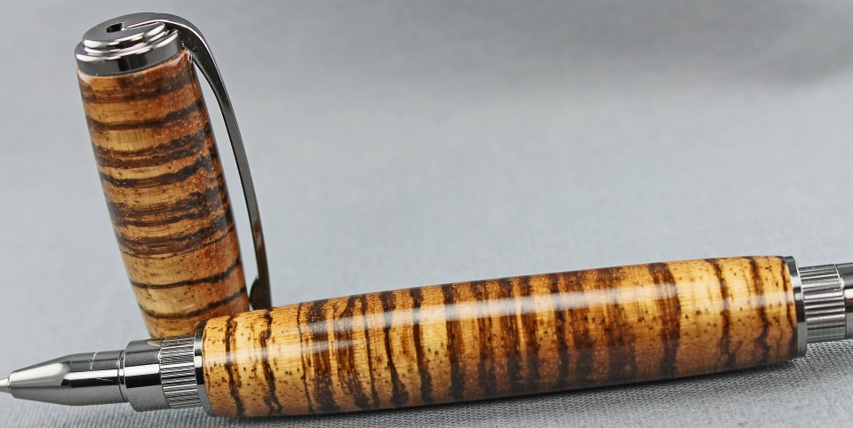

Crosscut Zebra wood on Graduate RB. Crosscut Zebra wood is so difficult to turn. Eventurally, I just switch to 100 grit sandpaper and take it down using that. Takes a while but well worth it.
Laminated Walnut and Cherry burl (not mine, I bought it this way) very tricky to turn. I originally planned it for a different pen and it shattered. I was able to recover the remainder of the blank and get a sketch pencil out of it.
All are CA finish.
