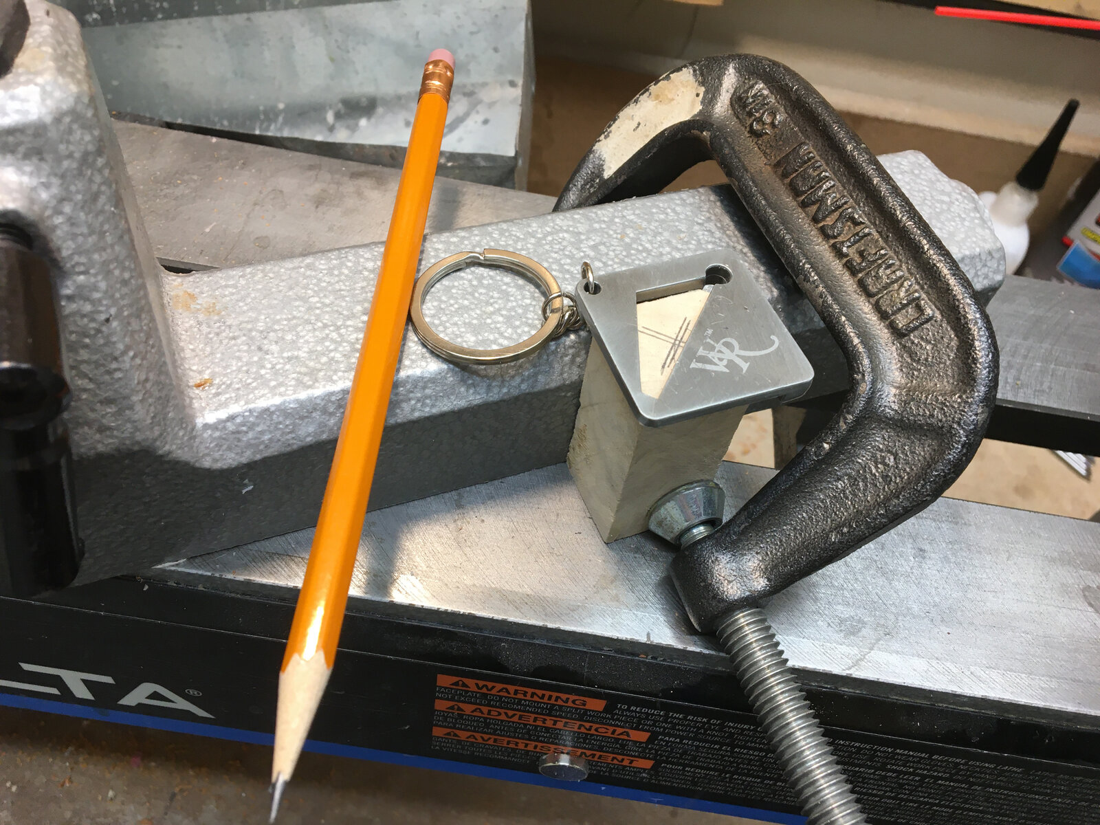

As time passes, I find it more difficult to handle and manipulate small items - my grip isn't what it used to be so I'm always looking for mechanical means to stabilize things. Here is one such trick I use: with the banjo tightened down, I can clamp things in place to work on - maybe it will help you too.
Mark, it's good that you found a method that works for your needs.
I do want to add a word of caution here. I realize for this task you just need something held in place but if you or others were planning on really cranking down on the C clamp, remember that cast iron is brittle. Clamping near the top of the banjo should be fine but clamping near the bottom could be risky as it is not solid at that point.

Thank you for providing this tip. . I can benefit considerably by adopting this idea for clamping while marking
I would add that I sometimes use magnets to help with similar tasks. . However, magnets can also be a de-stabilizing factor !!
