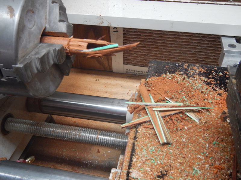

A sad story in 5 photos ...

Ugh! That sucks. Beautiful blank. Curious what glue you used, tho I know these things happen regardless...
I used Gorilla glue but did not let it set 24 hrs ... my bad.
Also I drilled the blank but started cutting down down the diameter without installing the brass tube as I wanted to see where the points ended up at ... (they get shorter as the diameter is reduced) again ... my bad.
Oh Well ... lessons learned ... start another one in the morning.

I rushed it ... short and simple!
Had I waited 24 hours the gorilla glue would have set better and this might not have happened.
Had I glued in the brass tube before attempting to turn down the diameter I doubt it would have happened but I was in a hurry to see where the points would end up.

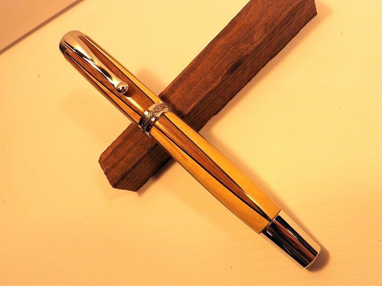

To answer your question about the pen ... I bought those strips (bout 36" long) off eBay a year ago but I think you can still get them.
Acrylic MOP and turtle shell. That pen has two strips side by side to make it wider and correct the mistake.

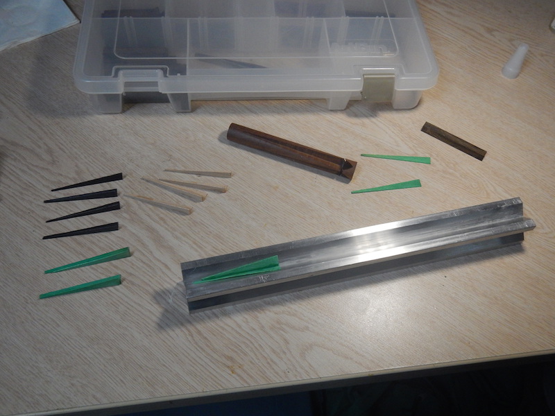

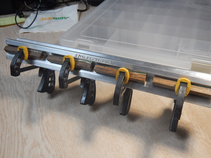

Can you tell me, please, where you got that extruded aluminum piece that features in the first three pictures you posted above.
I see the name of "TG Fixtures" on it, but a search for that name does not seem to yield anything useful. . Thanks in advance.
Oh My ... I have had that thing for years and most likely got it off ebay.
I do not know what they are called but any block of wood with a 45 deg groove cut into it will work as well .... just wax it good (renaissance wax) before using it to super glue the V shaped veneers together.

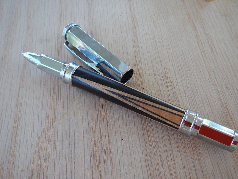

How about a "pictorial" on how you created the pen blank version?

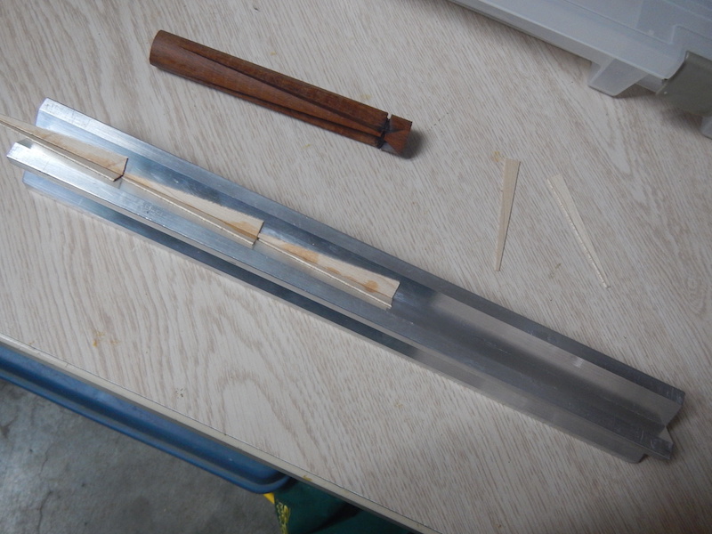

Learning from your own mistakes is part of it but ...the smartest thing you can do is learn from others mistakes so you dont make them too.
Mal look up Press Brake Vee Blocks. There are some from India a metre long for about $220Can plus delivery. They may make shorter ones but I didn't look that far.

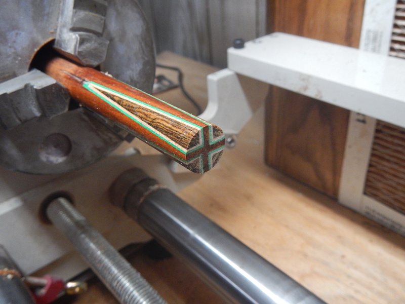

My question would be how are you cutting the staves?? Do you have a jig for that and can we see it??
STAVES? do you mean the V grooves cut into the pen blank or the colored veneers that accent the points and fit into the V grooves?
I spend about 4 to 5 hours getting a 4 point two veneer each point blank set up.
It takes a lot of time and I doubt you can sell them for what they are worth in time alone.
I make them because I enjoying doing a few every now and then.
It is the exact same process that I use to place them in the forearms of pool cues ... just on a smaller scale.
I have in the past used pen blanks to work out designs and methods that eventually are scaled up and used in pool cues.

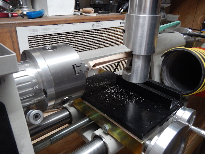

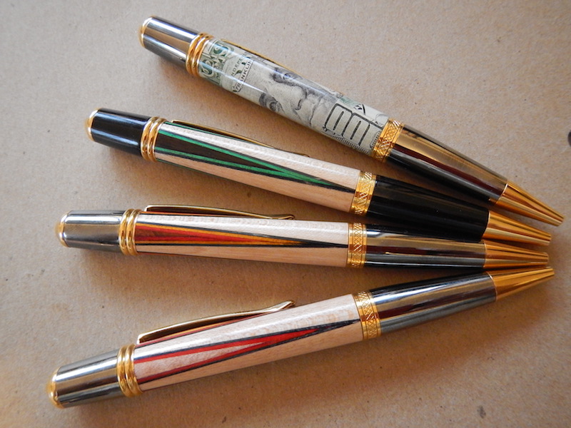

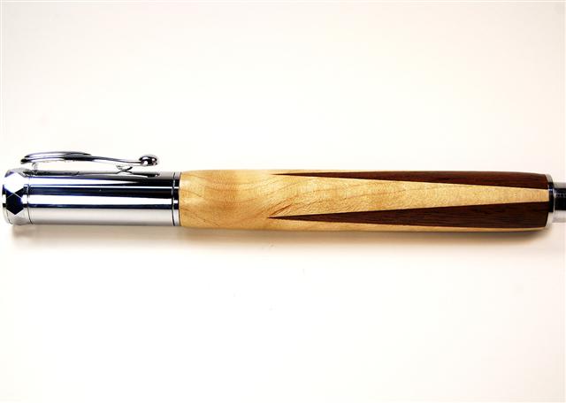

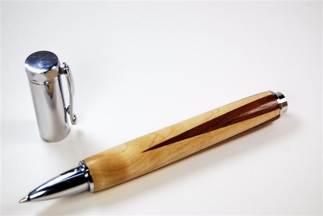

Here are some photos:
The first shows the setup for cutting the V grooves into the pen blank using a lathe and router. The lathe has a taper bar and indexer.
The second shows some finished pens (notice the points are a bit long)
The third shows another successful pen.
Two veneers seem to be the best number.

I could never figure out how sharp points on both ends were achieved.
(The pool cue people are very protective of their secret methods).
Thanks to Skips excellent photos I now understand what needs to happen and why you would cut and glue only two points at a time.

I found this link a few years ago when Skip Rat did a pool cue splice. https://forums.azbilliards.com/showthread.php?t=210048
The time and money spent since then has been a world tour of wondering where it will lead next. It was a fun trip, but too much of my shop equipment that has been worn out for decades and no longer has the precision that is required. I can't see me getting rid of the saw that my uncle bought in the 1930's.
Skip has his own version where he shows how he makes them using a router and his metal lathe.
http://www.penturners.org/forum/f19/pool-cue-blanks-dummies-65140/
He has others.
John, my newer method is my preferred way now. The ramp is easier done with a tailstock offset.:wink:
http://www.penturners.org/forum/f30/cue-blanks-yet-another-method-79294/
I'm certainly not saying my way or results are any better, but I personally prefer to see complete points on both ends of the V's.
Once the process to make these is understood, and the 'moving' of the points during turning is accounted for, then a simple mdf box jig can easily be made.:biggrin:
Willee, I feel your pain, to get that far and it blowing up can be tough. I bet the air in your shop was blue.:biggrin:
