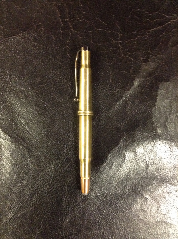

If you are using real bullets, or one you turn yourself, caliber is unimportant. If you plan to use slimline tips on anything .30 caliber, these help. Tip Bushing These are especially helpful if you are using two cartridges and the top one is a .30 cal and you plan to put a slimline clip on it. I'll add a pic of a double 30-30.
