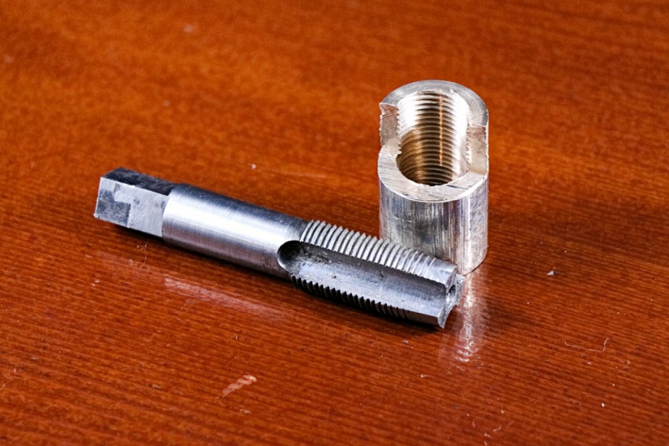

I've started work on my first kit less pen and one of the first problems I had to solve was how to make the correct threads.
I'm happy to say that I managed to make a serviceable tap and the threaded part is coming along very well.
I made a youtube video describing the process I followed for making the tap. I would be very interested in any feedback as I am not an expert by any means.
It did work quite well though so I am very happy with the result.
Here is the link for my video:
https://youtu.be/6OP2bZDLMbs
And here is a photo:
attachment.php
I watched your video earlier this afternoon and it seemed very straight forward. The only issue that I found for me is that I do not have a milling machine to go with my new metal lathe. Next you will have to show us how to make a triple start die to go with the tap.
I'm definitely planning to do that. I tried once already and it was ok but as always I learn so much from the failures that I think I can get a much better result by tweaking the process a little bit.
