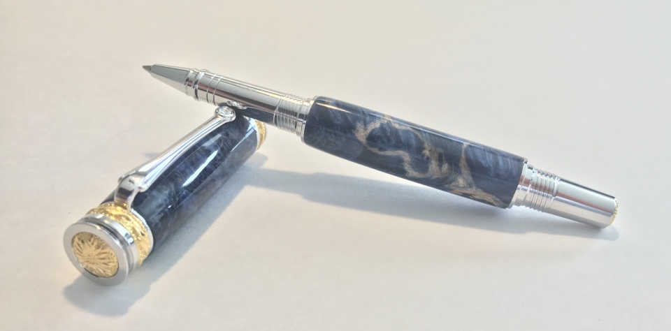

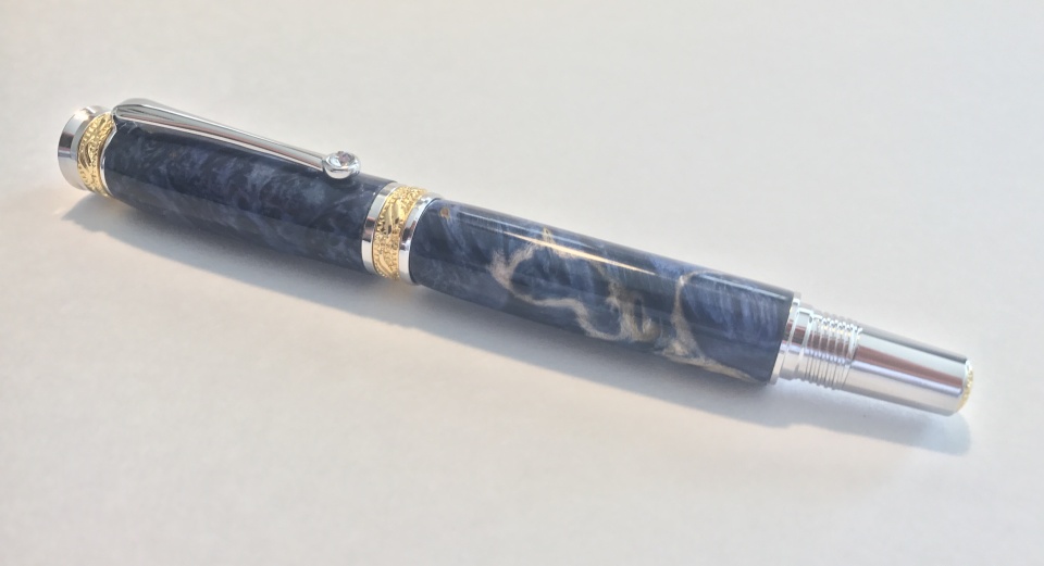

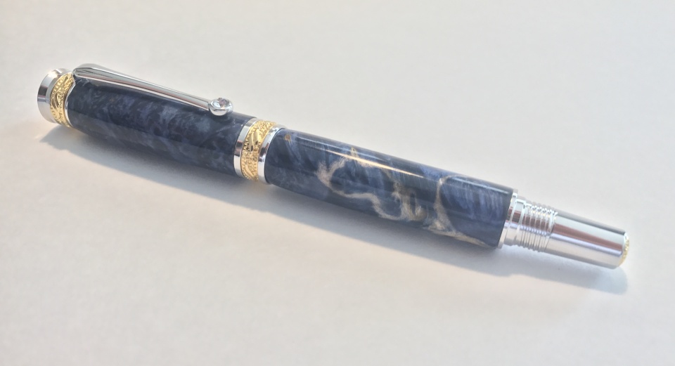

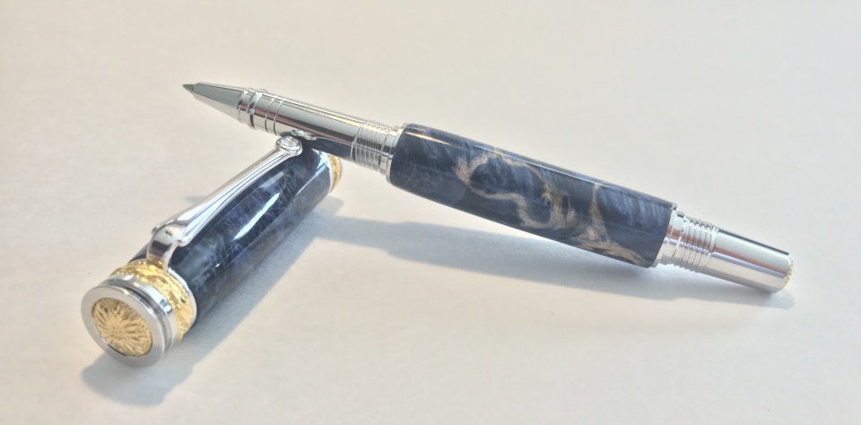

Blue stabilized box elder Maple. Majestic Junior from Pen State. CA finish.

Travis,Great pen, wonderful photo, outstanding finish job. I was certain that I was looking at polished acrylic until I read your data. Blue Stabilized box E never looked so good. You get my "finish of the year" for that gloss and reflection. "I am not worthy"

Thanks Brian! I'm really pleased how it turned out. I just sanded to 600, put on about 16thincoats of ca then finished with micro mesh wet sanding pads and finished with plastic polish.

The majestic line of pens from PSI is the only ones I will buy from them and they still are a classy looking pen and they hold up well. I have changed the pimp crystal (as they have affectionately became called here) at times to something that matches the blanks better and it gives a nicer appearance. Need to get more of these being I will now be getting back into pen turning in general. Will have to watch for some sort of sale, hopefully.
Your pen came out very nice and thanks for showing.
