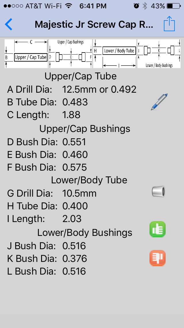

Hi everyone. I just started a Majestic rollerball. I guess it doesn't make much difference whether rollerball or fountain pen for me. The instructions that came with the pen call for 37/64" drill bit for the upper blank and a 15/32" hole size for the lower blank. I drilled both holes on the lathe and when I went to fit the tubes that were in the kit inside, both holes were too large. Not even by a little bit. I still used 5 minute epoxy to glue the tubes in and now I am waiting for it to cure. I am thinking that this will end up being a huge problem on a fairly expensive blank. Anyone else have this experience or know of a solution?

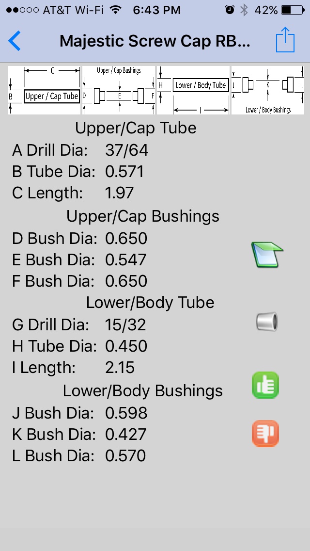

It should have been a 10.5 mm and a 12.5 mm holes.
A Z bit is 10.49 mm and a 27/64 bit is 10.71 mm.
1/2" is 12.7mm and 31/64" is 12.3 mm.
More4dan
Mar 17, 2016
2,102
Katy, TX
The Majestic full size uses the diameter in your post.
Maybe try removing the tubes and make the full sized kit. You could heat up a rod about the tube ID and use it to heat up the brass tubes. Get them above 250F and they should come out. Then redrill to the original hole size.
