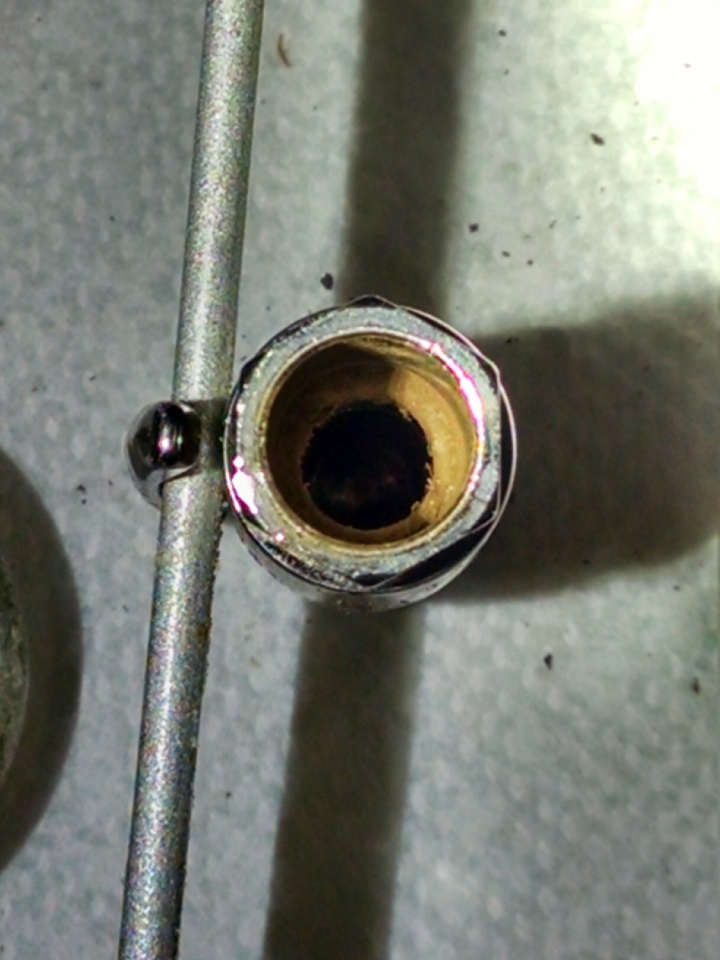

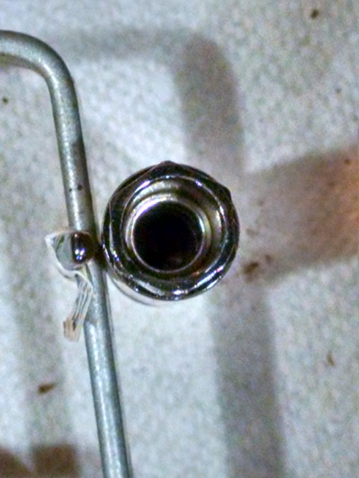

Looks like Mal wins for the probable cause - pictures are attached. see if you can tell which one has been in use for 2 yrs vs the new one. Looks like I'm calling PSI tomorrow for a replacement. please excuse the poor quality of the pictures, they were taken with my phone while i was holding a flashlight.
