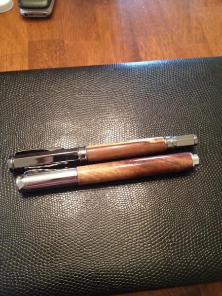

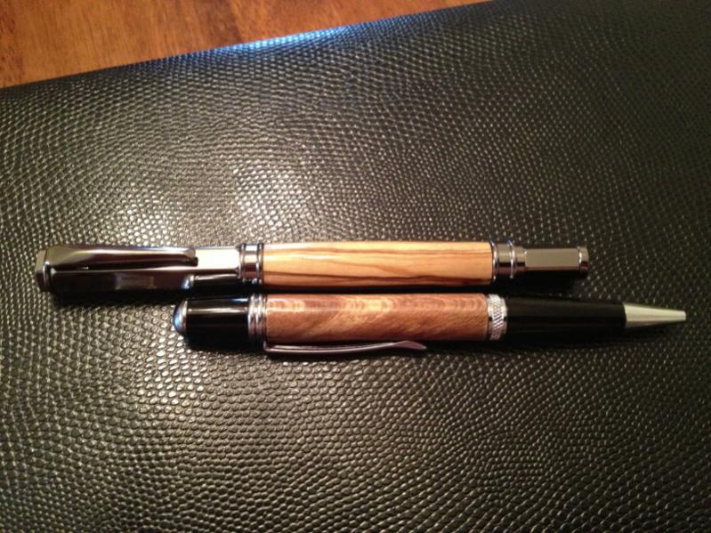

I snapped a quick photo of the tubes lined up for your comparison. The vertex is slightly longer but not much.

The kit overall seems of good quality to me. It is relatively simple. Easy to turn (but the material gets pretty thin on the tubes I you make it straight as I normally do.
Simple to assemble with small couplers pressed in. You can unscrew and change the direction of the pen if you like. I believe you can swap out rollerball and fountain options - haven't tried the fountain yet.
Te thing I compare it to in my mind is the zen because they are both single tubes with magnetic metal caps. The zen is much longer and I thought I would like it much better but I really like the vertex just as well.

There you go. That is what I wanted to see. Sometimes it is hard to tell from photos what a kit really looks like unless it is against another. That is no longer than a Sierra. So the only difference is the magnets. I was looking for something with a longer barrel. I just ordered some Zen pens from CSUSA. I understand about their magnet problem but will see what I can do with them.
Thanks for the comparison photos.

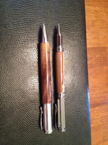

Quick shot of vertex vs zen
Definetly the difference I am looking for. Not a fan of the nb end but will see how it feels to write with. Just need some more area for some different blank ideas. One of these days I have to get into customizing some kits. I am sure that can be done too. Thanks again.

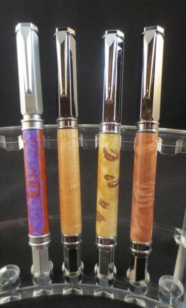

Here's a pic of a few I made awhile back, just to show different blanks.
