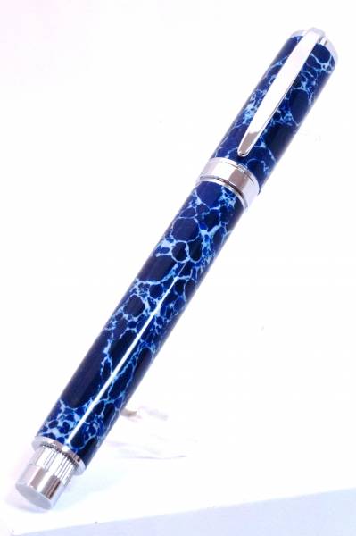

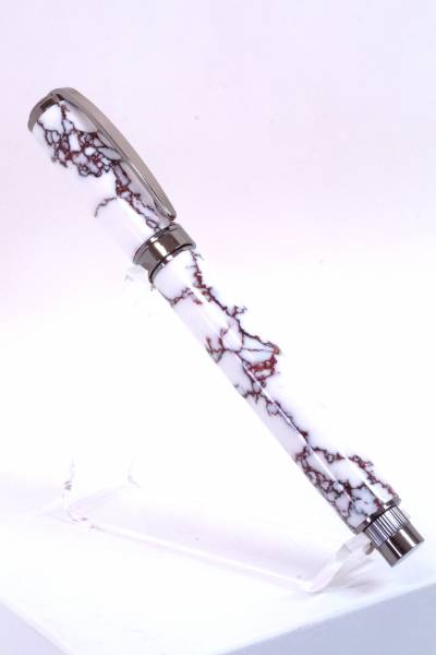

Here's a couple Graduates in Tru-Stone. I saw them in the PSI ad and thought they might be worth a try.
Basic evaluation: nice rollerball kit. The cap and bodies require different diameter drills (10.5mm & 12.5mm) so it requires 2 setups but that's no big deal. The kit itself looks to be nicely manufactured. Fir & finish is good. One thing new to me is the clip assy. It has an adjustment screw inside on the bottom of the assembly that you can use to modify the standoff gap of the clip. It's not mentioned in the instrs nor on line or in the PSI catalog but it's interesting. Wonder if it'll be worthwhile to anybody.
I did these 2 in "Wild horse jasper" Tru-stone and "Sodalite" Tru-stone. LOML saw the Sodalite and "appropriated" it before I got through the door from the shop.
I continue to wowrk on finishing. These 2 came out good, I think. Finishing schedule was wet sand through 2000 (including longitudinal sanding on each grit), then Novus 3 and 2 then a quick buff on the Beall wheels with Tripoli and white diamond.
Photos are with a Sony digital - 2 seconds at f22 or thereabouts. Then color and exposure corrections on the computer. Resized on line.
Thanks for looking. Comments welcome (encouraged).

Those came out great!
I recently ordered some truestone blanks. After seeing your pics, I can't wait to starting turning them.
Nice job on those two :cool:
Mordi
