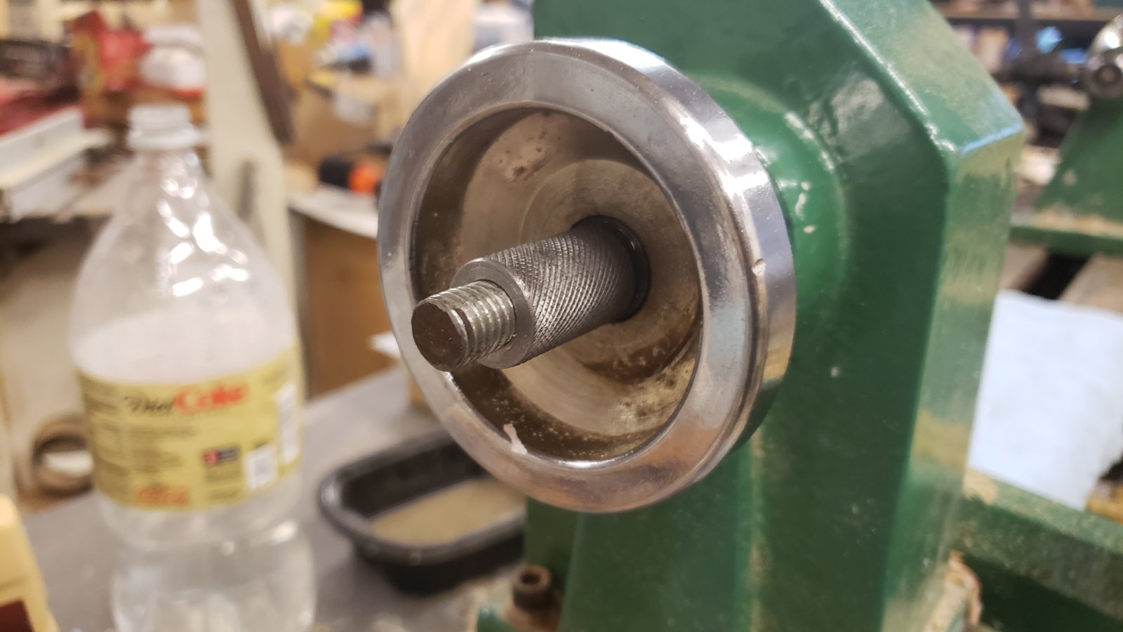

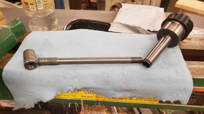

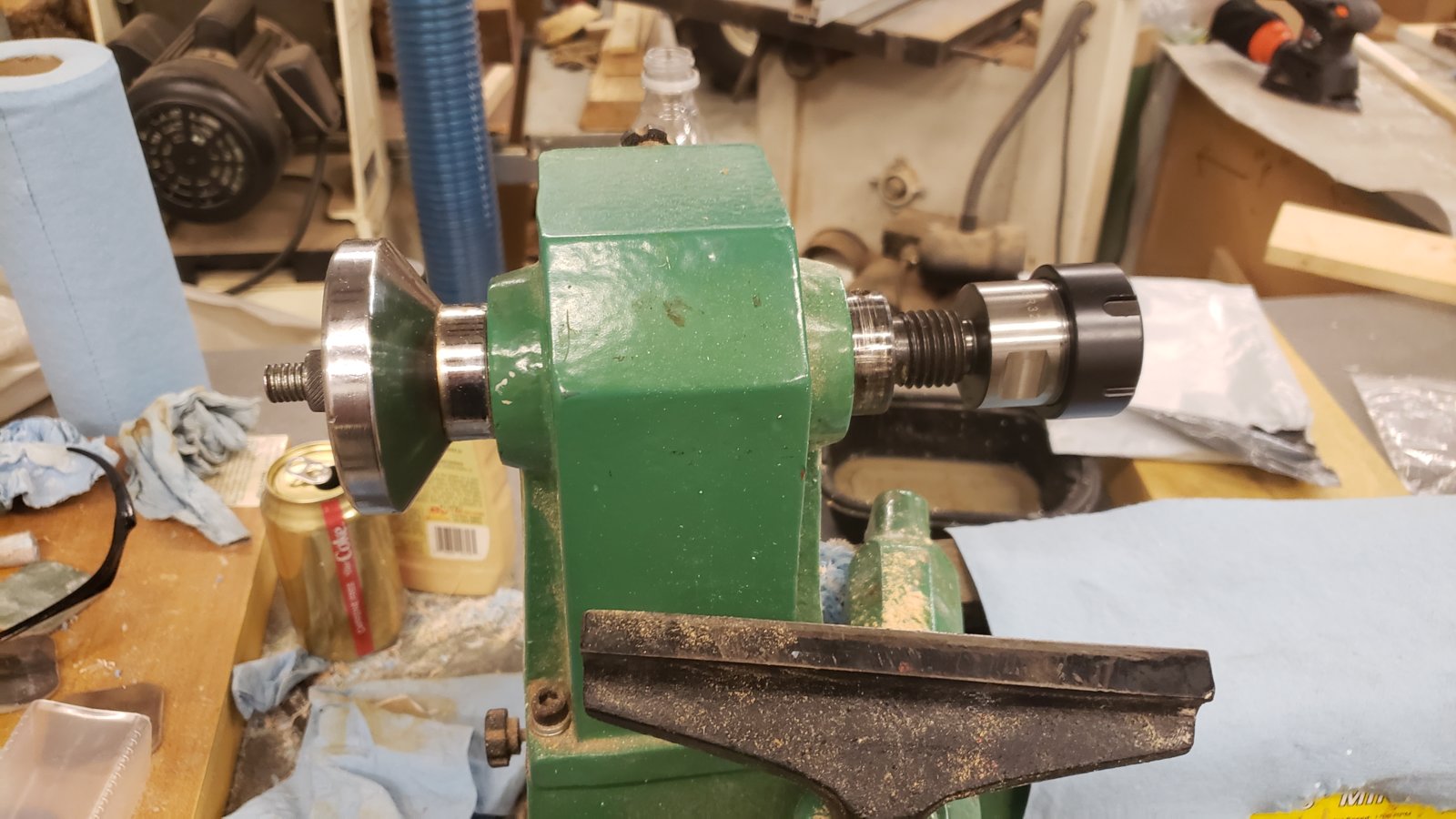

ecrouse Member Joined Nov 8, 2012 Messages 84 Location Houston Mar 18, 2020 #1 Bought an er32 collet chuck and needed a drawbar. Made this out of some 1/2" all thread for the bar and a chunk of 1.25" round bar for the knurled nut. It's not pretty but it works
skiprat Passed Away Mar 22, 2022 In Memoriam Joined Oct 19, 2006 Messages 7,812 Location In a Skip in Wales Mar 18, 2020 #2 Looks good. I'd just trim the threads flush with your knurled nut though.
Kenny Durrant Member Joined Sep 11, 2012 Messages 2,729 Location Sachse Tx. 75048 Mar 18, 2020 #3 I like it. I also agree with Skiprat. I wouldn't do it for looks I'd trim it because why have something sticking out that might grab clothing.
ecrouse Member Joined Nov 8, 2012 Messages 84 Location Houston Mar 18, 2020 #4 I've left them because I've been contemplating other things I could add, like a dividing plate, for instance.
magpens Member Joined Feb 2, 2011 Messages 15,907 Location Canada Mar 18, 2020 #5 "It's not pretty but it works " Doesn't look bad, either !!!
D Dale Allen Member Joined Oct 27, 2012 Messages 1,383 Location Massillon, OH Mar 18, 2020 #6 Find a vinyl cap to put on it. Maybe a door stop replacement cap.
