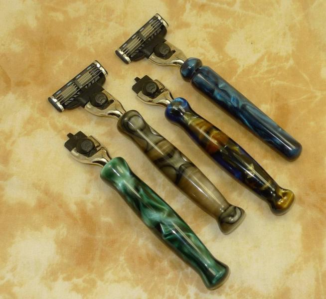

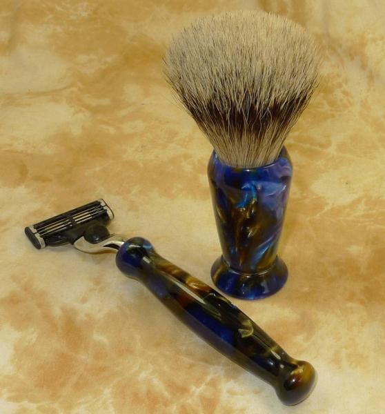

Took me a while, but I finally got around to making some Mach 3 razor handles to go with my brushes. Thanks for looking and any comments. :)

Thanks for your post Anthony, it gives me some shapes to shoot for. I got my three in, going to try to get one done this week. I`m busy, retired and all, you know.

How does the Mach 3 head connect to the handle? Is there a tube and insert for the threaded portion rod?
Thanks
Tim
Tim, there is a 4mm threaded rod on the end of the head. I used a 7mm tube and turned it as a closed end pen using a 7mm mandrel from AZ Sil. I then epoxied the threaded rod into the tube. I am going to try a different way next time. I am going to turn the handle using a Bealle chuck, then drill the hole on the lathe closer to the 4mm rod and epoxy in.
