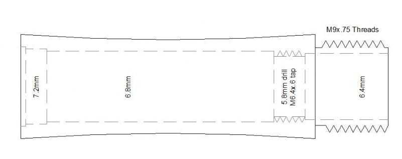

As an option you could increase the length of the section so that the feed housing doesn't go past the main body (as to not overlap where the tenon is for the M9x.75 threads), just increase the depth of the 6.4mm hole that holds the convertor in place.
This obviously is a design decision that could affect the look of the pen. But it would allow the use of M9x.75 threads for any size feed housing.
This is the idea (shown for a Bock #5 feed housing)
attachment.php
AK
I thought about that too, looks like it would increase the section length by about a quarter inch, which shouldn't look too bad, especially if the section matches the barrel.
