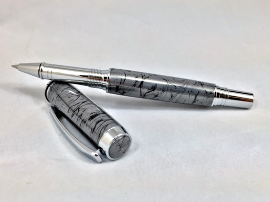

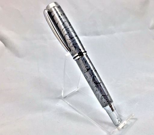

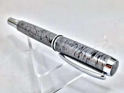

Here's a M3 White Titanium Mokume on a Jr Gent 2. It is the chrome version, I'm not a huge fan of the black finial but do like the black band....so....pop out the stock and make a finial I do like. :biggrin: I know the chrome isn't so high end but did think the black band would be a nice pairing. C&C more than welcome! Thanks for looking.
attachment.php
Turning was great, carbide, sanded to 1k and used the two part polish. Really nice material to work with.

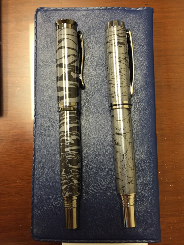

I previously turned the same material and posted it in the thread below. The material looks very different on this pen. I actually think it looks nicer with more white or at least with finer black lines. For feedback for M3 I think the finer the black lines the better any of the colors will look.
