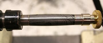

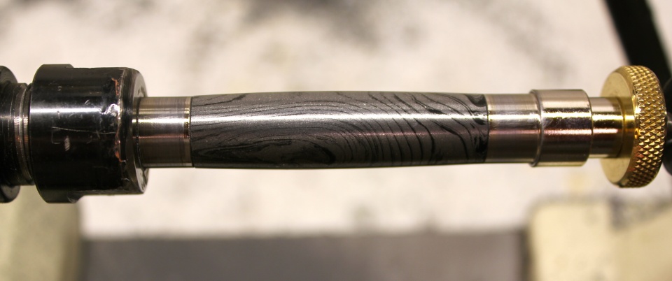

Just finished turning a M3 Blank to bushing size - went fine.
I have dry sanded 180-600 and looks fine. Before I take it off, I thought I'd ask how do others finish this blank.
Mine will be a Majestic Junior Rhodium, so don't want to do a hurry job when an extra few minutes will make it better.
This is my first time with M3.. So far I am liking it!
Gave away my carry pen last week... Hmnnn.. too big?
No, I did not order the compounds...:mad:
So... Do what you can, with what you have!

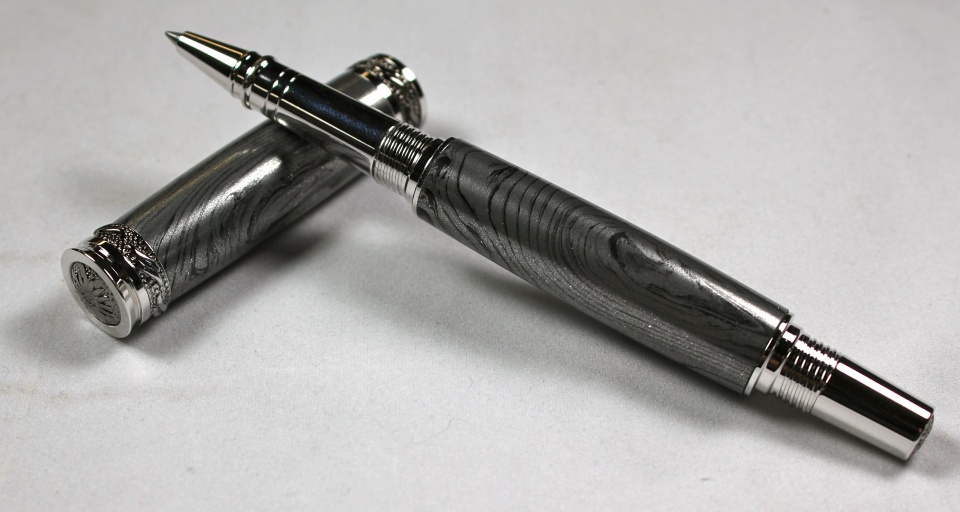

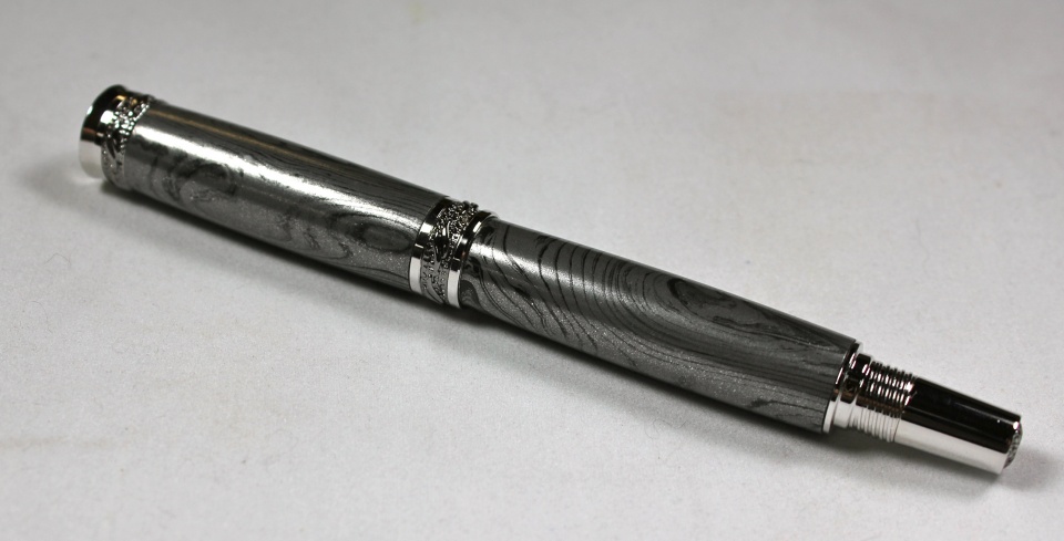

I finished the pen with: Turtle Wax Rubbing Compound; Turtle Wax Polishing Compound; and Renaissance Wax.
Truth be told... I really like the way it came out!
The blank turned very easily; wet sanding/polishing went well; final finish went fine.
In the picture, if you notice no clip... this was missing from the kit (I'll e-mail tomorrow). It doesn't matter to me as this is now my new carry pen! and I have no use for a clip.
Thanks for the thoughts!

I like the M3
Good job on the M3, and very creative, I would not have thought about using Turtle Wax or Renaissance Wax. I have made 2 and like the way M3 turns, I do suggest that if you make more that you obtain the M3 polishes. I do like the idea of the Ren Wax though.
Yup! I will be getting the "proper" polishes. But, I used the pen today at work and it's very nice as is! It can be better with the better polishes, so I'll go for that! I was pleased with how it turned, and the look is very different - I like it!
