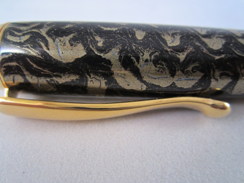

I now have a picture of the blank that I tried to describe. Please look at the picture - note the deep and random scratches and help me figure out what happened!! I have backed off doing any more ofthese until I can figure out what happened!
Thanks for your help
Keith

M3 blanks have specific polishing instructions that require the "A" and "B" polishes. IIRC, turn to dimension, 400 sand if needed, then use the polishes. never had an issue with htese and I have made bunches.

Those don't look like scratches to me, they look like gouges or voids. I might suspect the blank was defective. I think it would be worth getting an opinion from the M3 folks.

From what I can see, I think this looks like a problem with the blank. The marks are only in the gold and from what I can tell in the picture they appear to be silver in color? I returned 20 or so blanks several months ago to the manufacturer because they had pits in the gold. I'm not sure if you got the blank from me or not. But,you can either go back to the company you purchased it from and ask for a replacement, go directly to the manufacturer at www.metalpenblanks.com and ask for a replacement, or just shoot me a PM and I will be glad to help you get a replacement.

If you are referring to the silver looking inclusions in the brass, I going to say that either the blank had the problem from the get go or you created too much heat build up when sanding or polishing and caused a blowout in the metal. Its odd that it only happened in the center of each metallic pocket. Have you contacted the manufacture to seek their advise?

Yep - I followed them precisely! I wanted to get other opinions and make sure I wasn't the problem before I went back to the supplier.

Keith I've not seen any chip out that looks like that, that almost looks like voids in the material. what I find odd is the shapes of the bad areas, had it been from a dull insert, the tear outs would have been more like very small round, or oval pockets, DAMHIKT. but I do hope that it wasn't caused by the Woodchuck.

Outstanding customer service! The supplier has been followinf this thread too and is sending a replacmeent blank. I love the vendors/suppliers on this website - they really go out of their way.
