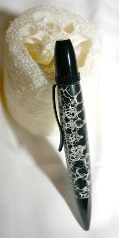

as said before. you should cast with clear resin, otherwise there is a risk that you cant see the structure. I did it with Alumilite and a pressure pot. No stabilization is necessary. at this point. I thank Curtis who gave me valuable advices to do this.
greetings from austria
otto

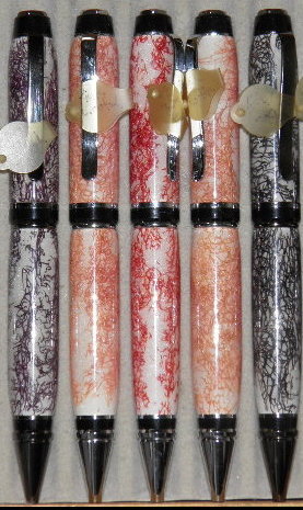

edit: I will add these were dyed, cast with clear PR, with a bit of sparkle/glitter added and back painted white...
