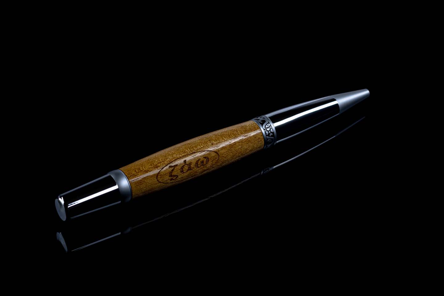

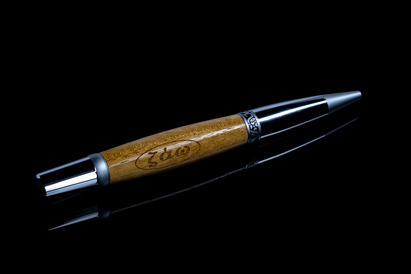

I've been trying to take my pen photography to the next level. In particular, the next level of low key photography. I've been watching a ton of videos on still life/product photography, particularly lighting, and have invested some money in reflectors, boom arms and clips to hold and position reflectors. Don't have the booms in yet, but I gave the reflectors a try. It definitely gave me much more exacting control over the position, size, and scale of highlights.
I also liked how some photographers used simple reflective things, like a piece of perspex (or plexiglass, or optix which is what I used as it was cheap and this was my first try) painted gloss black on the back side, producing a very nice darkly reflective surface. I liked how that dark reflection worked for many of the videos I watched, and gave it a try. My lighting control needs work, for sure...but I'm curious what people think of this result. This is one of 15 pens made for a client, sets of 5 each with different woods:
(Accidentally left a bit of a fingerprint smudge on the nib, hence the imperfect reflection)
Had to do a bit of post-processing work to clean up the reflections of the reflectors, which were apparent in the upper part of the photo. So I selected the pen and its reflection, then just made the rest of the image black. Took care of the never-ending scattering of dust as well, which seemed to just form out of thin air and land on my freshly cleaned highly reflective surface illuminated by a very bright white light! Dust!! Meh!

EXCELLENT ! ! ! ! !
Thanks for posting this thread, Jon ! !
I am interested in upping my pen photography skills, so I will be following your progress.
Hope you continue to report ! ! :D . :D . :D

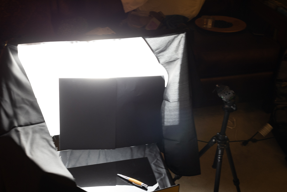

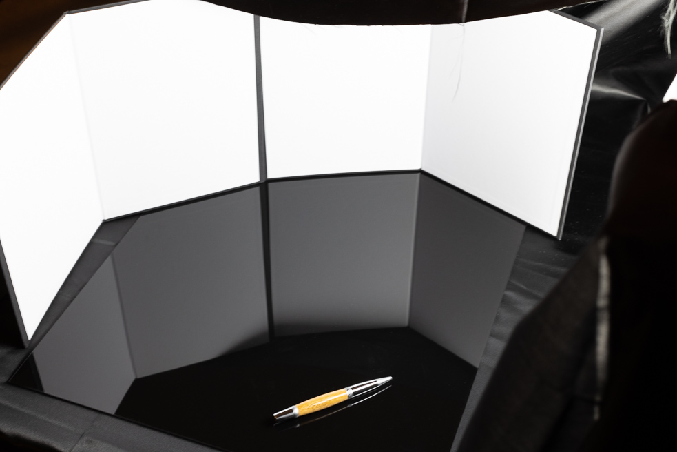

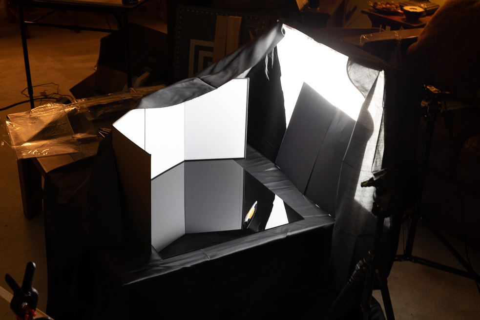

Ok, some quick photos of the setup. Sheet of Optix, painted black on the bottom, as a reflective base. Single large light source to the right. Couple of pieces of black paper in front of part of that light source, and a black shroud (normally a black background for one of my light tents) to cover the front edge of the light. Two white reflectors wrapping around the back of the pen, to give it that backlit rim lighting, which is essential for separating the product from the background (without the reflectors, the chrome simply reflected black, and the pen blended into the background. I ended up wrapping the whole setup in the back with the black fabric, to prevent the Optix from reflecting the entire rest of my home.

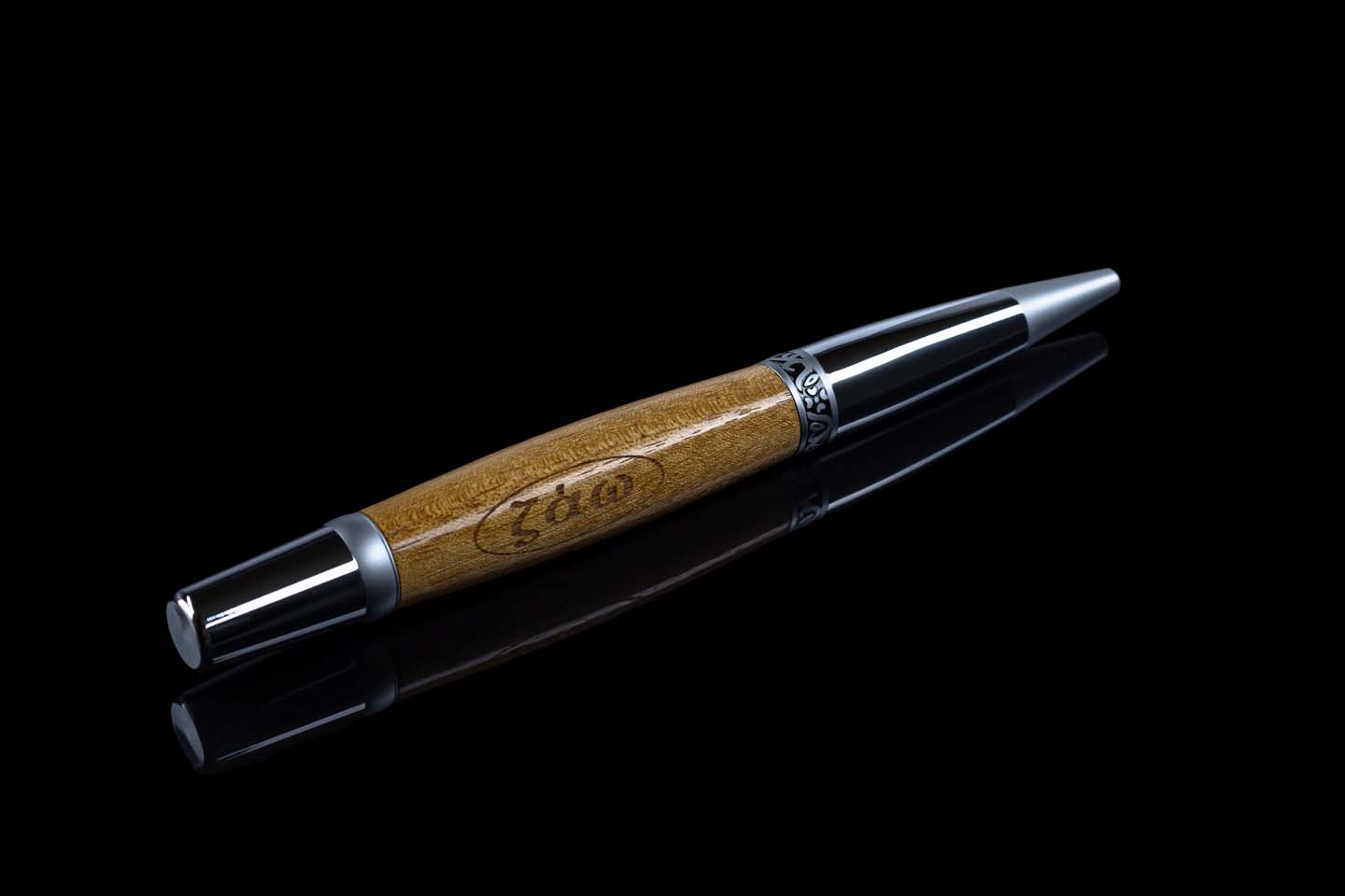

Given the discussion this has spurred, I thought I would share the original photo (actually, this is after a little bit of cropping, but before I fixed the background). This shows the reflections of the reflectors, which I nuked by masking off the pen and nuking the background by just filling it with black:

Alright. Brought in my second lamp, and fiddled with the setup until I just had the top of the finial lit by that other light:
I think this is better, as no part of the pen really just "vanishes" into the background now.

Black background usually makes for very classical photos. There is one weakness in that - in which I may not be saying it technically correct - the black eats up the light. The reflection along the bottom side is OK - along where there is chrome/metal edge is, but when it gets to the wood that is not as reflective, it is a little difficult to see the outline of the wood part of the pen. This brings up the question for me - what is the purpose of a photo? To make a great photo, or show off the pen? If the point is to present the pen, IMHO, there should be a bit more light on the lower side without washing out the sides and top of the pen. The purpose would be to bring up more light on the lower visible edge and make it nearly as crisp as the linear top side edges along its full length.
Eric (Sylvanite) said it perfectly above in his link. Study that link.
He turns a photo from emphasizing a photo to emphasizing the pen.

Thanks for the reply, Hank. I agree, its not a perfect photo by any means. This is my first foray into lighting like this. I whole heartedly agree that the pen needs more lighting along the bottom of the blank part. The whole pen needs better lighting in general, for sure. I'm just happy I was able to get this done almost purely in camera, which was exciting. It did not require much of any post-processing except a bit of masking to remove background reflections, which based on my research is pretty common. One way or another background junk often needs to be edited out.
I think you make a good point about the photograph's intention, and that is to present the pen. That said, I don't think that means we cannot explore more creative, artistic and/or stylistic ways of doing just that. That is what I'm trying to do here...explore a particular style of lighting. Hopefully in the long run, I'll be able to achieve that goal of properly presenting the pen...with style!
Regarding the post that was linked. Some interesting points were made, indeed...however, the photo demonstrated in that thread was not a low-key (i.e. overall dark, low lighting) photo. It had a dark background, but in the end it was a very bright photo. I wouldn't necessarily call it high key (i.e. overall bright, light colored lighting) photo...but it did not really have the same look and feel I am going for. I am actually trying to get some black or at least "dark" in the pen's reflections. It may be that I could use a gray card to lighten up some of the chrome that is currently black, just a bit, to make it a dark gray...I am not sure. But the general goal is for that "low key" look.
I'm actually OK with some of the reflections on the chrome being black, so long as I can otherwise highlight all the edges of the entire pen. I just about achieved that with that last photo, but your point about the lower edge of the wood part is entirely valid...I failed to light that properly.

Ok, trying to address the issue Hank brought up. Same exact photo as before, I just worked on the exposure a little bit to try and make sure the pen was properly exhibited:

Well, I finally have some free time. Still playing around with the reflective low key photography. Took these photos of three sets of five pens I made for a customer recently:
One of the challenging things with this dark environment is background. I had to process each of these photos to remove reflections of the surrounding reflectors and lights. Dust is also a huge issue. Even after cleaning the field to the point it appeared to my eyes to be clean, in the photos, especially after a light bit of sharpening, there was still a ton of dust particles. So I did some dust & scratch removal with photoshop and some carefully placed masks. Also a bit of healing brush where the dust & scratch filter did not work. In the end, the photos cleaned up nicely, but yeah...dust is a REAL problem with this low-key photography stuff...

Jrista- Those look nice, and yes P/S is a fact of life when it comes to low key and especially on a reflective surface......not to be critical, but a huge key to low key is separation. Make the pens really pop...more top/back light is needed. If you look at the tops of the pens, you need more separation from the background. Make the end of the pens reflect more. Make no mistake this is a very good effort and would probably be acceptable in most studios, but to really get that over the top look....more power to the boom light.
I always liked low key for the drama in which it creates, but in portraiture and some Commercial, I began to use it less and less it. Because, in a low quality publication, like a newspaper or some low end brochures it required, it just got muddy or blah. So when the customer requested a low key and it was going to be used in Newsprint I pumped the "boom" light up even more. Remember though, it's a garlic light....at some point too much garlic will spoil the meal. It's a fine line.
I do applaud your efforts...good job...but you are definitely capable of taking this over the top. Your efforts of lighting a myriad of reflective surfaces is awesome! Make no mistake the addition of that light is going to complicate reflections...... You are so very close.
Edit...I forgot to mention that your pens are nice too!

Hank....the reflection along the right side of the pen is called a highlight....I would like to see that "go over the top" that way the top of the pen has a highlight too.....I call that a Boom light, but in a small product setting like this, it would really not have to be on a boom. Some folks call it a hair light even though it is not on hair...They use the hair light reference because hair is on the top of our head...well most folks....and the light is used for hair in portraits too.
To make a comparison to hair, when the hair has a slight highlight on it, it stops dark hair from blending with the dark background. We call that "falling into the background" In extreme cases, it may look like the face is just hovering without hair. When the highlight is on top, it makes the subject pop off the page or often referred to as 3 dimensional....
Thanks! ----^
Moke, you are dead on about the tops of the pens. Their darkness presented quite a challenge to masking off the true background to eliminate the reflections there. And the tops of the lens do blend right into the background. I don't even like that aspect of the photos myself. I have more lighting and reflection gear on the way, with more tripods to hold more reflectors and such. I am still watching videos of other people doing low key/reflective product photography. There are so many ways of doing things out there. Interestingly, some photographers place a blackout card or something behind the subject to block light. They only bother to cover the area of the product, and allow any background lighting to still flow around that blocker. They then simply erase the parts of the light that extend around the blackout card in photoshop. So many ways of doing things...
This is a long-haul journey. ;) I'll be working on perfecting this for a while. I plan to share my experiences as I go, hopefully to help others who follow along, and I welcome more advice in the future.
