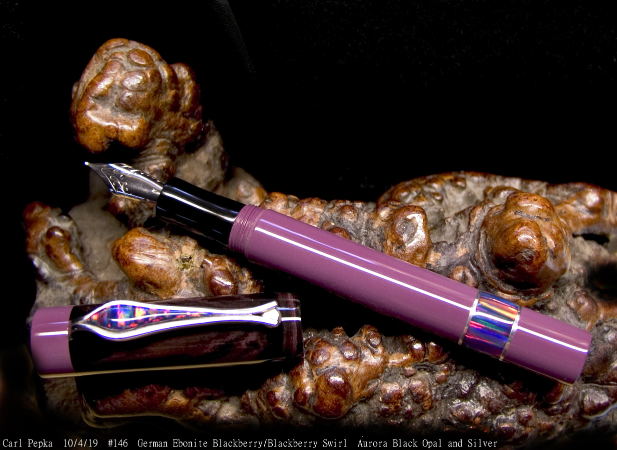

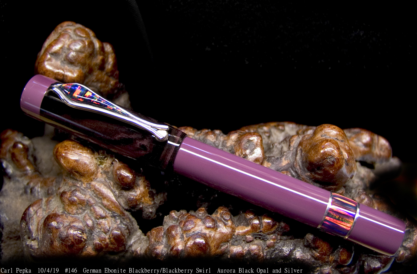

German Ebonite, Blackberry and Blackberry swirl, Aurora Black Opal and Silver.

Your pen is alive with color...the Black Opal accents are very nice. Did you hand work and turn the opal? I would like to learn to work with opal. Any suggestions for learning how?
Thanks, it's lab opal. I did turn the band and hand carved the piece for the clip. It's very similar to real opal but a bit more stable and a lot cheaper. Sharp tools a must, I used carbide on a metal lathe for the band, cant take off to much or the end will chip. Dry and wet sand up to 1500 then buff. https://www.etsy.com/shop/AuroraOpals?ref=simple-shop-header-name&listing_id=740808517
Thanks for the info. I will look in to this and may give it a try. I have an assortment of black opal on hand, but those will probably will be too difficult to work with. I might just experiment a bit, and see how much trouble I can get into😬
Good luck and post the results.
