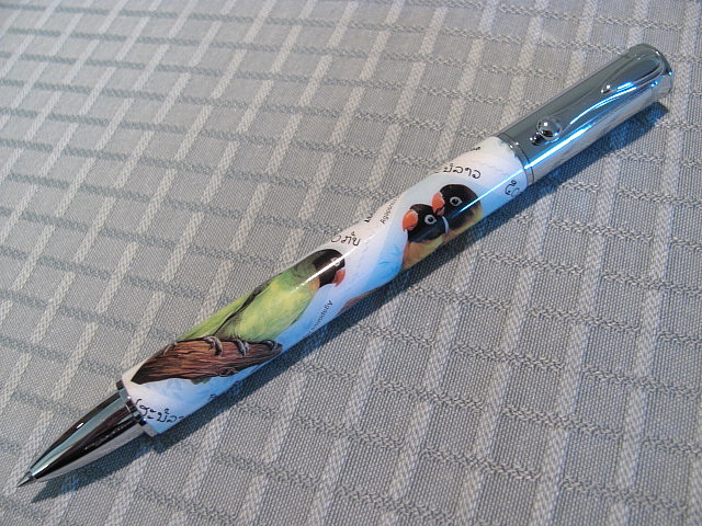

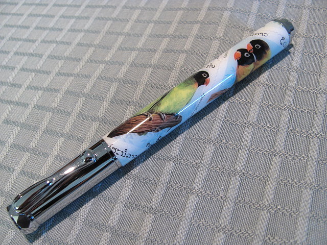

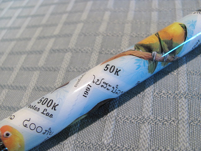

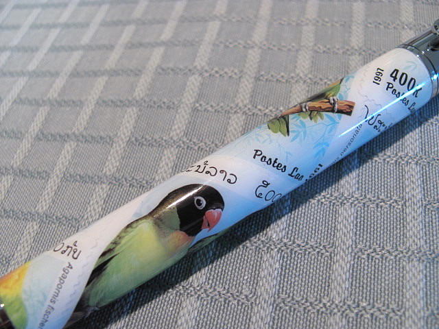

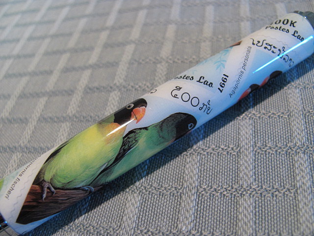

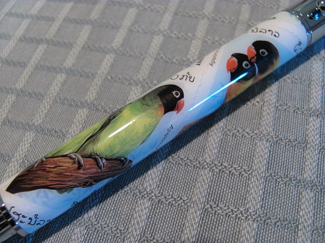

For my Christmas present this year,I decided to make a few stamp pens,because they are so fun to do.
When I saw these neat Lovebird stamps from the country of Laos,I thought they would be nice on a pen,hoping someday a parrot lover would buy it.
I love the colors and details,it's a real cheerful-looking pen!
This is how the first of two turned out.Done decoupage-style ( ca over wood core )
Thanks for lookin',
Steve
