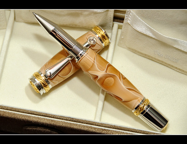

Ok, so I had some time to work on pens today and I figured I would try some lucite. I recently purchased this Lucite from exotics and I have to say..."It's AWESOME." I had to reverse paint the tubes and use sharp tools with small cuts, but it was well worth it I think.
This one is the Butterscotch Ripple Lucite on a full sized Majestic:

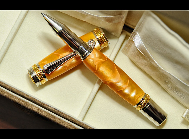

This one was the Root Beer Float Lucite:
As noted, I painted the inside of the blanks white. The Butterscotch Ripple Lucite was accented by this, but the Root Beer Float Lucite was so transparent that it truly took on the look of the white paint. A black paint or different color would change the entire look of these blanks...who knows:rolleyes:

Tim,
Your pens look GREAT!!!
My suggestion on color of tubes would be to paint them close to the "background" color of the lucite.
My thinking is that the swirls will become more pronounced, and the base color more vibrant if the background reinforces the base color.
Hopefully, we will see many more examples in the next couple weeks (there are now a couple hundred blanks in customers' hands). Thanks for posting yours!!!!

Hi Ed,
Yea, after turning these I figured a change in paint color was in my future. I hope to see some more and how they turned out with different tube colors. It truly is an amazing product and well worth the effort to turn.

Awesome pens. I have been turning Lucite for a long time, I still have a healthy supply from Pipe Makers, but I am glad to see Exotic selling them too.
I agree, colour matching the blank with the paint will pop the look, I use the acylic craft colours from Michael's

I love both of them! I wonder if you got a similar color, only a bit darker? Either way, outstanding pens!!!!
They truly are different colors as solid blanks. It's just that the Root Beer one is very translucent and it took on the properties of the white paint. I think it would be a different story if I used another color. I do like that final look of the Butterscotch one though. Pictures can only do so much:biggrin:

Tim, Those are both BEAUTIFUL pens!!! Peter used up all the very fitting adjectives and analogies to how gorgeous those pens are. My favorite is the Butterscotch Ripple. AWESOME photography. What type (Ceramcote..etc) of paint do you use to paint your tubes and/or reverse paint the blanks with? Thanks for sharing. Regards, Doc
I used a two in one acrylic lacker paint for the reverse painting of the blank. I also found that if you use a 600 grit paper and do a lite sanding inside it will result in a smoother look when the lucite is turned. I did this on the butterscotch blank and it looks high dollar, the root beer one went directly to paint and it shows some of the ridges from the drill bit. Just an extra step that will ensure the finished lucite looks its best.

With all the beautiful work that you have been turning out, I swear that you had been turning for seven years, not seven months!
If you haven't done it already try making yourself a "paint stick". A rod/tube with swaths different sample colors painted on it. After you sand the inside of the lucite, insert the rod to see what color of tube you might like. Not a 100% fool proof of course (nothing ever is), but it can be a useful....and sometimes the results may surprise you!

The lucite is great stuff and they really shine up well. I have done the amber ripple, i painted the tubes and blanks black. I used c/a to glue it and you can still can see the smears, i think the c/a ate some of the color. I should have used tinted epoxy. I have some pics of it somewhere. Your Maj. looks awesome, really stands out nice. Carl
