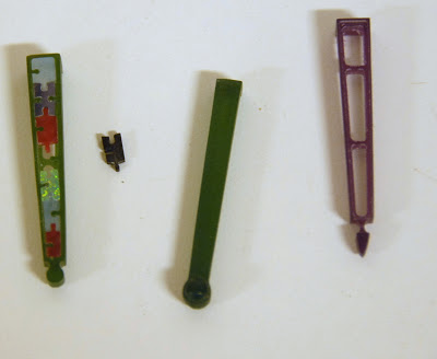

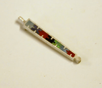

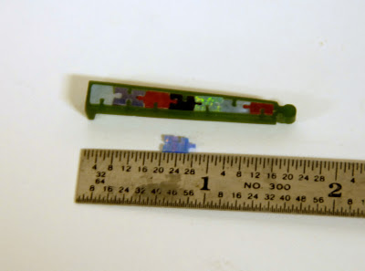

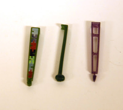

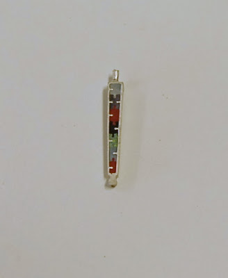

I have 3 wax clips I'm working on, I thought I would share them with you to show some of what is possible. I will let you know up front these I made with a cnc machine, the first picture shows a puzzle clip I'm developing, the green wax is a flat clip with a 5mm ball at the end and on the right a clip to inlay a larger piece into.
The puzzle clip has 7 seperate pieces inlaid into it. The widest is 4.5mm the smallest is 2.5mm wide. These are made up of pieces of left over pen blank material. Except for the 3rd piece which is synthetic opal. the third picture shows the scale and an extra piece of puzzle cut in opal. I will re cut all the pieces in opal before I'm finished.

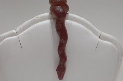

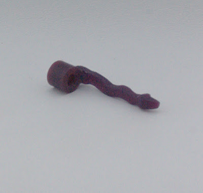

The next set of pictures are a revisit of a clip I made carving the wax, With Bruce's Permission I am reposting them.

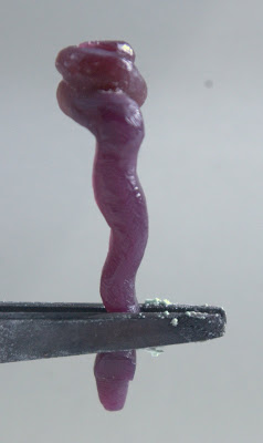

Image is of a clip I had made and cast previously and 2 pieces of wax that will make a larger model than the one that was cast already.
The snake has been roughed out with a file the cylinder will become the upper body that forms the finial.
Picture 2 shows the 2 pieces welded together. I use a wax pen which is a fancy name for a soldering iron with a rheostat.

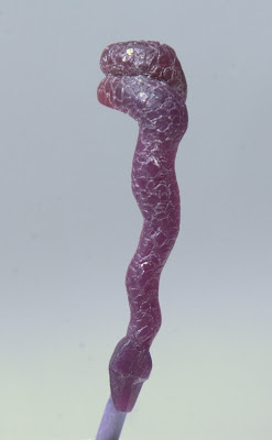

The third picture shows the rough carving of the snake, I have started to draw where I want the diamonds on the body.
Next we have the scales pattern scratched onto the body

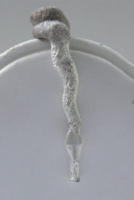

finally the finished carving ready to go to into the casting process and the cast snake prior to clean up.

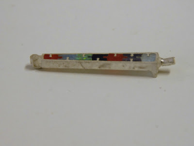

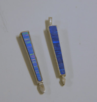

Here are the cast pieces.
I have washed off the investment but have not done any clean up of the metal yet. the pieces fit right in. The piece sticking out the top is the sprue. It is where the metal enters the cavity left by the wax. it will have to be cut off, filed and finished. the rest of the piece will get a light tumbling and then inspected to determine final finishing.
This last picture is of one of the other clips, the one on the right is the purple wax clip in the previous pictures.

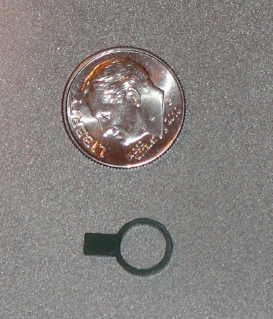

Is there a trick to making the ring for a clip? I'm having a bear of a time with it. the damn things keep breaking. about the only variable I have not tried is bring the wax inside and heating it up to 70 or so as the shop is around 60. I've tried working with 1/4" thick and 1/8", the pieces are just to brittle. The thicker is hard to get the round formed and the thinner too fragile. I'm taking a break from the wax before the frustration factor gets too high. the next thing I'm to try is to turn a piece to the OD then drill the tube size, slice off a piece, then melt a flat piece on to the side for the tab. Thinking back I should have tried this first. Anyway Just needed to vent a bit before going back out to the shop. thanks,

Here's a picture of what I currently use for most of my clips which I tend to hide in the cap. Thickness is about .080".

In the past, I cast 2 parts and soldered them together - now I use CA to combine or melt together if I feel courageous and cast as one piece.
The process you describe should work. Jewelers melt wax pieces together all the time. Some use a wax pen, some use an alcohol lamp to heat a metal tip, and I've even used a candle to heat a metal tip and touch it briefly to the wax. I would probably practice a bit before doing to real thing, but it will work.
If you get too frustrated and want one of mine to attach I'll be glad to make one. Or sketch the dimensions and I'll cut it on the CNC. And don't worry about the timing - I'll wait for you.

Thanks Bruce,
I've made a couple rings and sanded some flat pieces down to the same thickness. I'll try melting one together after practicing with some of the scrap I created today. If that does not work for me I'll go with the CA. I'll have to get some silver solder for attaching the ring to the back of the clip. I was pleased with how easy the wax was to drill even after turning it to the OD. Parting it of was a little trickier but out of four tries I got two good rings. I hope to get the clip pieces and a nib done tomorrow and if time allows maybe even a finial. This has been great fun, if a little frustrating at times learning to work with the wax. Please PM your address so I can send the parts your way.
