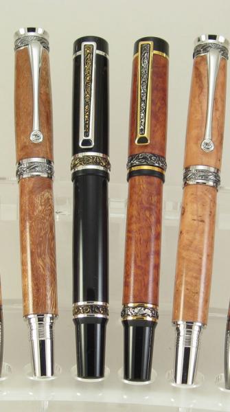

I just recently discovered that the Cambridge pen (center, right) is missing one of the gold trim rings at the centerband! :eek::mad:
I vaguely remember a customer at one of the craft shows grabbing it and attempting ... (no, not even attempting) ... SUCCESSFULLY pulling it apart like a snap cap! I thought I had gotten it away from him in time but apparently not before the ring went awol! :frown:
Just thought I would ask here before I try calling Berea. ... in case anyone has one in amongst their spare parts ?
Thanks!:beat-up:

I tried turning an ebony "ring" figuring it would look better than nothing and at least fill the space. But I'm not Butch! It kinda fit ok ... until I tried to press it on just a little more ... then Snap! :frown:
Maybe I'll give it another try sometime with an acrylic :)

Drill the blank to proper hole size then turn it to proper outside diameter and soak it good with thin CA , both inside and outside , then finish the outside and part off the slices with a thin parting tool , support the inside of the hole with a brass tube or piece of something supported by the tailstock as you part off the slices . This will support the thin walls and keep you from chasing the slices all over the shop . The CA soak will harden the wood enough to make it workable in thin slices and should keep it from breaking when you press it together .
