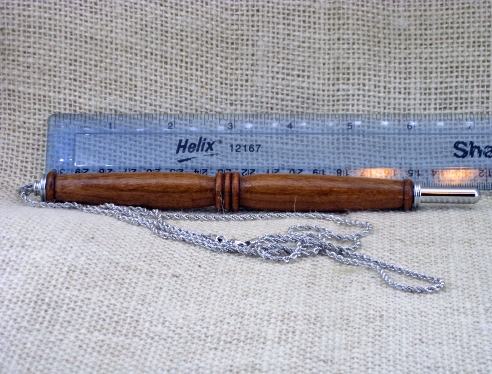

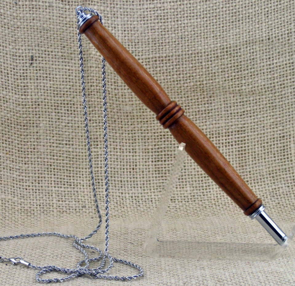

I had a customer request 2 seam ripper necklaces with 6 inch handles. The customer is always right, especially when they're a quick paying customer. This one is cherry with a large seam ripper head, the one I didn't get a picture of is walnut with a stiletto head. These are likely to be the longest ones I'll ever make. They were drilled from both ends toward the middle.

Very nice. I made a couple larger double ended seam rippers a couple of months ago for a customer that has arthritis. He (yes he) loved them.
The double ended ones I've started making 3/4 inch longer than stock. With the stock length the 2 ends sometimes interfere with each other in the closed position. Adding an extra 3/4 inch of length (including the tube) fixes that issue.
