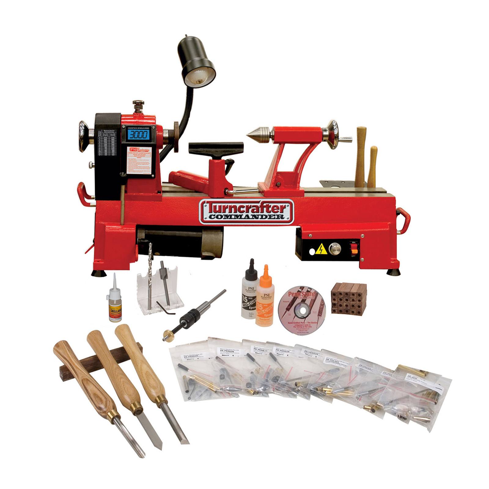

PennState Industries has these lathes, and they offer starter kits that come with a DVD on how to turn pens. I think you can benifit from this, as I did about 13 years ago.

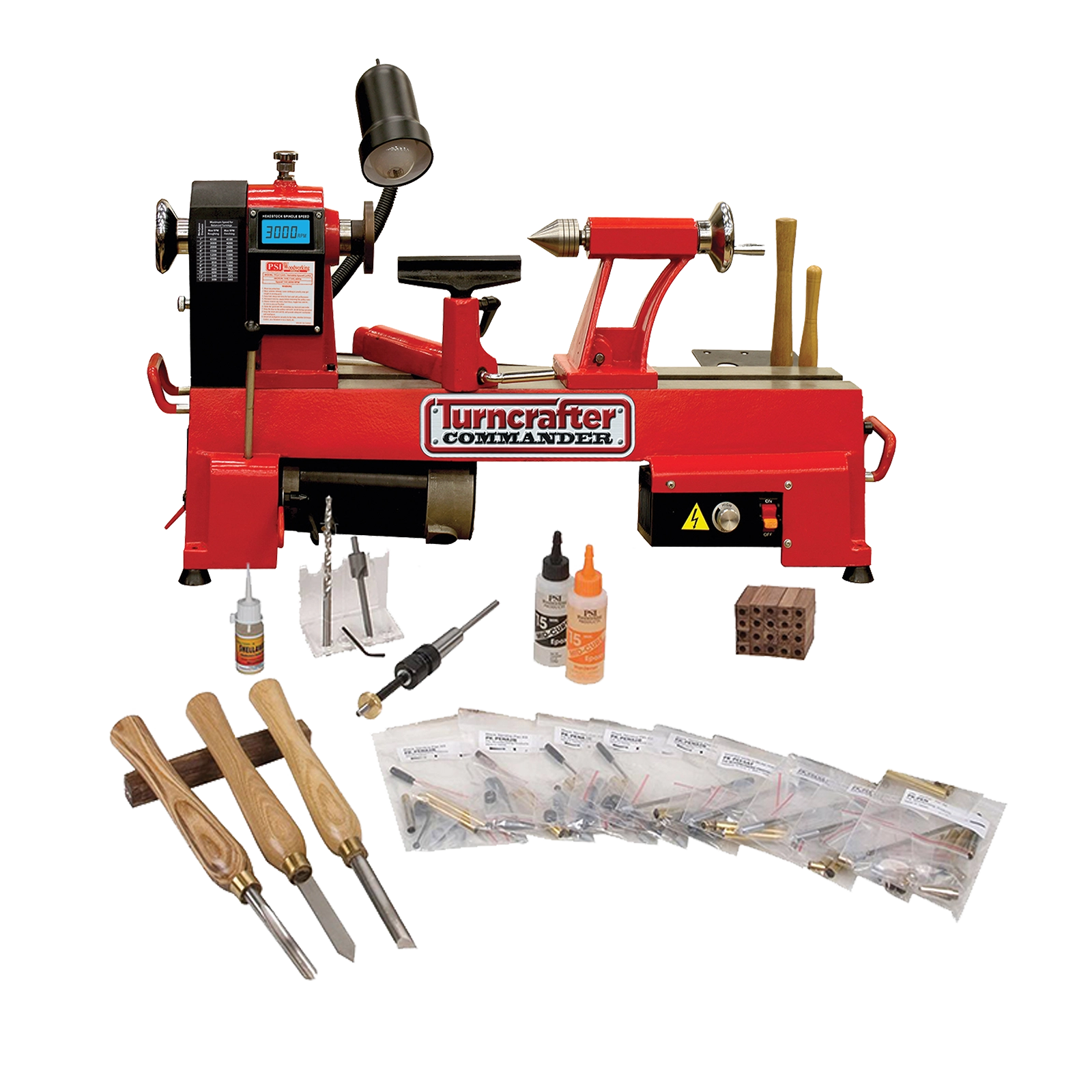

A friend /neighbor just got started. He bought a Turncrafter 10''VS. Seems to be a decent lathe and a tank. If you should be interested in a PSI TurnCrafter...you might be able to get 10% from the start. Simply sign up (email) and they tend to give 10 off. I have A Jet 1221 and 1015...but would be happy with a TurnCrafter. If you can handle a Jet you will not regret it. Whatever you do buy...please get VS (variable speed). Do your homework and buy right the first time. It is a wonderful hobby. The fun never gets old. It's more fun than can imagine at this point. The members here are great people and always offer constructive support. Safety first. Protect your face, eyes, ears, lungs.Use a dust collector...with a good filtration system. Welcome aboard.

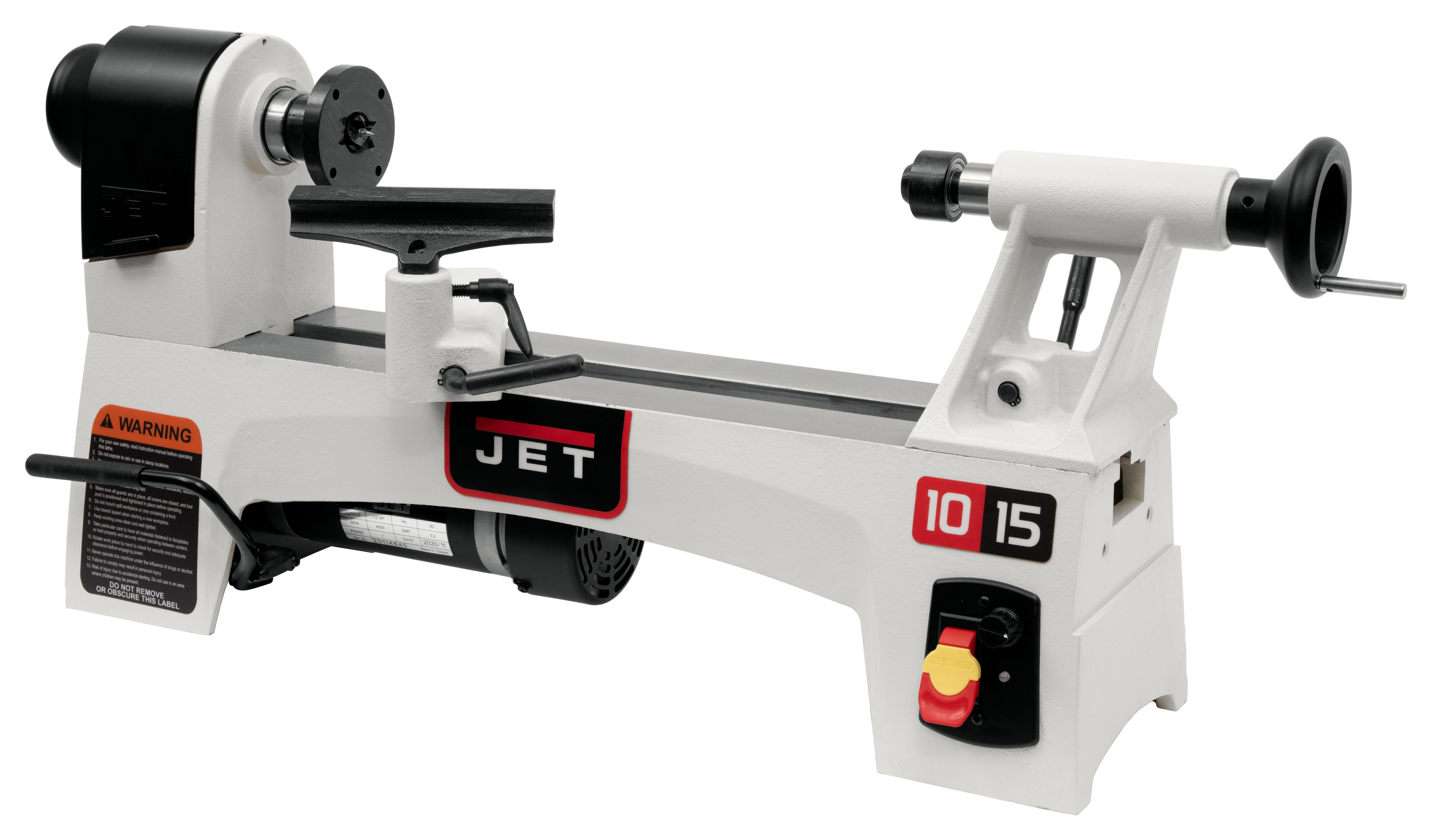

Look at the Jet 1015. It comes as either a belt changer $500 and with Variable Speed $600. Rikon and Turncrafter (penn State Industries) make similar size lathes And similar price range. In my opinion the Jet is the better quality of the 3 but is slightly more expensive. They will all do what you want and all have the features you need.
