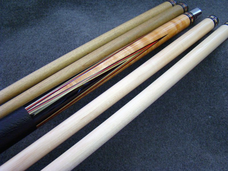

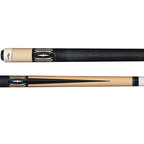

So I'm looking for a very specific type of segmented blank. I have a friend that is an avid pool player and his wife asked me to make a cue themed pen. I'm looking to replicate the points in the shaft of a cue. probably with maple and possibly Ebony or some other dark type wood. I would want to buy or trade for 2-3 blanks. If anyone would be interested please let me know. Nothing quite as fancy in the pictures but more like #2 wit the triangle point. keeping it to 2 woods or 2 woods with an accent of some type would be plenty. My segmenting is just not up par so I feel purchasing or trading for the blanks will net me better results.

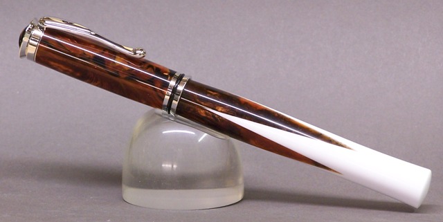

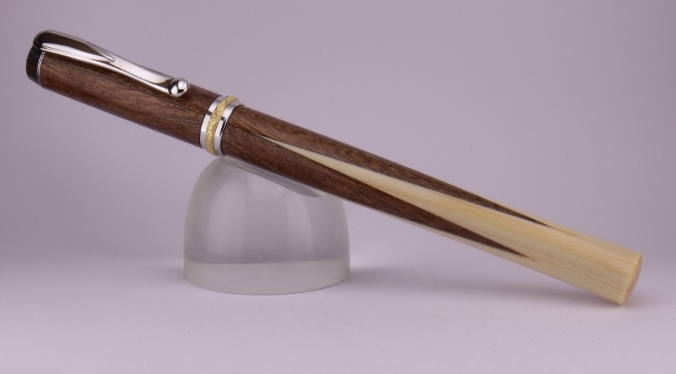

Adrian, I know you said you would prefer to buy, but it really is fairly easy to make sharp pointed ( both ends ) cue blanks with a router, a basic box jig and using your lathe ( Metal or wood lathe ) just for the indexing. Making the additional pin striping would mean just carefully moving the jig after each insert. Just to cut again on top of the previous one.
Here's a couple I have done and two links to some of the methods I use to use to make them. Don't be put off by the metal lathe set up, remember it's just the edge of the jig that the router guide ring follows and the indexing of the work piece that is important.:wink:
Pool Cue blanks 1
Pool Cue Blanks 2

Wow Skip your stuff never ceases to amaze. And conceptually that's pretty much what I was thinking. Except I thought on a smaller scale I'd only be able to get 2 points so it's nice to see that's someone's already executed this with great results. I browsed the linked threads and maybe I missed it but at what angle do you set the ramp at? I believe this is the method I'd have to use.

SSGMEADER I posted to you on your Wanted link and a pic. The guy who makes them is in Colorado Springs, CO: Gisi
The angle he uses is 3 degrees. I want to take his class but the last one was cancelled because no one signed up. A real shame. He works at the woodcraft in Colorado Springs.
