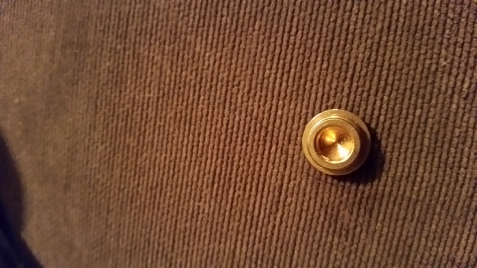

im looking for a brass tube that a 3/8 inch brass wood plug will snap into( pressure fit)
I measured the diameter of the plug....its 0.397
I figured out how to change my calipers to mm.....and the best measurement I can get is 10.12 mm, so the inner diameter of the tube would have to be 10.12 or close
You will need the inner diameter to be just a little smaller than 0.397" or 10.1mm so it will press in with a snug fit.
Inside diameter of the tubes is essentially equal the outer dimension of the bushings, so I think one of the 3 that I listed earlier might work. The best way to check will be to measure the parts that come with those kits for pressing into the tube & see which one has parts closest to your plug.
I checked a few kits this weekend and it looks like the pressed parts generally run about 5 to 7 thousandths larger than the ID of the tubes, so I'm guessing that an 11 mm tube with a 0.389 ID will probably work ok for your part. It's certainly going to be the closest one to what you will need that you can find in any pen kits.
