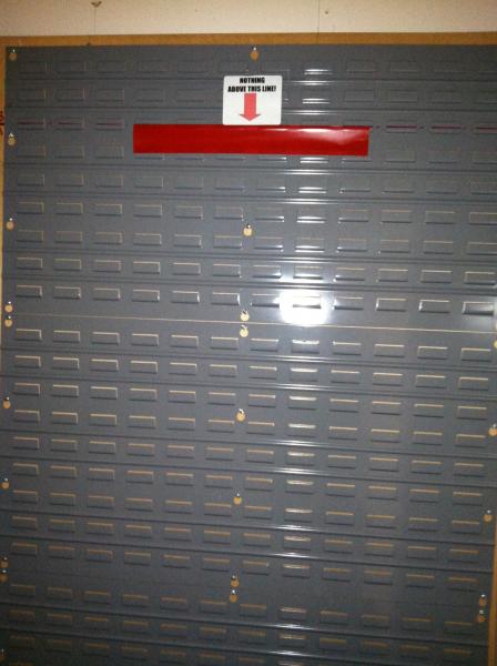

Looking for this type of shevling
navycop
Nov 4, 2010
2,333
Virginia Beach, VA 23454
They have this type of shevling at work. It holds the yellow, blue, type bins that hook onto it.
If you would like to make your own hangers for the bins. I have in the past used the aluminum carpet to floor threshold strip comes in 24",36"up to 8' strips at the big box stores. you turn it so the angled side end, is facing out from the wall and up then you can mix and match the assorted sized bins on the strip. If you want them stacked you can just, mount them the correct distance apart for the bin size. Don't forget to leave some room for reaching in to get stuff.
You also can swing by your local sheet metal shop, and have them bend some up.
Satin Brass Fluted 72 in. x 1-3/8 in. Carpet Trim-79152 at The Home Depot Here's what it looks like!
It also comes in natural aluminum, If you are having bent up make sure they have the leading edge, that will hold the bins folded over so it is double thickness. That way you can use galvanized sheet metal, cheaper then the aluminum sheet.
