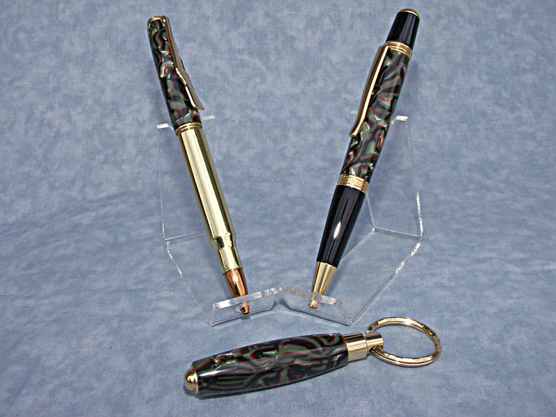

Why not buy the kits? Cut the tube to size needed. These are all real bullets, kits. You drill top of shell. Not sure if they still sell the basic key chain kits any more. that is what these were.

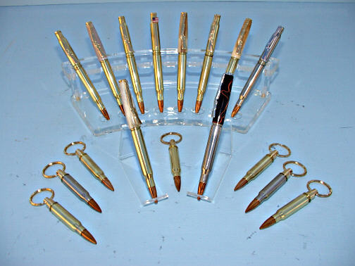

All I need is the top piece that the ring goes into. I do not use a tube at all. I press the bullet into the bottom as pictured. I just think there is a place to buy just that piece. I drill a hole in the primer end just big enough to glue it into the casing. Thanks guys.
