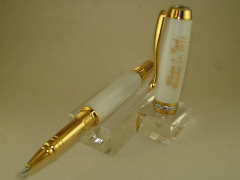

What about just tapering the ends of the blank to the bushing size but leave the mid body straight. Like I did on this one. It keeps the straight appearance but leaves some meat in the bone. (Figure of speech)
Thanks for the pic....I think this is what I will try.

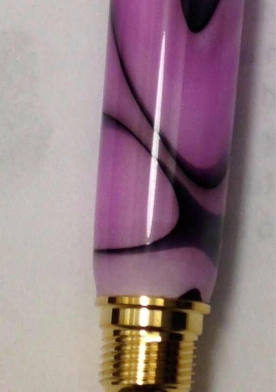

I agree with parklandturner. Just had Woodturningz do the engraving on this Triton. And I believe both the Triton and Jr. Statesman use the same bushings and diameter tubes. Hope this helps,
