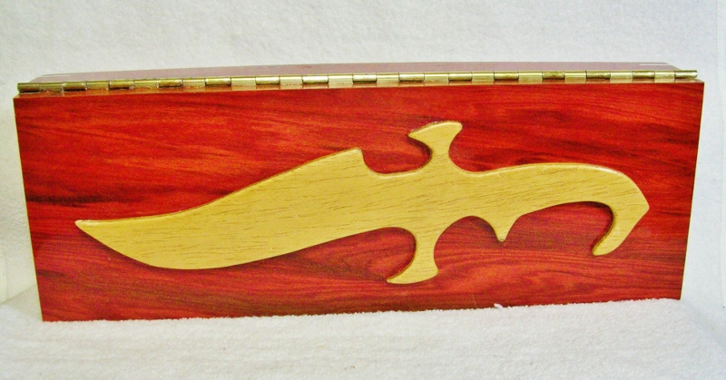

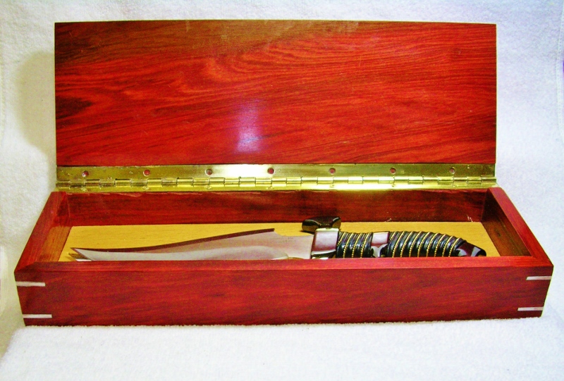

This is what true Bloodwood should look like. I have had these pieces for about 15 years and they have never darkened. I used a spray on clear lacquer made for furniture purchased from my local Fleet Farm. As John T said, there are a lot of woods out there being called Bloodwood. Go to a good exotic wood dealer, such a Griffin Exotic Woods, if you want the real deal. He will show you photos of the actual wood you are going to receive. Jim S
