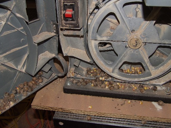

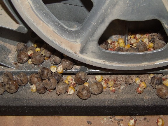

I also have a little Ryobi 9" band saw that I don't use much anymore.... I used for cutting pen blanks and then just relegated it to cutting plastic and antler before I stopped doing pens... last time I got it out, a squirrel or packrat was using it as a cache for their winter harvest.
