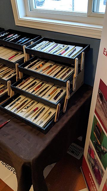

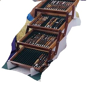

So this weekend I had my first show, and I was a bit overwhelmed with setting up. so I decided I am going to make some boxes to display my warez, and just have them pop up.
Looking around the web, I think I found something I am going to clone. or make very close too (see attached image)
I am wondering if anyone has any suggestions or recommendations or maybe even Early warning about similar idea's.
I am looking for best practices, ideas, recommended wood types ...
any input, plans, advise, constructive criticism is more then welcome

Use the thinnest wood you can stand to work with - you won't believe heavy these get after they are loaded with ~100 pens.
When I made something similar (but not as nice) I routed out my own trays and lined them with felt. If I ever do it again, I will use commercial trays, which I believe are moulded paperboard and already felted/flocked. Again much lighter. Here

I have been researching doing it in Baltic plywood (6mm) which is about 1/4"

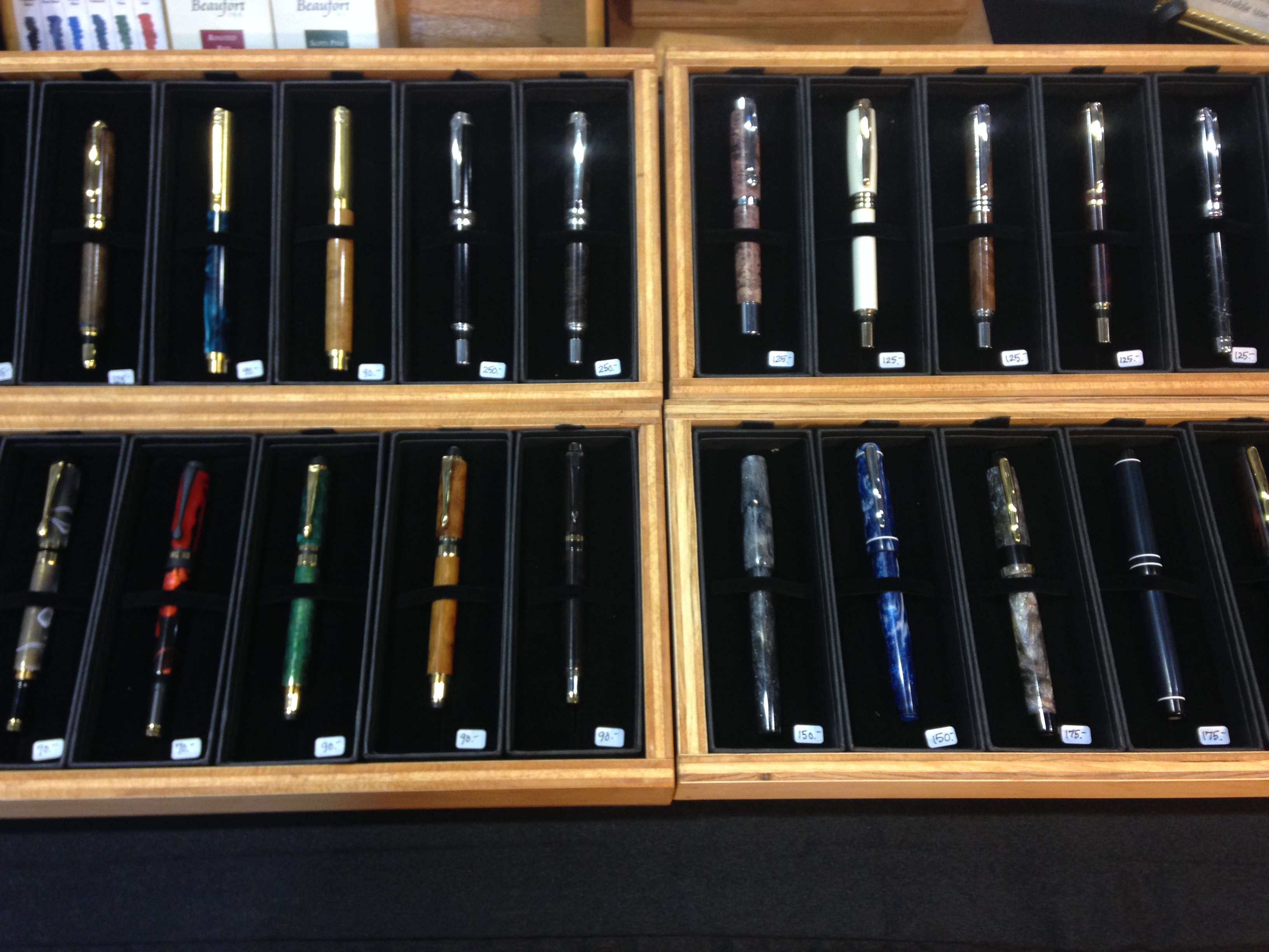

I built trays that fit into a carrying case. Birch plywood stained - not fancy, but indestructible and easy to set up in a hurry. I built them to hold my pen boxes so I didn't have to line them. I set the back of one on top of the front of the one behind it for a little slant and depth. Built two racks so far and am prepping a third one...

I definitely like the picture and the idea
I may do something like this for the higher end pens. at this point I dont want to include boxes in the pen as it will raise the price and even the spacing is smarter for better quality stuff.
I also like that there is room to display a price and maybe tidbits of info while not over crowding the pen.

so here are my new stands. though I have tweaked them again since thiis picture.
if you look at the 4 hinges, I decided to instead of the middle 2 being 4 peices, I made them 1 solid pieces each.
I didnt like the velvet inserts they made everything loose in the box.

Pertaining to the construction of that specific box - I think it would be attractive if you miter together a 5-6 inch tall box and rip that into the four or so layers displayed, each ~1.25 inches tall. Simply to preserve grain flow and minimize the number of joints to be glued.
On a mechanical side, the way those layers hinge together and are displayed on an incline, you may want to take caution in how loose the hinges are/how elevated that incline is. I can see an upper layer pivoting harshly onto a lower layer if the hinges are near vertical. I've admittedly never built something like this though... so I'm being speculative.
Best of luck!
