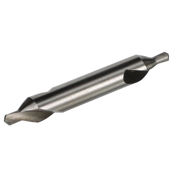

Who can explane what is no 13 a pilot bit. I have tried google to search on pictures. But that dit not give me a proper explanation.
I use a #2 center drill.
