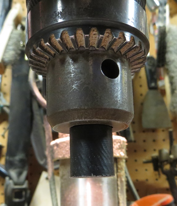

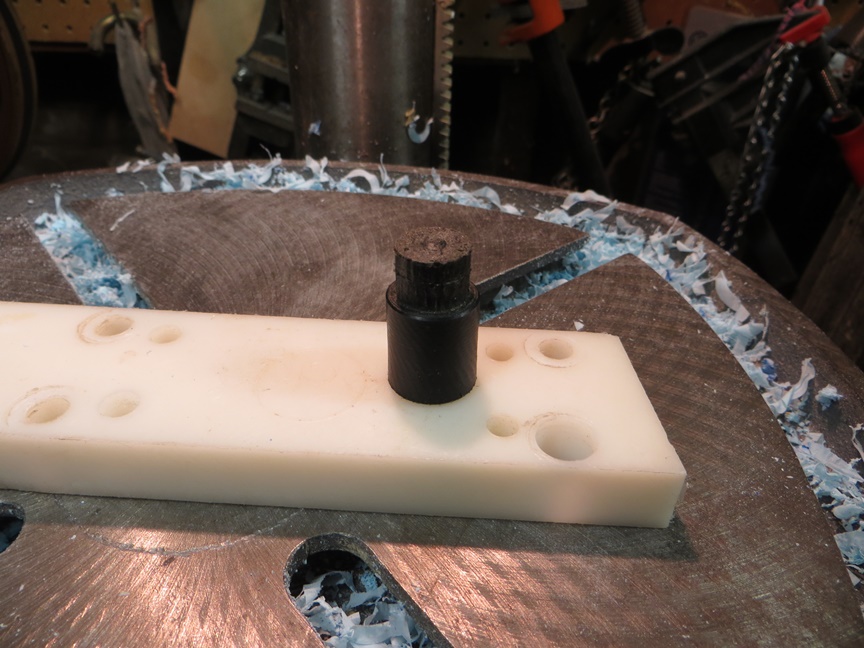

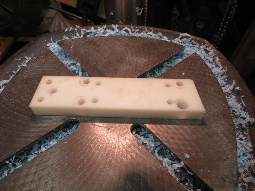

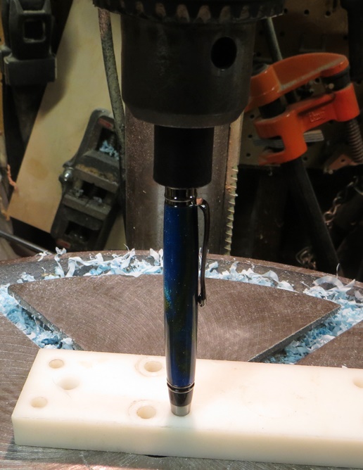

I've been using my drill press since I started turning pens. Hasn't let me down.

6) Drill press: My current method, very fast, easy to control and hold. Put a scrap of wood down to protect the metal on metal contact.

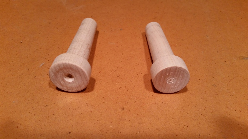

I too bought into the "$40 pen press is required" idea but have since come to my better idea.

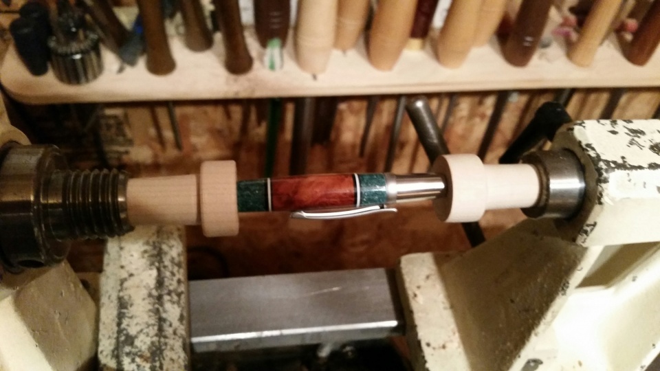

This will take you 15 minutes, cost $.10 and is pretty much fool proof. You have a lathe so make these from some scrap maple, put them in the head and tail stock morse tapers and crank the pen together. Easy peasy.
WB

I just turned two pieces of wood to a rough Morse taper with a wider end. Inset an offcut from an acrylic blank into that with the centre dished out and have never had any trouble. It is much more controllable than a pen press and the dished end make it somewhat self centring. You have to be careful with the alignment though. If you are not you will have the same problem with a pen press.
