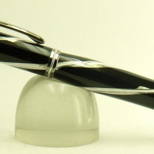

I'm hoping someone here remembers this pen and can lead me to the photos or post of it. I have seen this a couple of times, and want to try making the design myself, but can't seem to find it now that I need it (a familiar dilemma).
It was done in stark black and white (ebony and synthetic ivory or something similar). It looked like the blank was segmented on a diagonal, then cut into 4 sections and each turned 90° or something like that. I think the pattern was duplicated on the top and bottom sections of the pen. I could swear it was a Skiprat design, but a search of this site and his turned up nothing.
Does this ring a bell with anyone? Any idea who did it, or where a photo of it may be? Any help would be much appreciated.
RKB

This?
I'll admit that I am having a hard time understanding your description.
It is tough to describe. Think of doing a normal miter cut on a blank, so that say the top is black and the bottom is white with a 45° cut separating the two. Then cut it lengthwise into 4 parts. Then rotate each of the ~1/4" x 1/4" x 5-1/4" sticks and reglue them back together to form a blank. I hope that helps.
I think there may have been more to it than that which is why I want to find the photo.
Sorry but you did not read all the replys and click all the links.:)
So once again is this the one you are looking for? Also check out my reply #6 in this thread.
https://www.penturners.org/threads/a-segmented-panache-pen.172089/
That's it! Thanks. And I apologize for attributing this to another pan maker.
Mine won't be quite as intricate as this, but I really liked the idea.
I was on the right track with the cuts, but the curves after turning threw me. Mine is maple and black walnut, and will be used for a Diamond Knurl kit. I'll post pics when it's finished.
Thanks again.
