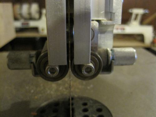

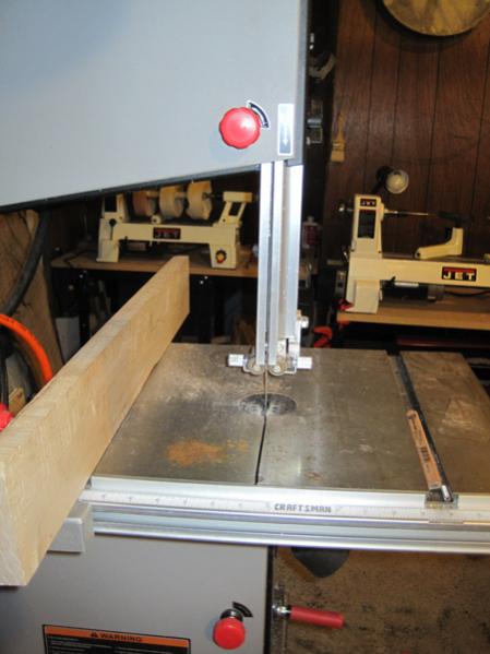

Here are a couple of pictures. is this what I have to fix? I am now in a whole new world I know nothing about. I know I love my saw but lately its not doing what I want. LOL
Well I'm not sure everything is stock here and I am noticeing that the bland is turning and bending a lot now... It didn't see to do this when I got it a few years ago.
