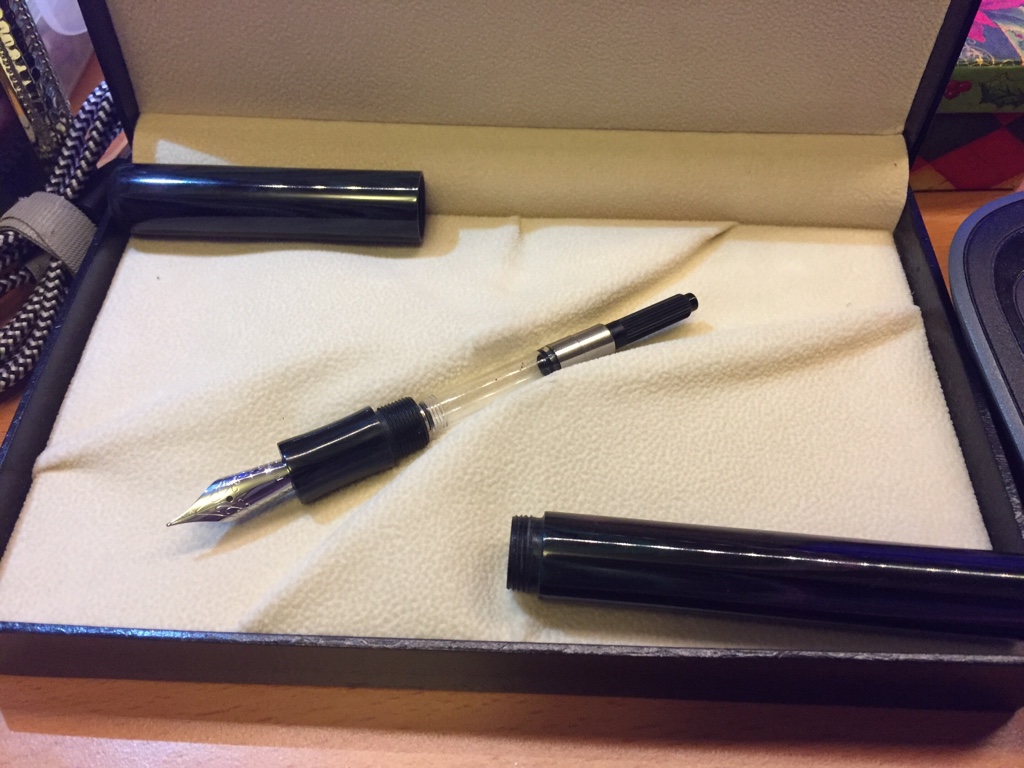

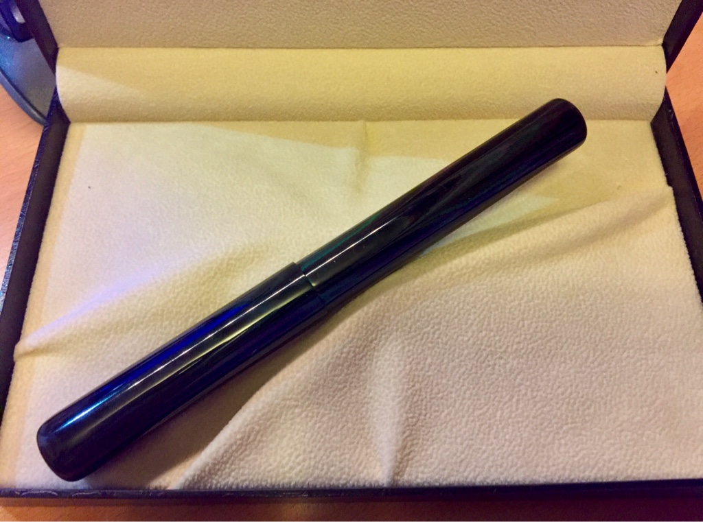

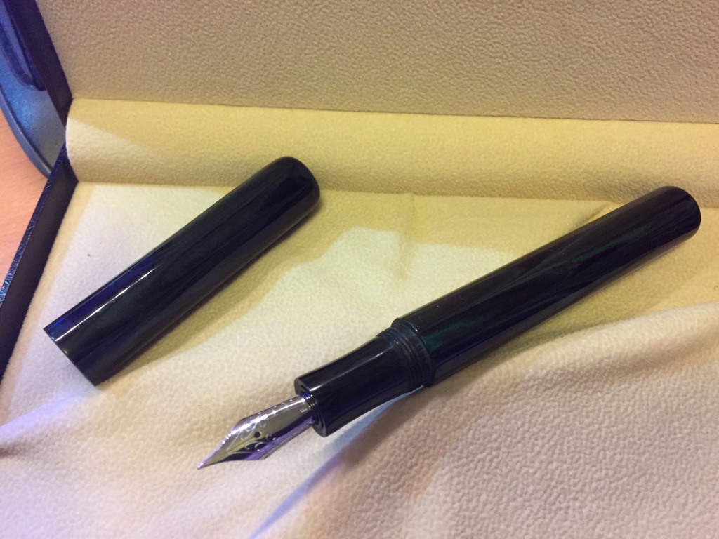

My first pen is all black ebonite with a green and purple swirl. Ebonite is forgiving when tapping and threading. It polishes well and I liked how it came out. It has a #6 Jowo nib.

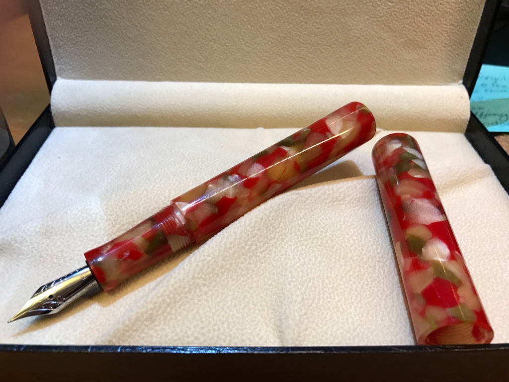

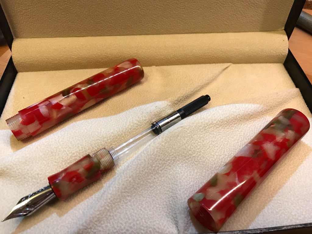

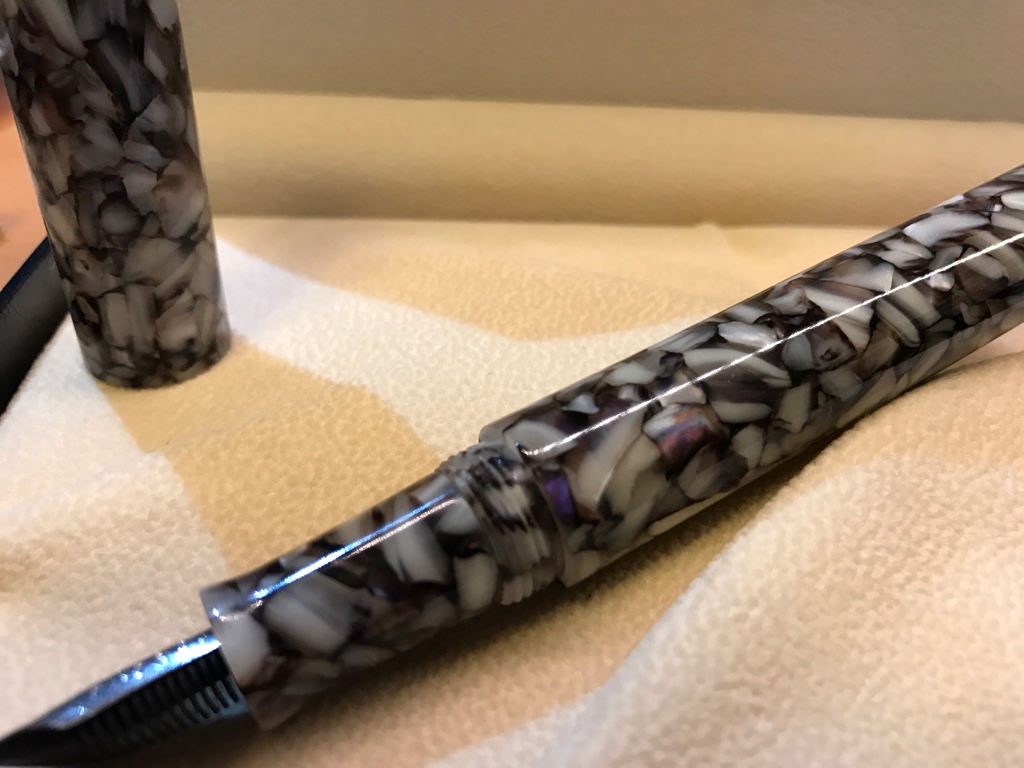

The next few are all acrylic acetate rod. They are slightly harder to thread compared to ebonite but not as hard as poly resin. I am working on reducing my impulsive need to complete these pens from start to finish in the same day. I want to see how they turn out. Stopping the lathe to continue tomorrow gets hard.

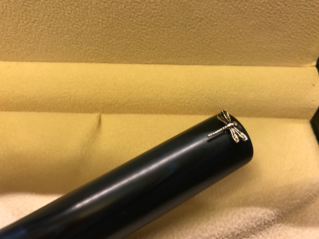

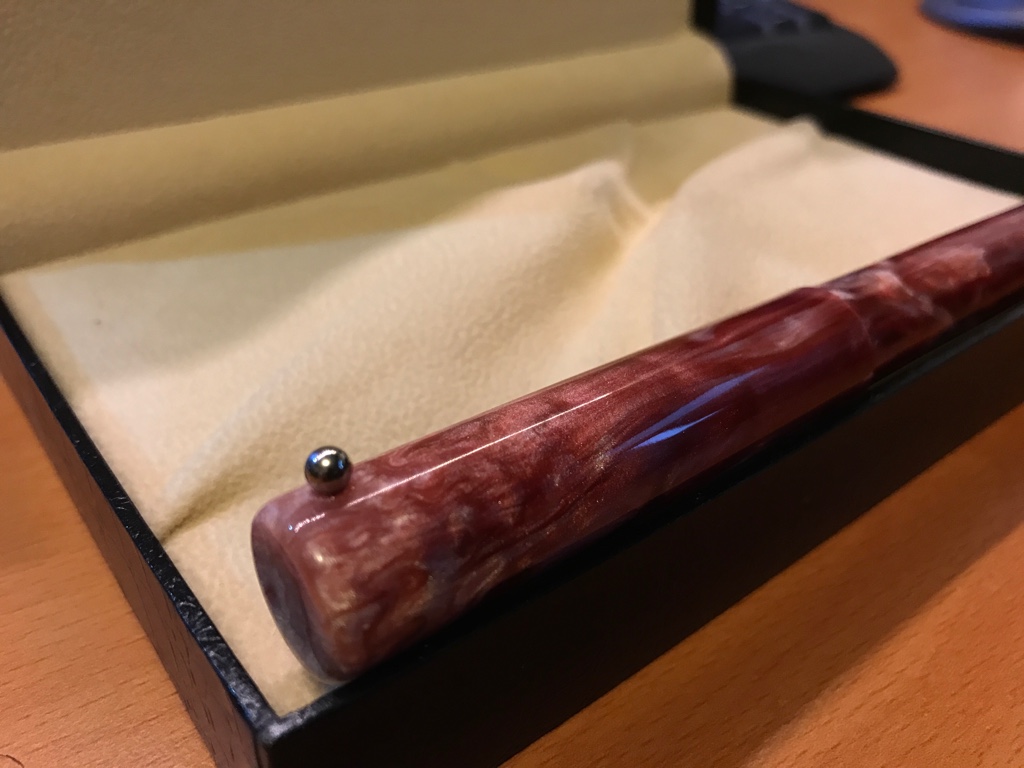

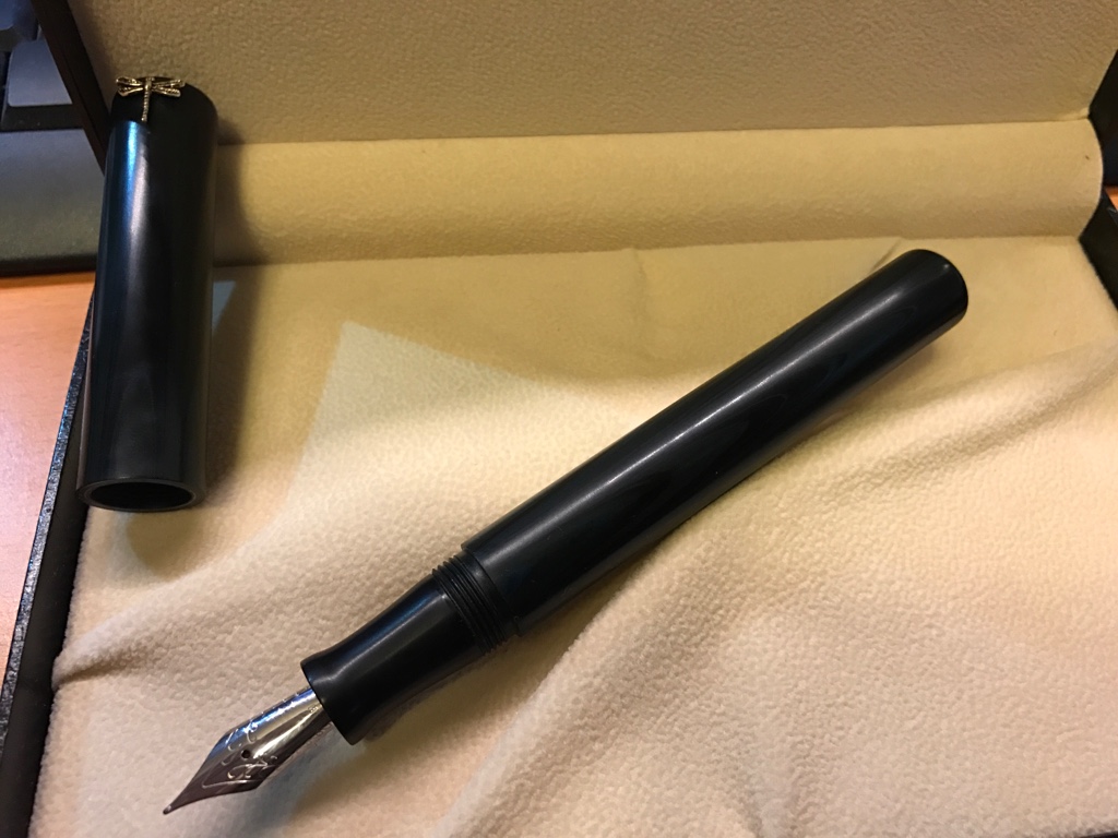

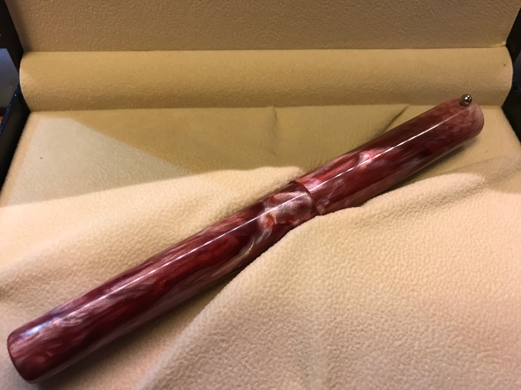

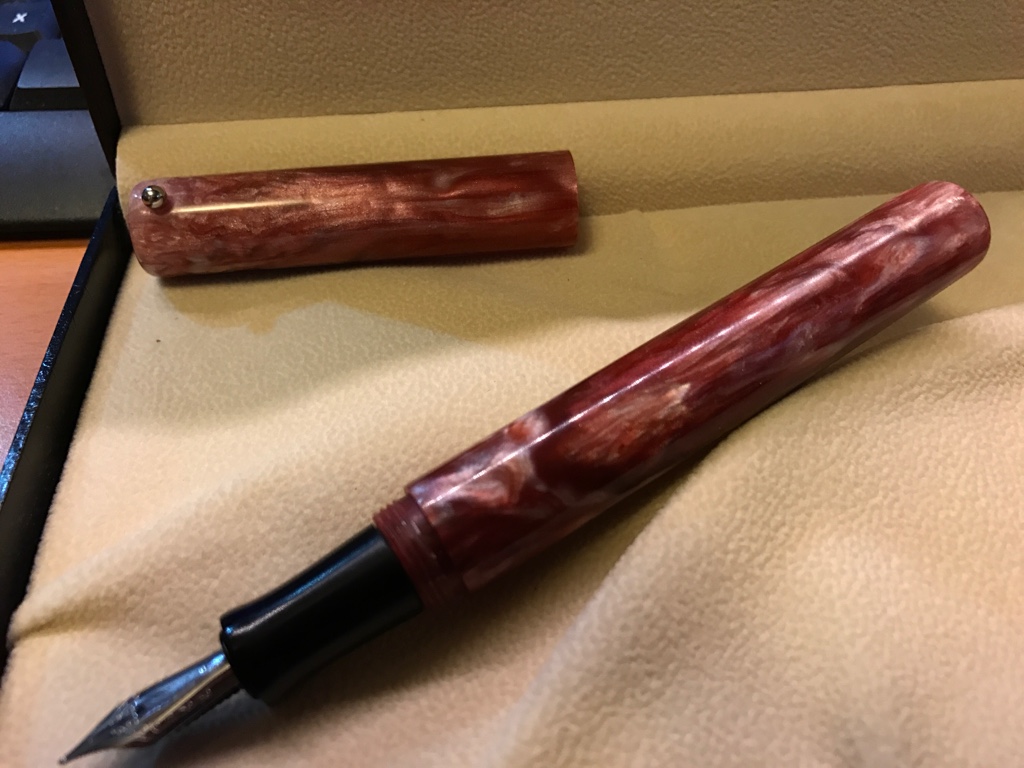

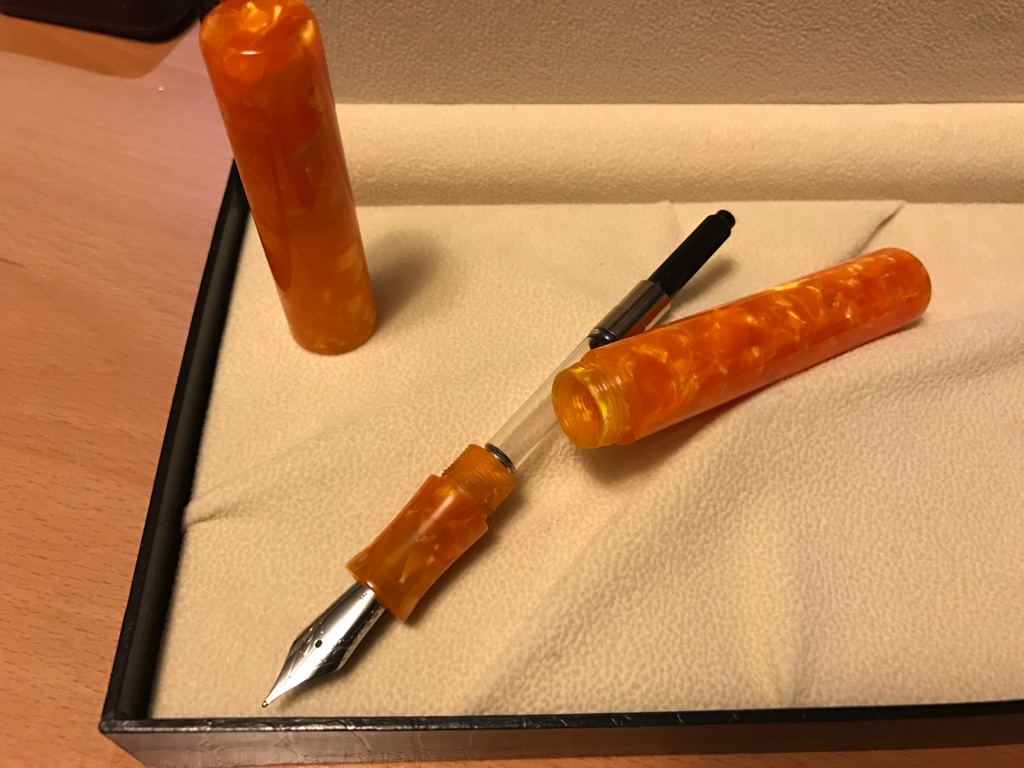

I started experimenting with casting and with roll stops. The red one is poly resin. I was surprised to find it didn't have air bubbles. The roll stop here is a sterling stud earring. I drilled for the post and CA glued it in. The dragon fly worked the same way. These are inexpensive and amazingly variable in style. I plan on getting more at flea markets this summer.
Mike Marroquin

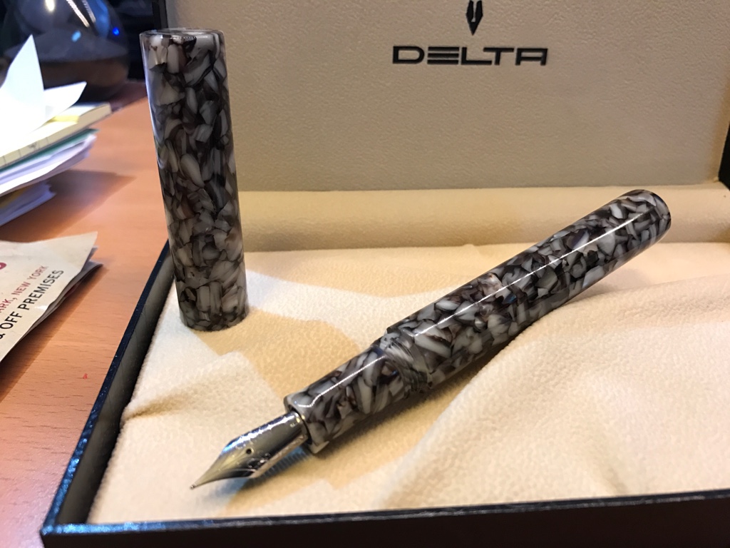

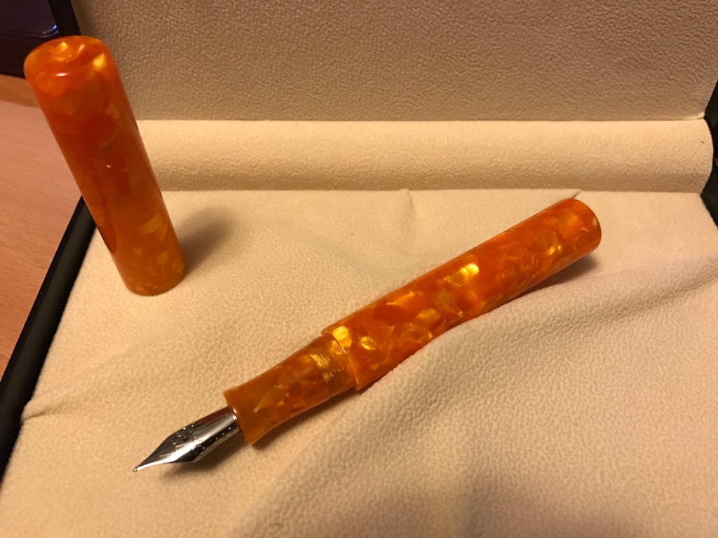

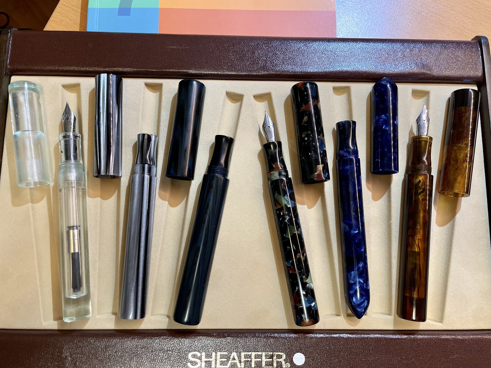

That is just the tray.
on the right the left most and middle were from exotic blanks. And the right was a tortoise shell rod I got a while ago. I don't remember the source.
Excellent, but they look like Sheaffer's to me, or is that just the box?
Can you recall what the 3 blanks on the right of the photo are?
