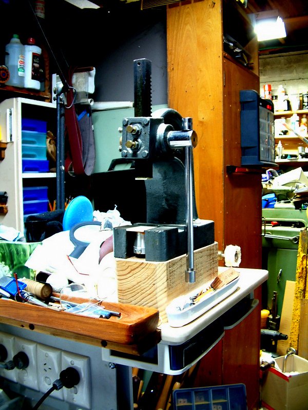

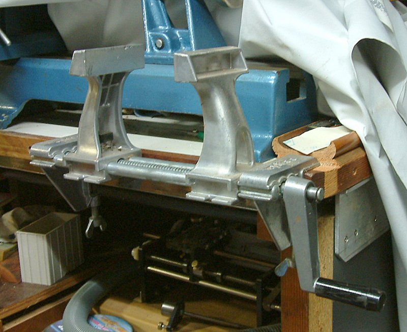

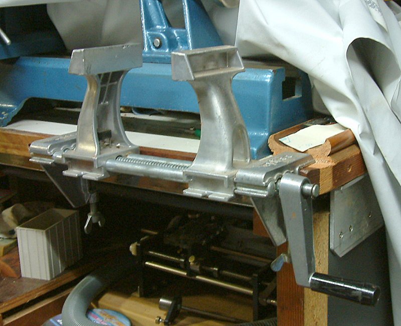

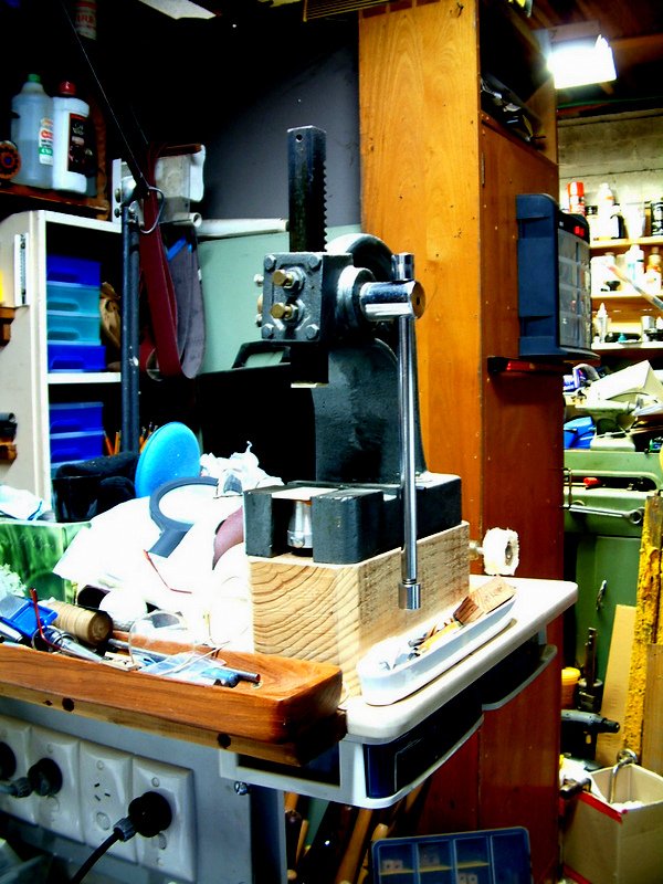

I use two the first is a bearing press,thin Corian on the the base and stem. Since I sit to turn on a swivel chair I finish the pen, swivel and press. For longer pens I use the Xylis.
Peter, the first pict is just like the Harbor Freight ones here. I have that and like its versatility. But I sure would like to have a Xylis. I have bid on a couple on eBay a couple of times but got out bid both times.
