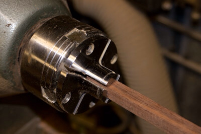

Both are common turning tools and worth having.
Scroll chuck
Collet chuck
Scroll chucks can take different jaws and are used for bowls and stuff as well. Jaws have a range and can grab anything in that range.
A collet chuck is more precise and you have to have a separate collet for each size you want and the sizes are much more exact.
